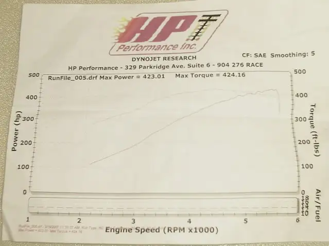

Below is a pic (crappy I know ) of my dyno sheet after the tune. I had a stock long block with Eddy perf. intake and Heddmen headers. Stock 3.33" pulley and AFM Power pipe. Not sure about the boost along the curves, but it maxed out at 13 PSI
I am very proud of that dyno sheet and I was very proud of my car. I got compliments on the sound of that blower everywhere I went.

You Bet Your Bottom Dollar You Got Something To Be Proud About :Word:
You know Mark ... I've told quite a few peeps about your combo :D
Just cram the mix in there and you got over 400 ... tq AND hp :banana:
That is alot of boost for a stocker OEM short block :crazy:
At boost levels that high ... I wonder how long one could keep going
before problems became known :shrug:
I mean ... It that too much boost for an application somewhere in between
say a daily driver and a weekend toy :scratch:
