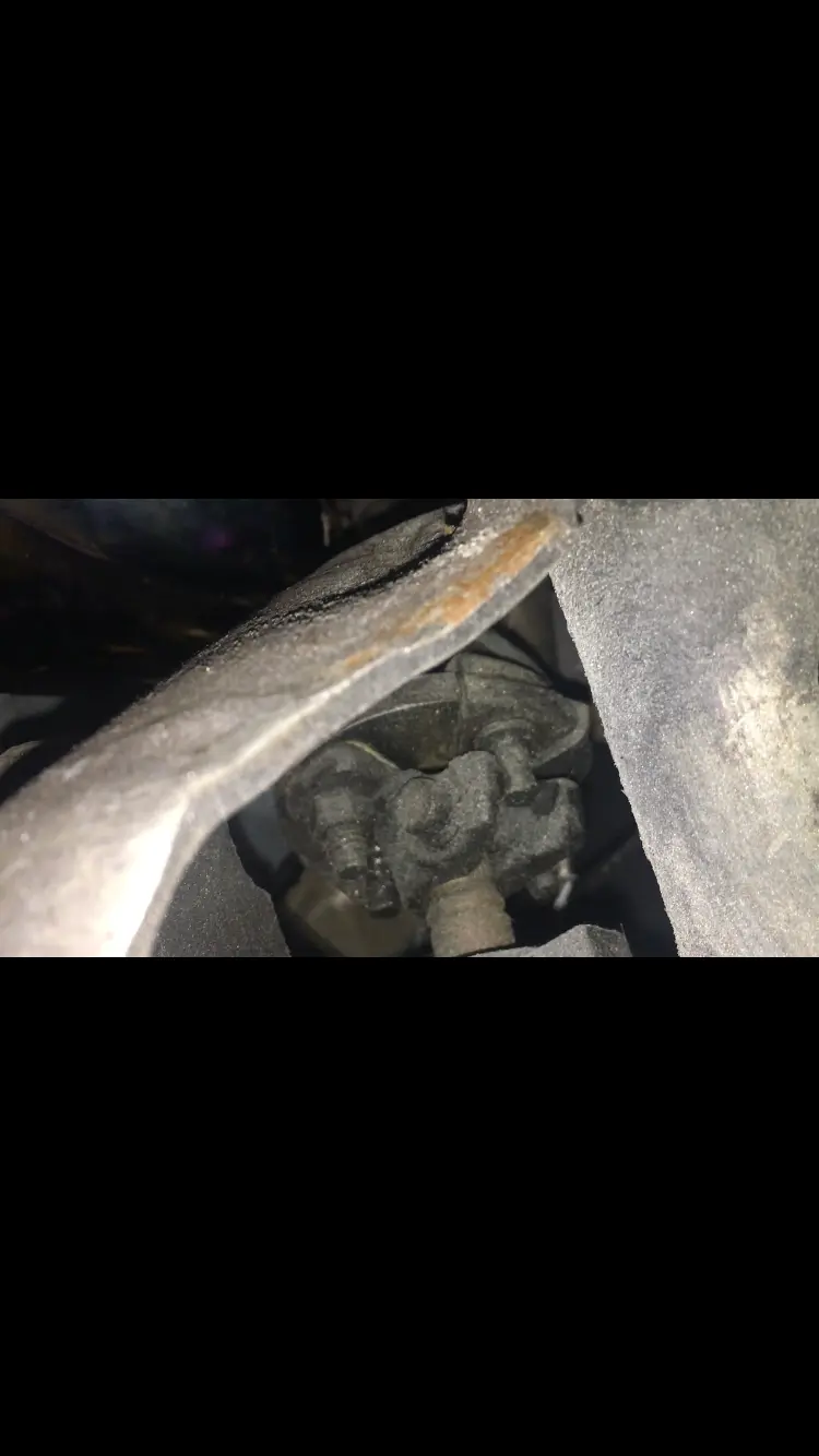

The rag joint looked ok in the picture. You have a tilt column right? Wasn't there an issue with that?

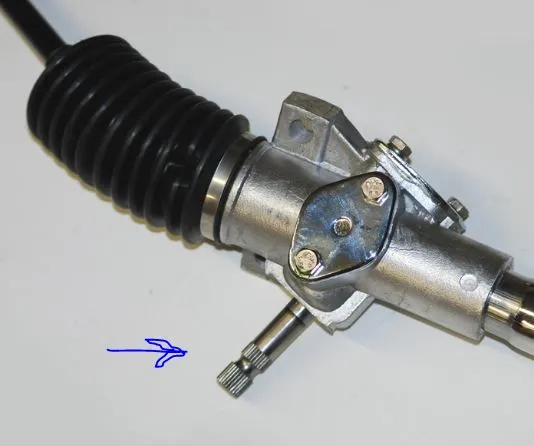

Concerning your steering issue i'm assuming the car tracks fine so most likely they shop had to disconnect your steering shaft from the steering rack to install that driver side equal length header of yours. They most likely reconnected it a tooth off as it's splined. You would need to loosen the bolt and enjoy the pleasures of backing that bis off the pinon and turn the wheel to the correct position then tap it back down onto the splines and tighten bolt... but I would just take it back to the shop who did the header install and explain the issue and that it wasn't an issue until the header was installed. They should take care of it if they are a reputable shop

If it's possible it skipped a spline the locking bolt would need to be loose and even at that point I don't think it's possible but their have been stranger things to happen. Eitherway you are going to have to clean that shaft and both sides of it and inspect the area. See if the locking bolt is loose or not in and make sure the steering shaft is fully seated on to the steering rack spline area. Rule that whole scenario out then move on to next possibility is what I would do.

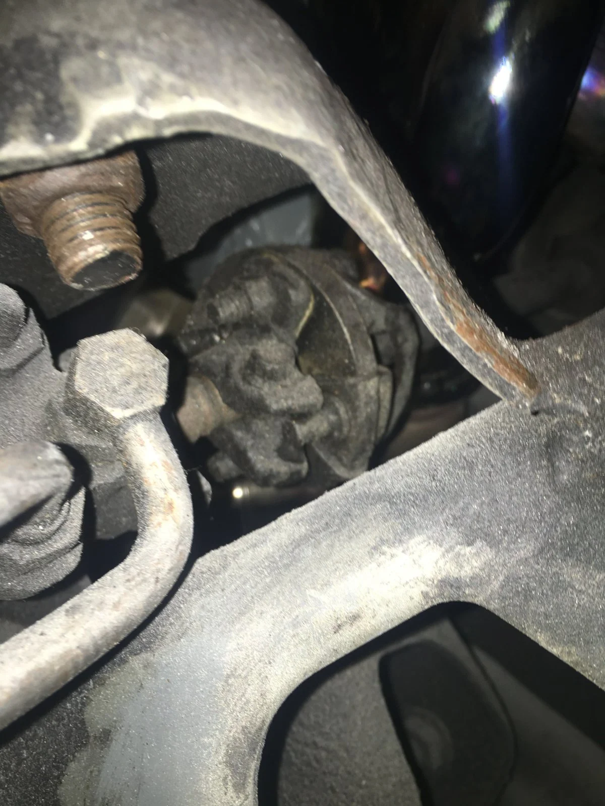

I was too tired after work to really get into cleaning things up, but I did manage to get a couple more pictures of the rag joint. I freely admit I have no idea what’s typical for these, but it looks like it might be twisted or spaced out or something.

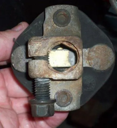

I’ll have to do that tomorrow, I’ve kind of locked everything up for the night. Assuming the rag joint is the problem, would it make sense to upgrade to a u-joint steering shaft at this point, or would it be better to just rebuilt the joint and leave it for now? I know the rebuild is cheaper, but if I’m going to have to take everything out anyway, I might as well upgrade stuff as it breaks, right?
It looks completely normal to me.
That could be a ct but yours is pretty good too!!
Now that you have those pretty headers in there of course something goes bad, hard to see from a pic. I can't reach down there and grab the steering shaft to move it around, of course remember to unlock the steering wheel!
If it is the rag joint I would consider swapping to a u joint type, unless welding is involved, the only welding experience I have is on wood and that did NOT go well.
