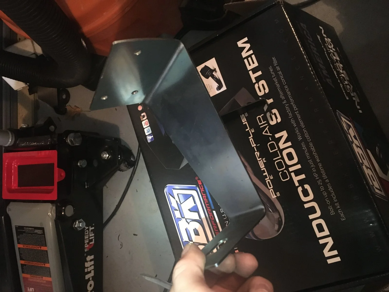

I also managed to get my cold air intake installed, and I think it does more for the sound than the headers do. My problem with that is that the set came with two brackets and I have no idea where they go or what they connect to.
The black one came with the mass air flow adapter, and the the silver one came with the intake kit itself. The instructions say that the silver one is the new MAF bracket, so I imagine the black one connects to the adapter in such a way to allow it to connect to it? Or maybe it replaces it altogether since I don’t have mass air?

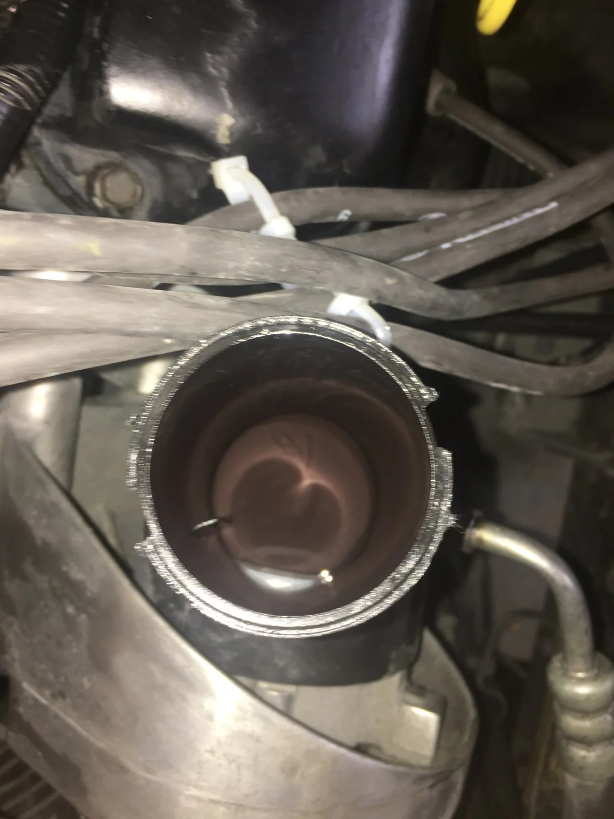

Well, I fixed the temp gauge with a new sensor, so there’s good news there. As for the steering problem, I had someone jiggle the wheel a little bit and it didn’t look like there was any play to me. I tried to get a picture of the joint itself.

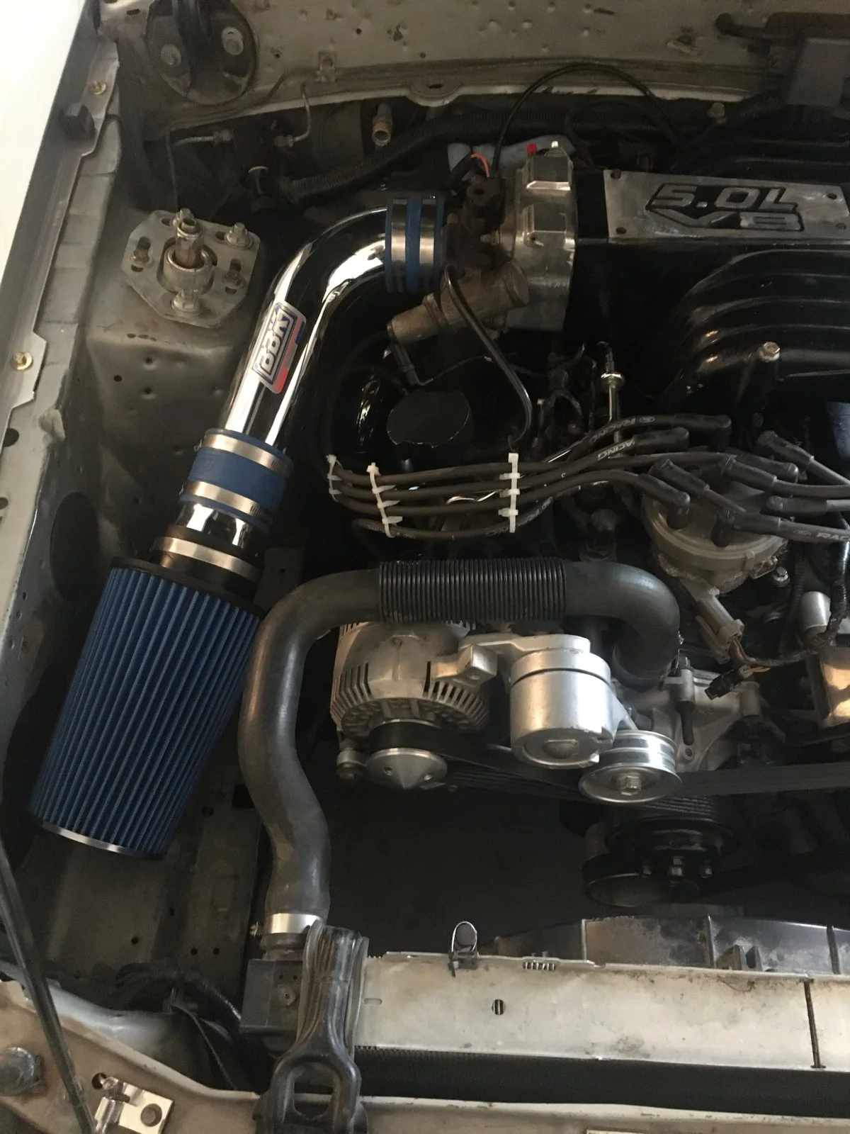

the intake is installed, my only problem is it kind of flops around a lot and I thought the brackets were supposed to prevent that. If I don’t need them, then I guess it’s fine.
I thought you got the fender well mounted intake. I’ve never used that air intake. You might need that bracket then. :shrug:
Ok,you've got several issues going on here. First,you'll get alot of flack for running that open air filter. It can cause idle issues,and you're definitely gonna need a bracket. Secondly,on your steering issue. I'm wondering if the rag joint isn't contacting a header tube? That would indicate your motor mounts are sacked. And you're gonna hate those headers come time to change plugs.

I also put the stock air intake back on for now. It probably is the rag joint and I just can't see the damage.

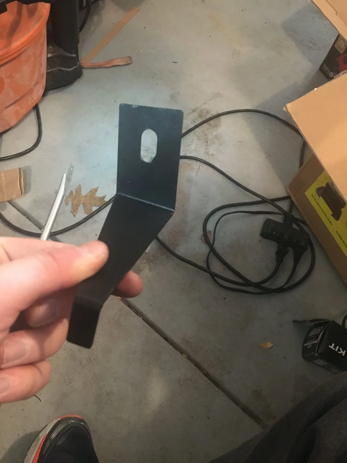

The second bracket is what you'll use for now. The first bracket is what you'll switch to should you decide to convert to mass air.
To use that bracket, the little "tab" without a hole in it will be tucked between one of the hose clamps and the silicone coupler (or the flange of the air filter itself) and the end with the hole in it will bolt to an existing hole in the car. I ran a similar setup on my '87 GT many years ago.

That's what I figured. I couldn't get it to work right, but I'll probably play a little more with it later. I know it does virtually nothing from a horsepower standpoint, but it sounds and looks great. I think I'll have to bend the tab a little bit to get it to fit.
