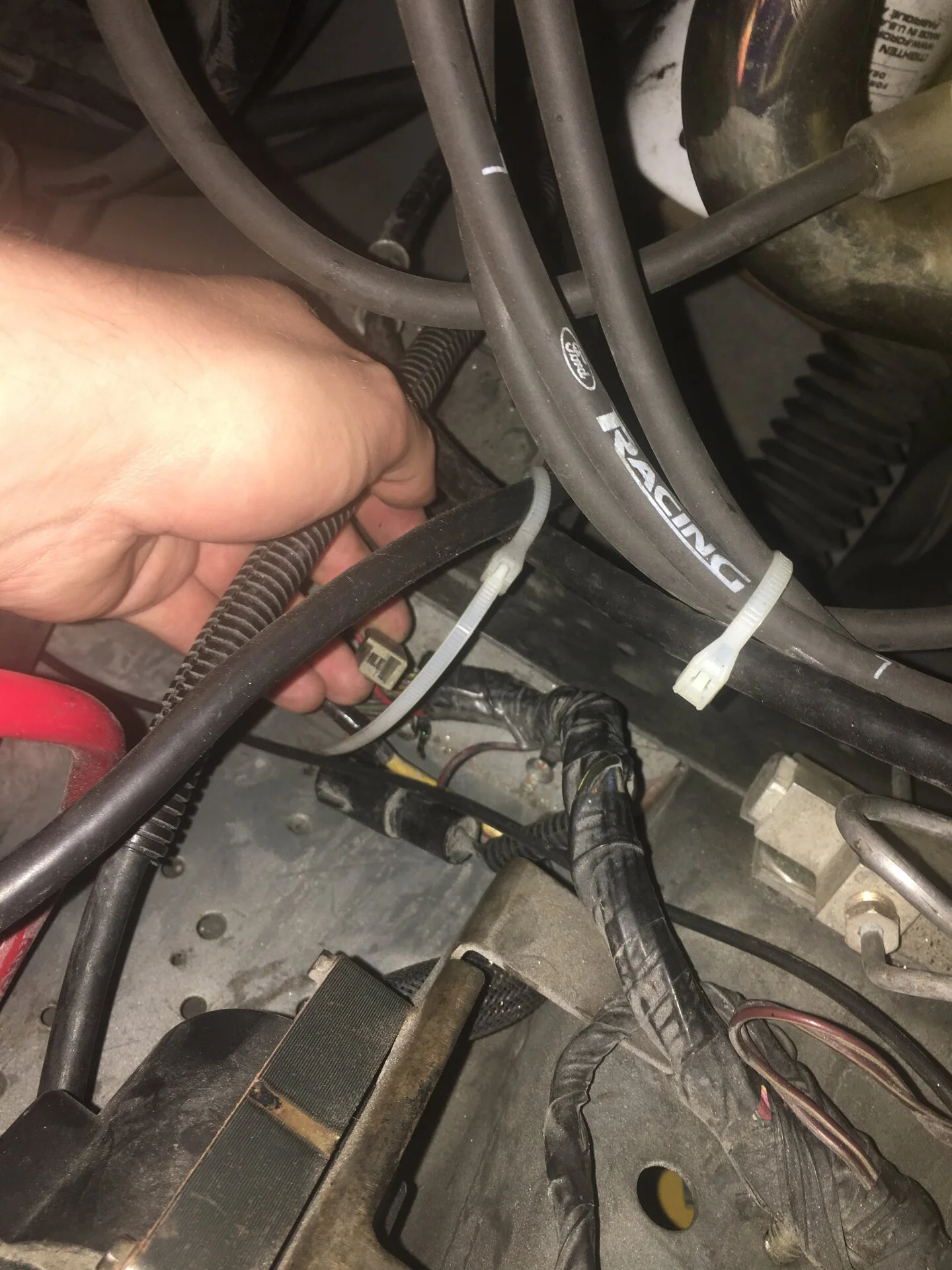

Here’s the end of the wire:

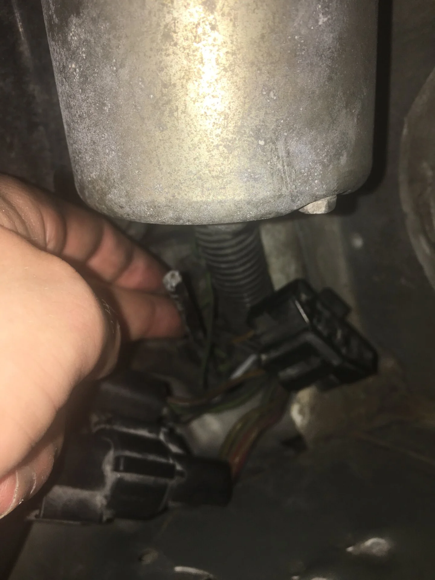

This is a cut black wire that I found when looking for the gray STI connector for the obd1 reader. I have no idea what it is or what it does, so if you guys have any ideas, that would be appreciated. It doesn’t seem to be hurting anything, so I’m ok with letting it be for now.

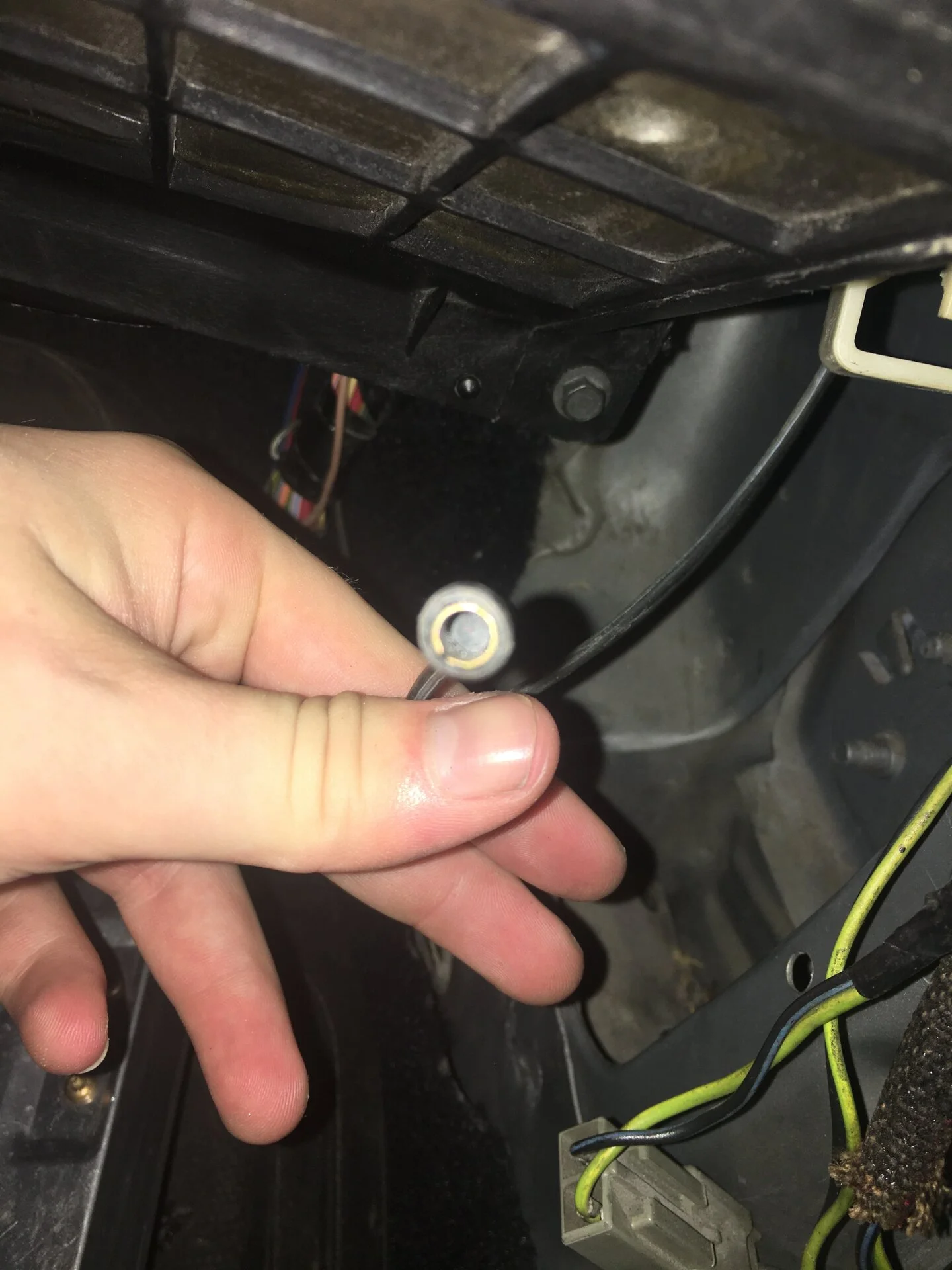

This gray connector is what I was hoping was the STI connector, but that doesn’t seem to be the case. Any ideas on what it does?

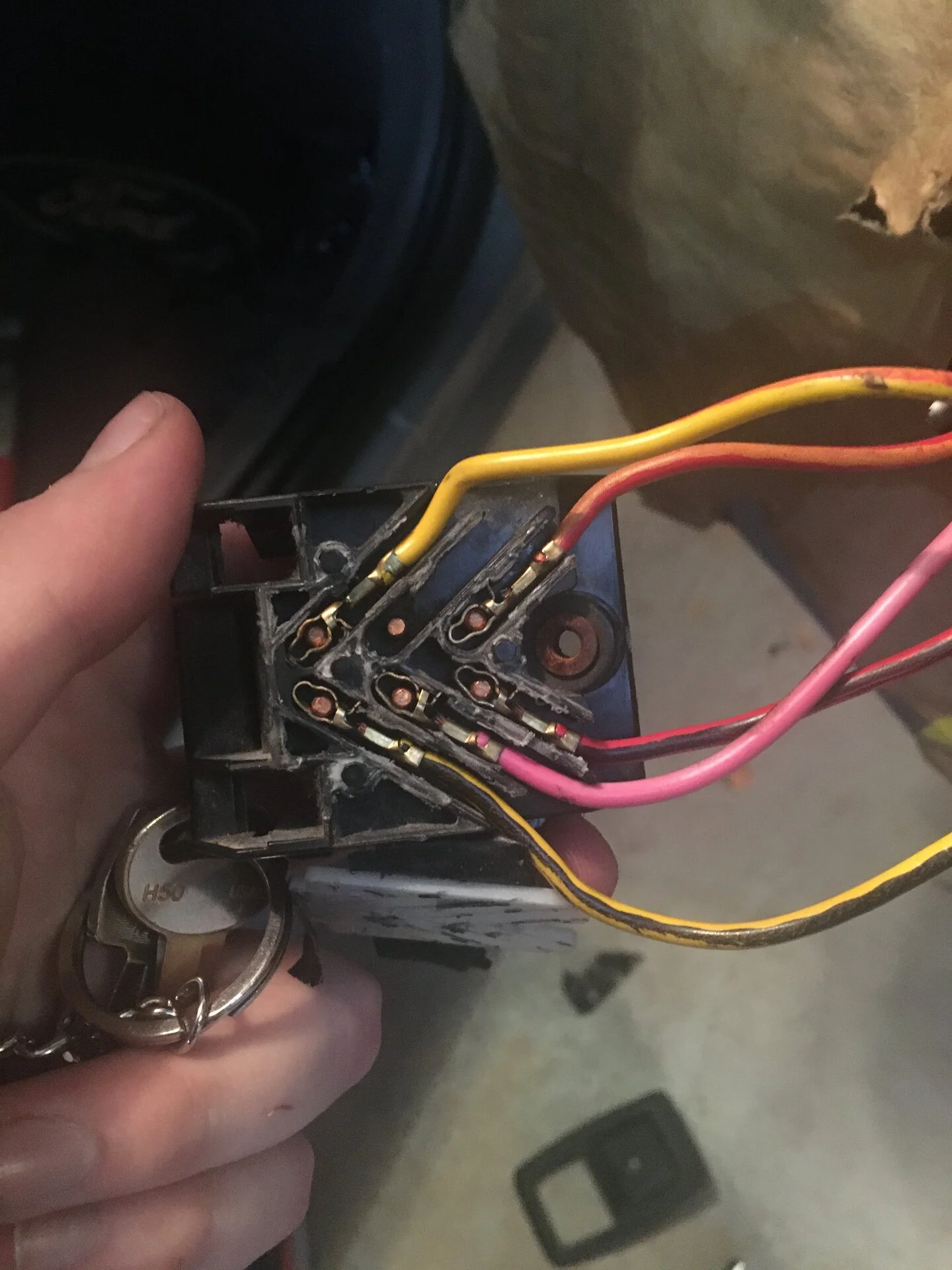

And finally, this is how I wired up the passenger side window switch. I followed a chart and I think I did it right, but it still didn’t work.

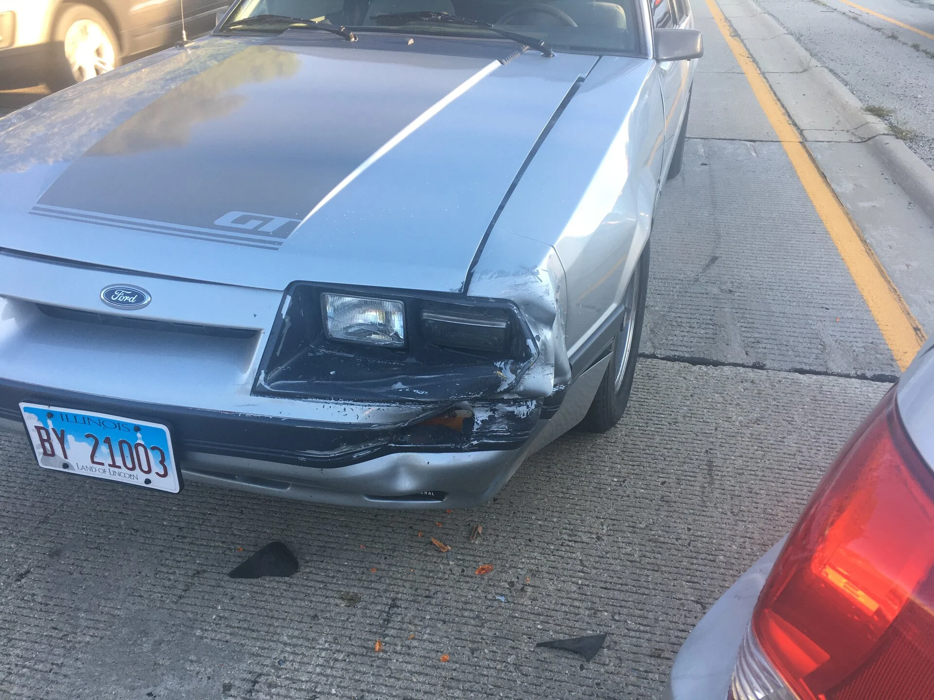

guy in front of me made an emergency stop, it was a downhill slope and my brakes locked up. I have a newfound appreciation for ABS. Everyone was ok, but there were 3 other cars involved and I think things were piling up before I got there but it would be impossible to prove that.
Unfortunately, being the last in line means the law automatically puts me at fault for all of it, so one of the three other people wanted the police to issue a citation, so now I have that as well. My insurance will pay to fix the damage on all their cars if necessary, but the damage to my car is on me.

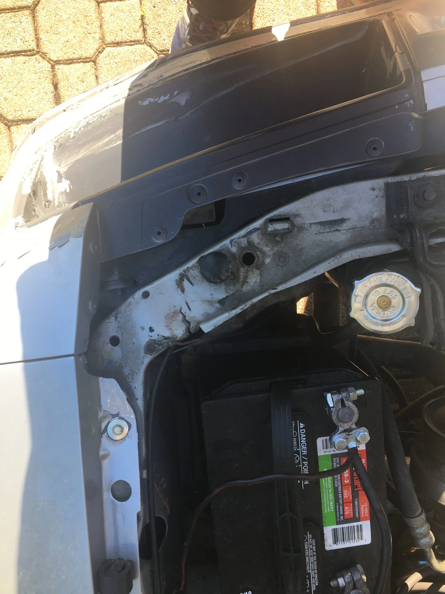

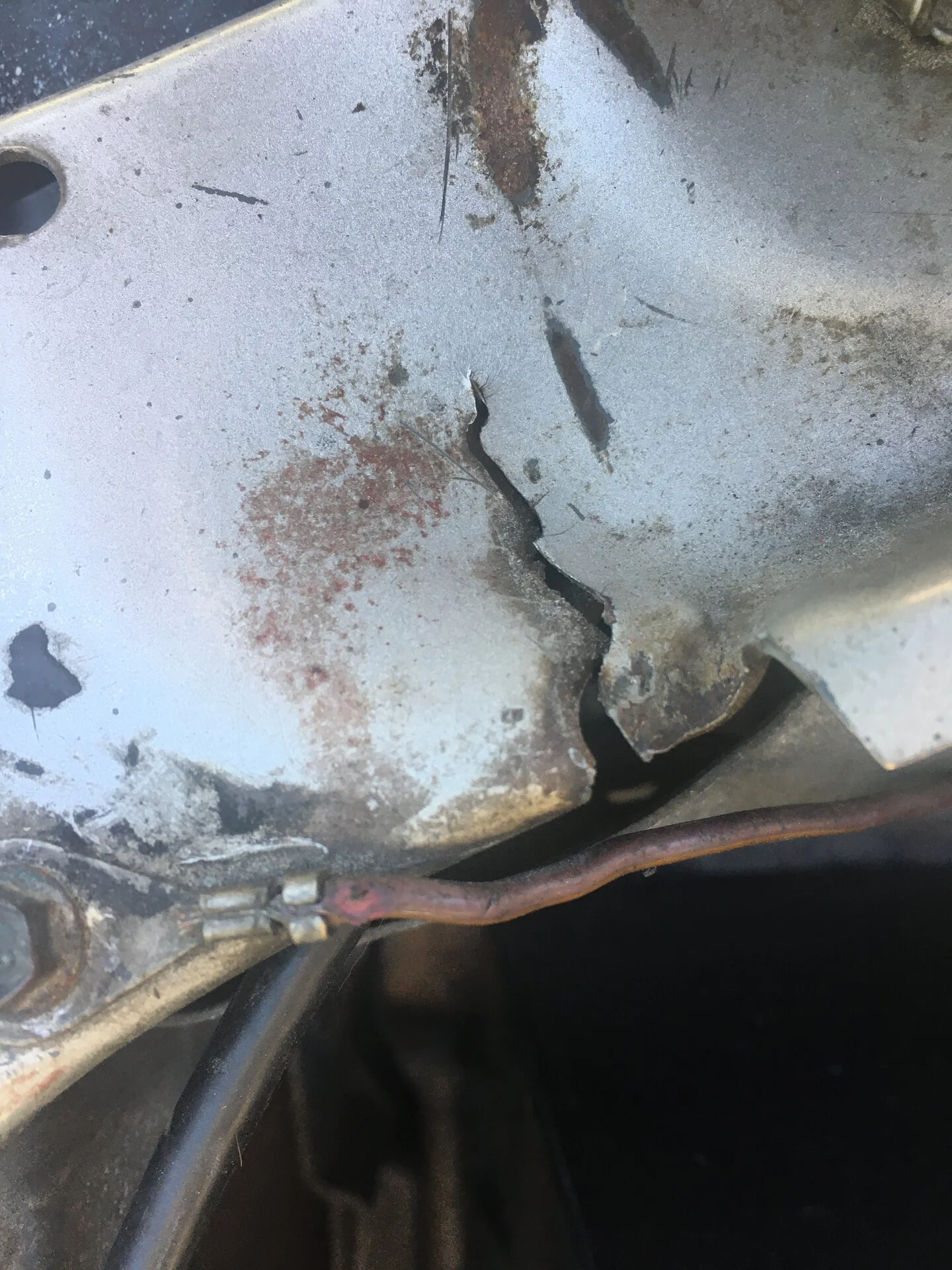

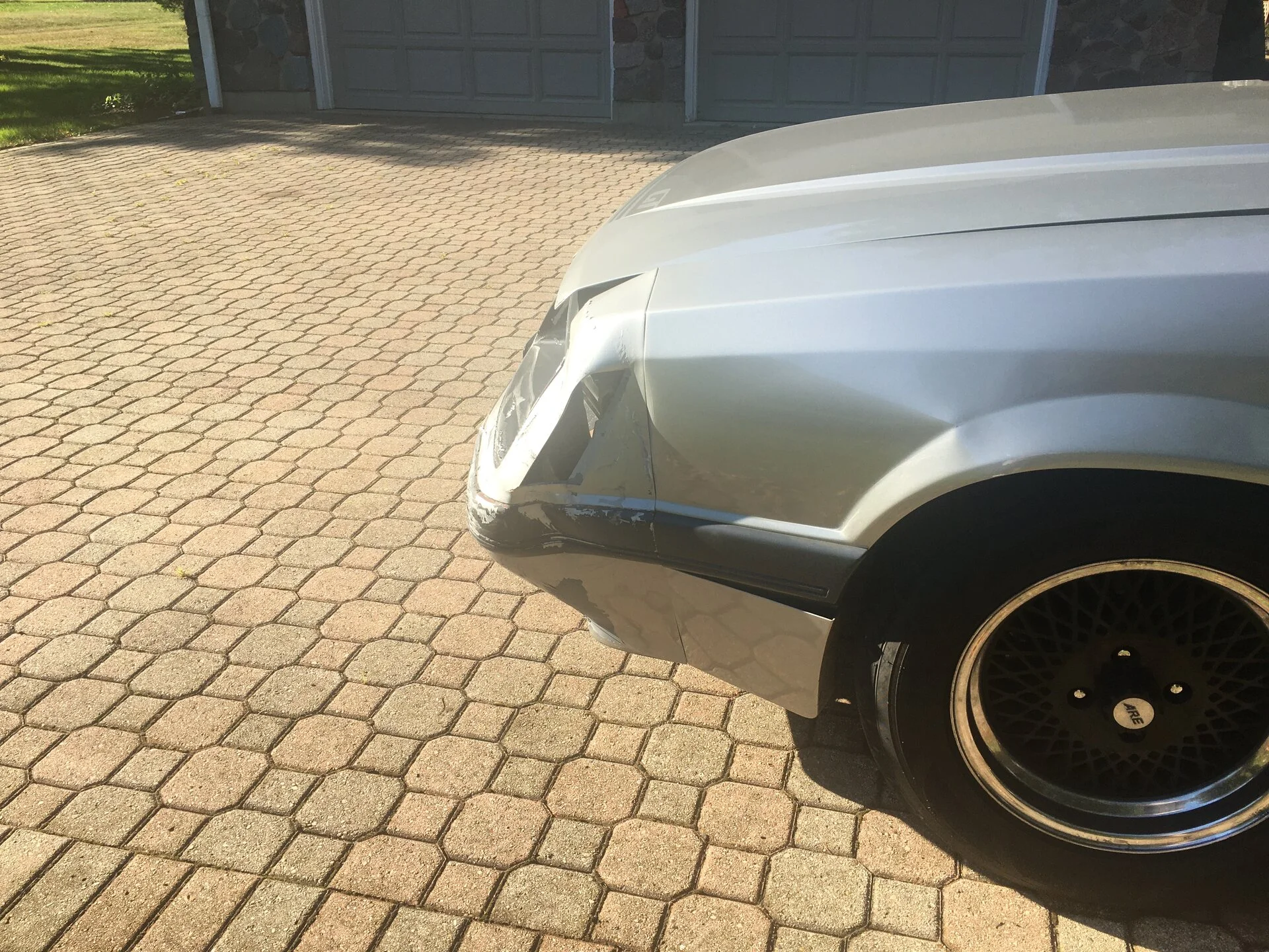

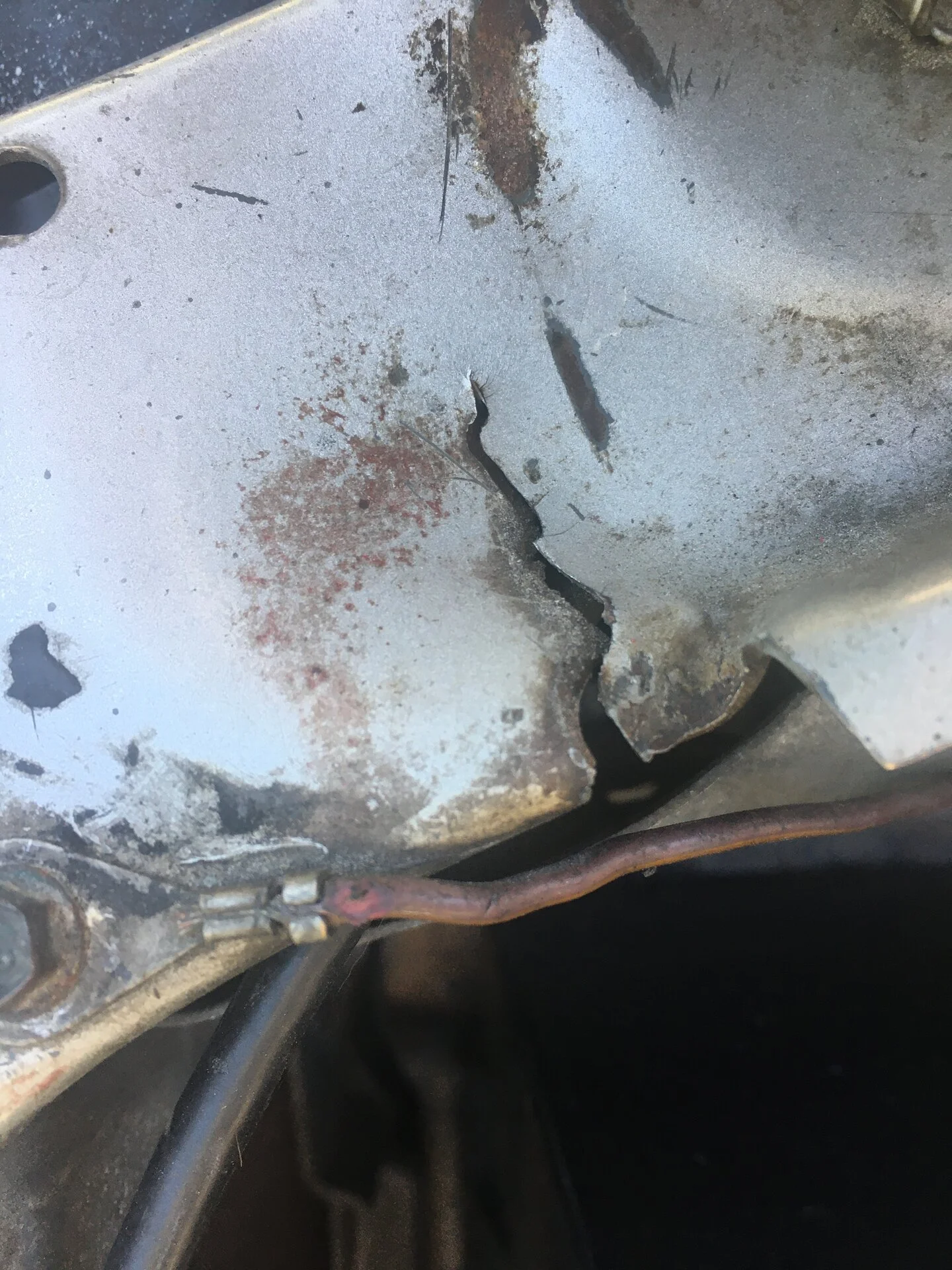

The guy I bought it from owns a body shop and says it’s fixable, but I still have to get it in to find out how much this will all cost. The damage is only to the front bumper and left fender. The door doesn’t really open, the tires rub on the fender and the metal cracked on the radiator support which freaked me out.
