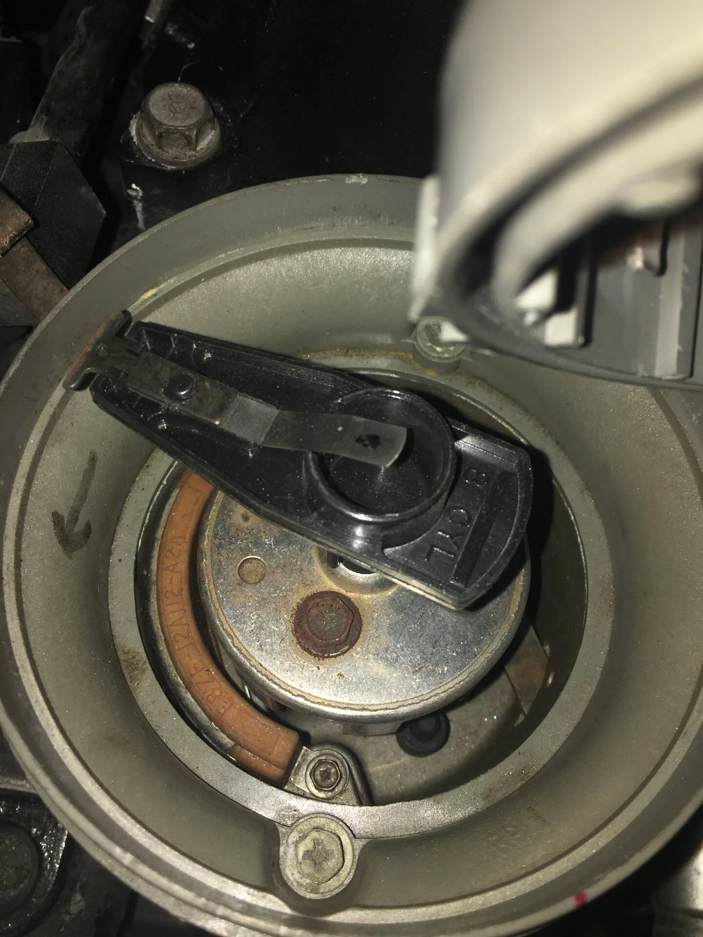

I took the cap off and took a picture for you guys. I’m not sure what indicators to look for beyond scorch marks and bits of metal, but everything looks ok to me.

Do like Mustng93ssp said.....take the belt off and make sure the noise is coming from the distributor. If it is the distributor than you need to change it ASAP. If the shaft freezes up in that distributor it can cause damage to the camshaft amd put metal in your oil.
If you pull the belt amd noise foes away it's something else. If the noise stays then pull the distributor out. Mark the bottom at the base with 2 dots or a line first. Remove the cap and mark where the rotor is pointing inside the distributor. Remove the hold down bolt and pull the distributor up slowly. Hold the body in the same position while lifting it out. The rotor will rotate a little....mark the inside of the cap where its pointing. Once removed the rotor shaft and gear should rotate smoothly. If they don't you need a new one. Check the hear for wear.
Going back in just line the rotor up with the last mark inside the distributor. When you install it the rotor should rotate to the first mark you made inside. The base should line up with the mark on the block. Timing should be right where it was before you took it out.
While the distributor is out look down in the hole with a flashlight. Check the camshaft gear and take note of the condition of the oil pump shaft. ( it looks like a hex shaped ¼ inch allen key.
