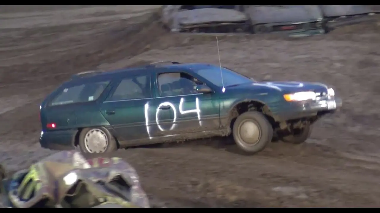

Not a chance, never happen. I only got this turd because a grandbrat decided he needed a ready made family at 19 years old. Now she's gone and so will this turd as soon as I get the title straight.
Waste of a perfectly good Taurus Wagon if you ask me. :shrug:
