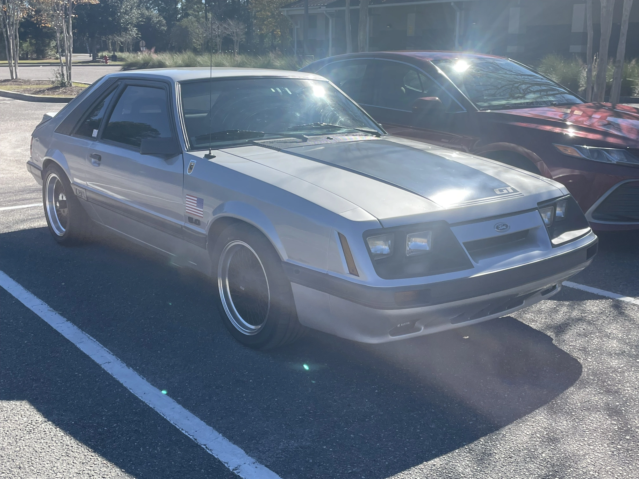

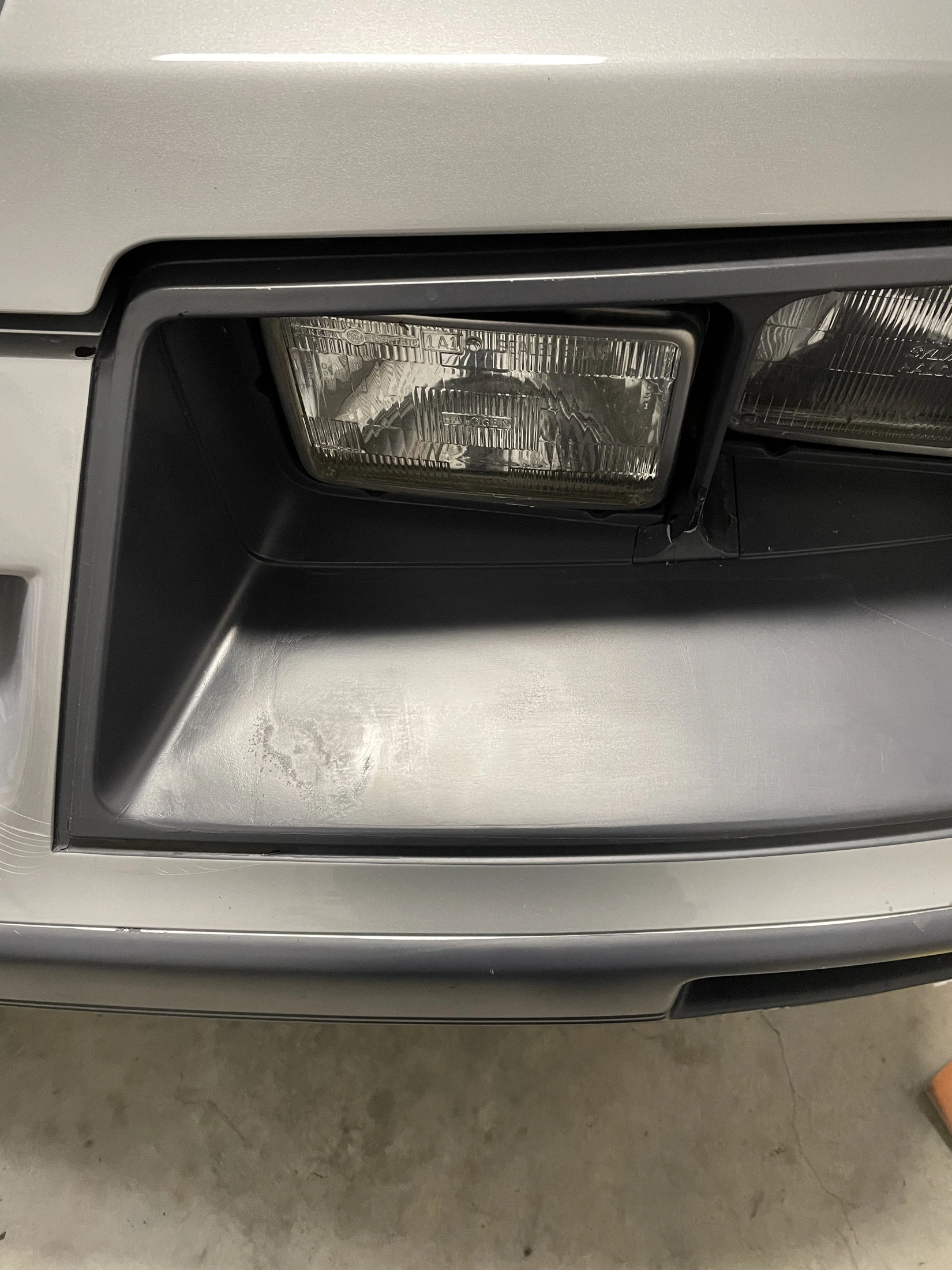

Gentlemen, an update:
I’ve been driving the car around a lot lately. Usually once or twice a week it serves as my main vehicle for the day, which means a two hour total commute to and from work, plus sitting in traffic and drive-through lines.
Everything is working perfectly. The temperature gauge rarely goes past the midpoint, and the fans come on and turn off when they’re supposed to. The weather has been pretty mild lately (my coworkers call it “freezing,”) so the real test will come in the summer, but I’m confident this setup will work.
Since mechanically things are holding for now, I need something else to throw my money and time at, so I’m planning on doing some cosmetic work. There’s a couple stubborn scuffs and scrapes that I’d like to address.

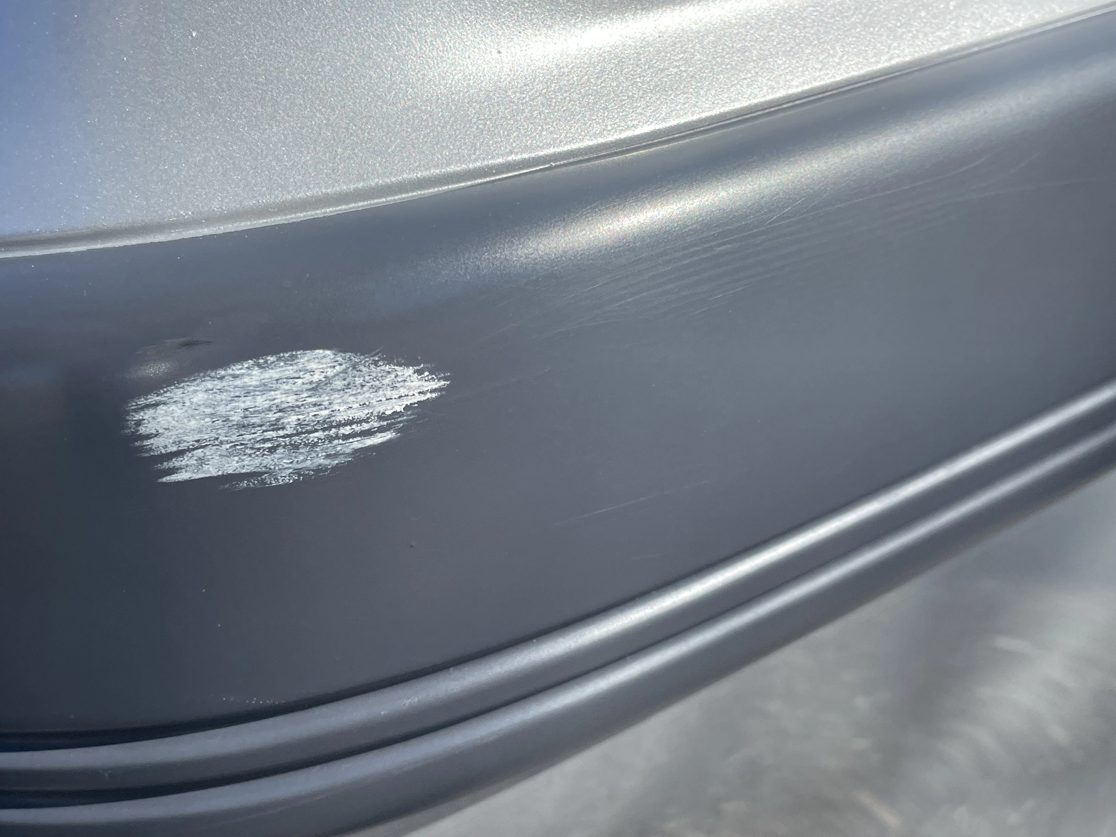

I think this came from a brush with a garage door frame a few years ago. Never been able to scrub it out, and I’m afraid to go at it with polish or sandpaper since it’s unpainted plastic.

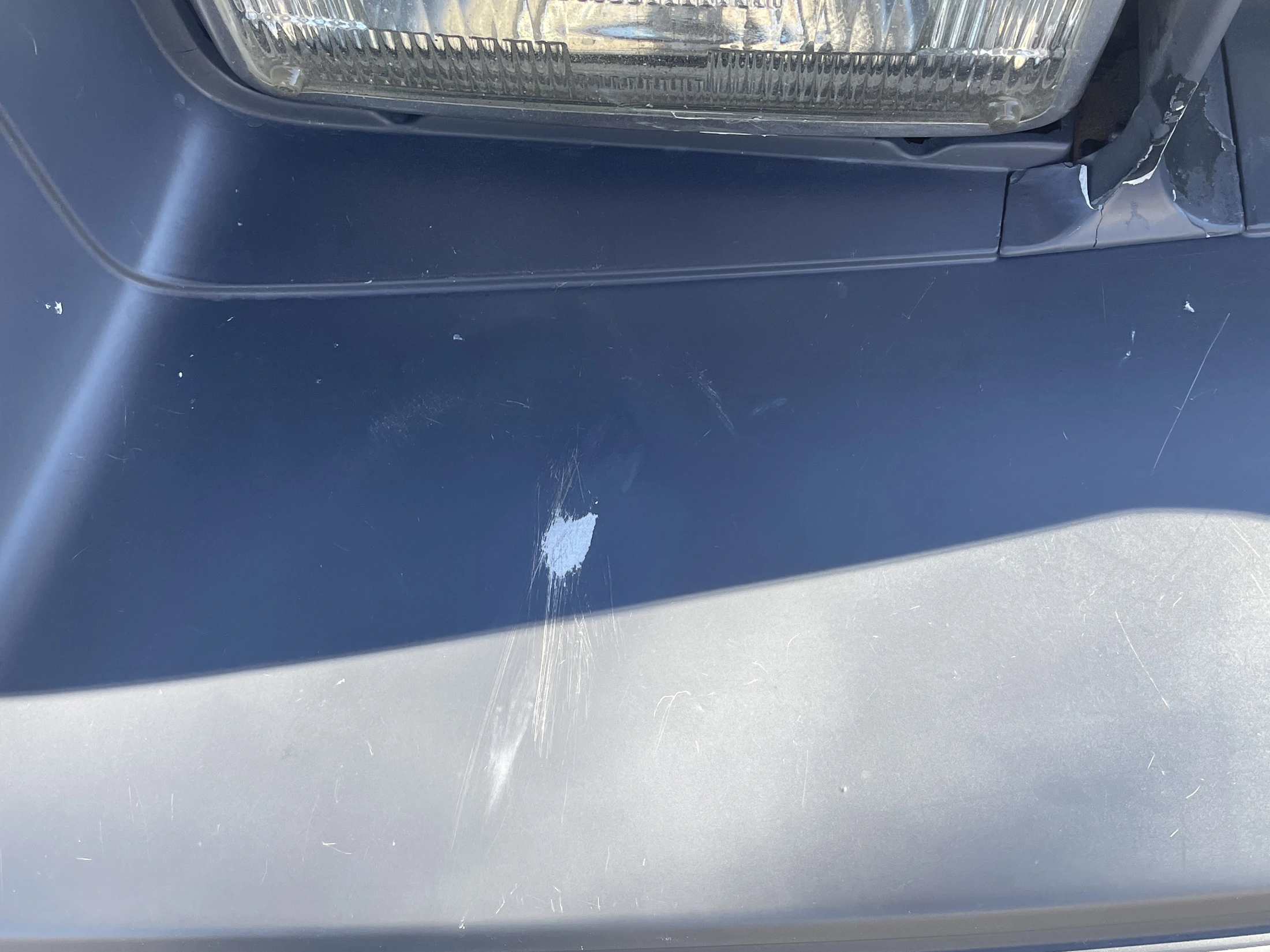

This happened more recently, some ptfe sealant dripped onto the headlight bucket and my scrubbing seems to have taken a portion of the paint off. It’s a satin plastic finish, so I’m not sure what I can or can’t do, but I’m thinking some fine grit sandpaper, a lot of masking, and a squirt of spray paint? I know the paint and plastic is cracking on the divider between the headlights as well, I’m not really worried about that right now.
So if you guys have any suggestions on how to tackle those spots, I’m all ears. I do have a can of gray spray paint that’s supposed to match the headlight bucket.
Hope you’ve all had a good thanksgiving!

Your car looks awesome! That color combo and the wheels really work well together. The black wheel centers play off of the factory GT hood stripe perfectly. I also dig the American flag above the 5.0! That's one beautiful 4-eye right there. Well done!

Thanks, but the previous owner and the weather in California should take most of the credit for the car’s condition. All I’ve done since I bought the car is break stuff
Those flags actually came from an aircraft supply company. They were the only ones I could find that had the correct orientation on the passenger’s side (stars on the right, advancing) in that size.
SEM 39153 bumper coater is the correct charcoal color, but likely your trim has faded a bit. I have an '86 GT the same color, but in the shop for paint and will get all the trim painted in the SEM charcoal color.
Reactions: Alldegree

First pic of the white scuff looks like it’s on top of the gray. Maybe some mild solvent like mineral spirits to soften it up and take it off?
And I agree with the rest, car does look great!!!
I’ll take a look at the spray can. Maybe I should spray a piece of cardboard to see if it matches?
I’ll give that a shot, I figured since it’s paint transfer it would come off somehow but I wasn’t sure how to do it without damaging the plastic below.

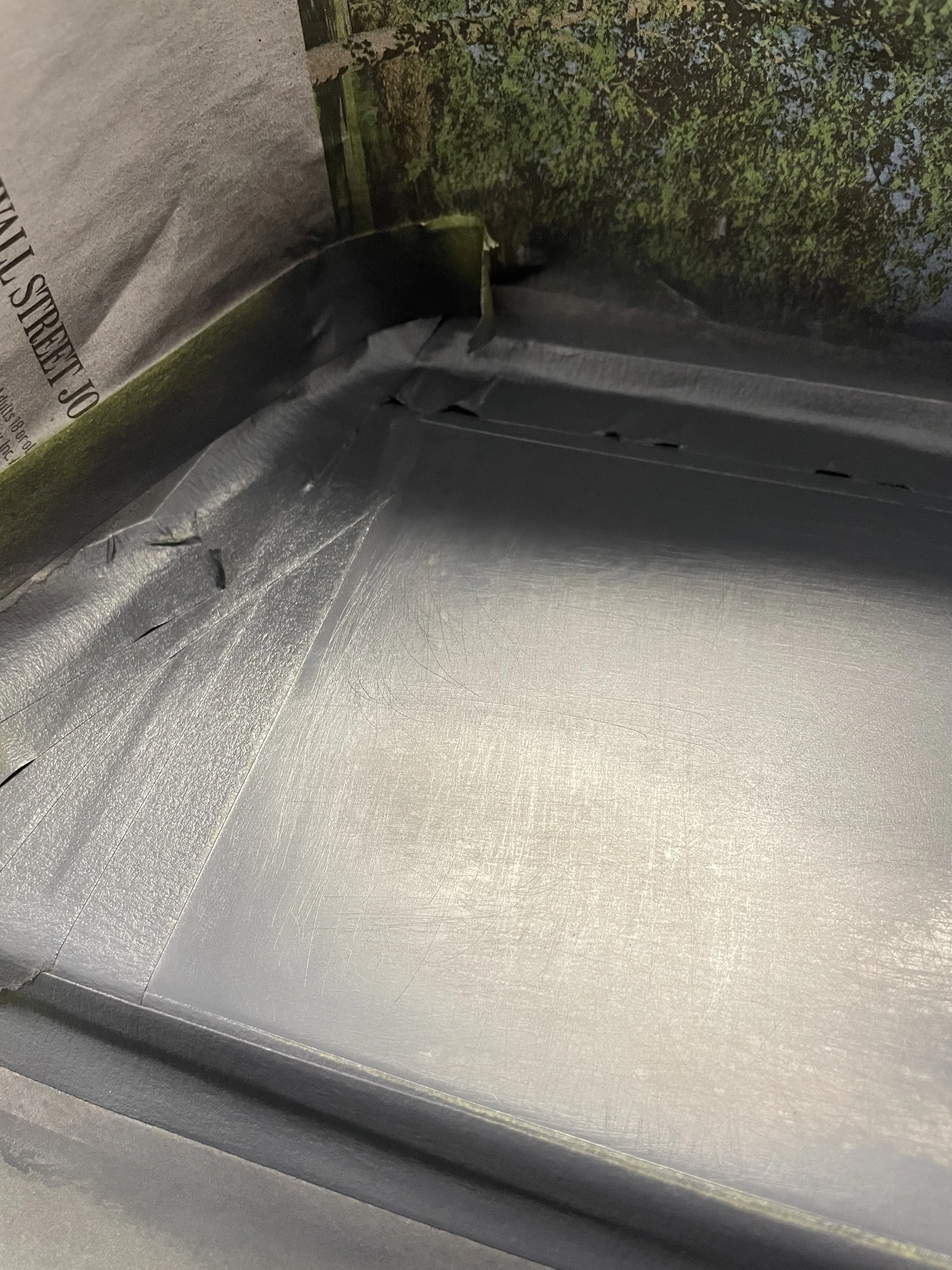

Ok, painting has commenced and things are going pretty well I think.
I’m just taking my time, sanding between light coats. I was using p320 grit, but that seems like it took off too much of the coat while also leaving tiny scratches, so I’m using p800 now to just try to scuff out any scratches I see.
It’s kind of working, but I’m still working on the technique. I know it takes awhile to do it right. Any tips would be greatly appreciated.
Also found out the gray trim on the bumper is, in fact, painted. Should’ve seen that coming. I have a couple tiny spots to touch up on that now too, but I think I’ll see if I can find a paint pen or something for that.

Predictably, I’m running into some frustrating issues.
After spending several hours literally watching paint dry and inhaling enough fumes to probably eliminate a years worth of education, what I was painting looks worse than when I started.
I keep ending up with what looks like dust in the paint layer even after I sand and wipe with a damp cloth. The bumps are always in the same place, and the only way I’ve found to get rid of them is to sand down to the base and start over.
I finally got to the point where I thought it looked good, then I pulled the masking tape and found that I had a raised edge along the edge of the tape.
I kind of expected this, and thought I could just sand them down with some 1000 grit sandpaper, but that just sanded off the thinner paint next to the section I had just painted.
But perfect is the enemy of the good, and good is the enemy of the acceptable, so I’m calling it acceptable for right now until I either have the tools and knowledge to do it right, or just take it to a paint shop.

At this point, I might spray filler primer on-top of that, let it dry, and sand it level before another base coat.
So, build up the low spots instead of trying to sand down into the high ones to make it uniform.
This. And throw a plastic drop cloth over the whole car and mask it well while doing that, so you don't overspray the paint. A few sheets of newspaper isn't even remotely sufficient.
