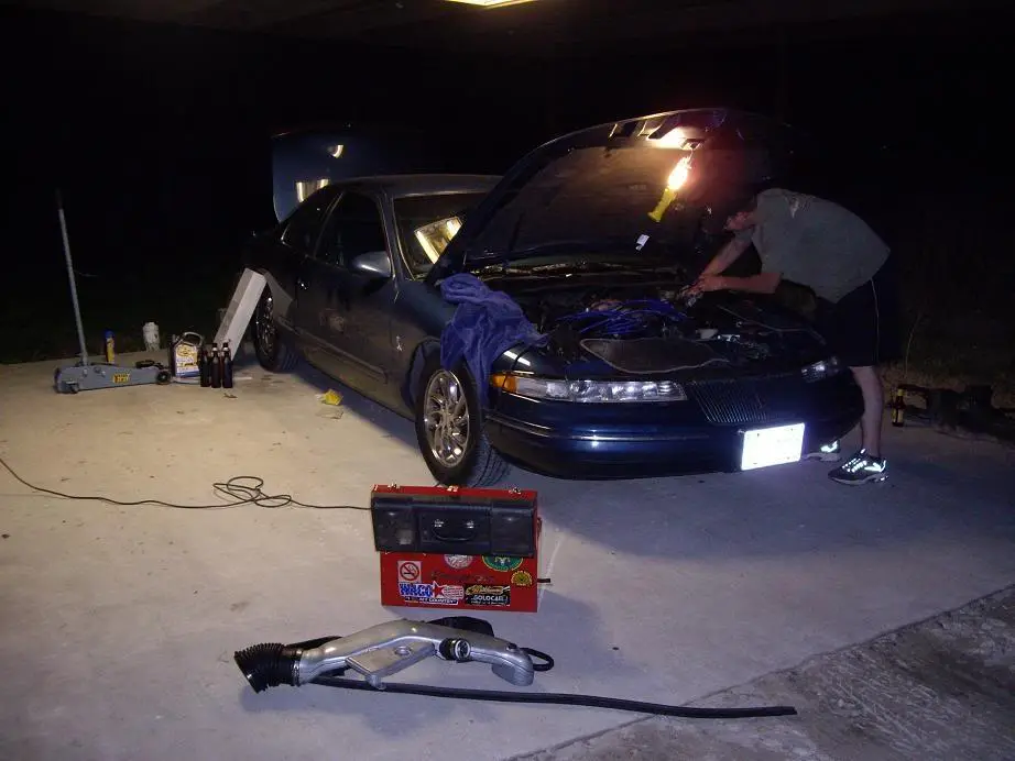

IDK, my Lightning MAF was pegged at 5000rpm and I have under 450rwhp. I could of put a band aid on it but decided to do it right and bought a Sniper Bazooka MAF. Billet aluminum and its 95mm I think. Its a beast and was pretty inexpensive, I think it was under $300
