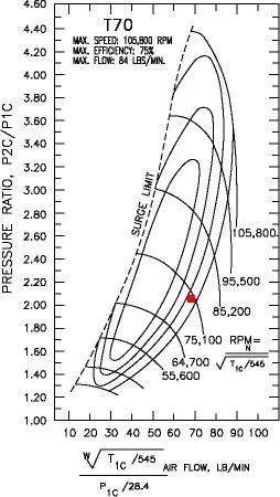

Comparing the flow characteristics of a stock 5.4 at 80% VE and the compressor map of the T-70, I should be seeing full boost of 15 psi @2,990RPM +/- 100rpm. Here is the compressor map of the T-70 with a plot point at which the following conditions are being met on this 5.4L engine:
Engine parameters:
330CI displacement
Environmental parameters
Air inlet temp: 75*F
Ambiant air temp: 75*F
Altitude: 25 feet
Pressure: 14.68psi
Results: Inlet air density: 0.04341 lb/cubic foot
Turbo characteristics
Efficiency: 75%
Manifold boost pressure (w/ 0.5psi pressure drop in intercooler): 15psi
Results:
Turbo temp gain: 183*F
Turbo outlet air temp: 224*F
Intercooler characteristics
Efficiency: 75%
Pressure drop: 0.5psi
Results:
Intercooler temp drop: 165*F
Intercooler air outlet temp: 111*F
Engine variables:
RPM: 6000
VE: 85%
A/F ratio: 12:1
Specific Fuel Consumption: 0.55 lb/HP/hr
Results:
Pressure ratio: 2.06
Air flow: 919CFM
Fuel flow: 5.69lb/min
Engine Horse Power: 691
Engine Torque: 614
Optimum injector size: 850cc/min
Compressor map:
Red dot indicates point at which the above variables intersect the compressor map.
