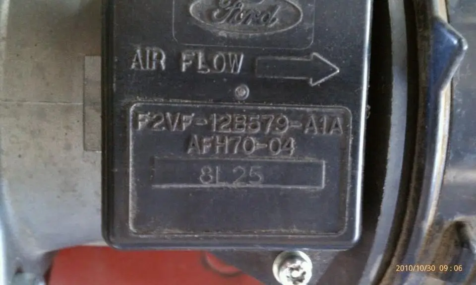

How do I tell what MAF I have? It is easy enough to see. There is no custom tune. So would I be better off going back to the 19# injectors?
We run at 32 mph for 2 minutes then they test idle only for 95. I am going to bolt the cats back in and may go to the rubbing alcohol.
If it's a Ford MAF, post the number on it. I.e. the stock MAF starts F2VF as I recall.
If aftermarket, post whatever you make decipher on it in terms of brand and numbers (and calibration codes. E.g., any number with a # sign near it).

MAF pics
This is what is on it. The tube it screws to appears to be original and I can find no part numbers on it.

So can anyone look at the pic I posted earlier and tell me if it is the 19# maf version?
If i can score a 94-95 Cobra upper intake will it bolt onto a 93 Cobra lower intake?
Dan...
If that sensor is in the stock MAF housing, it should be correct.
The same meter is used on all 94-95 Mustangs. The EEC is what takes care of the 'calibration.'
So if you have a GT EEC, it would correlate to 19's. If you had a Cobra EEC, it would correlate to 24's.
