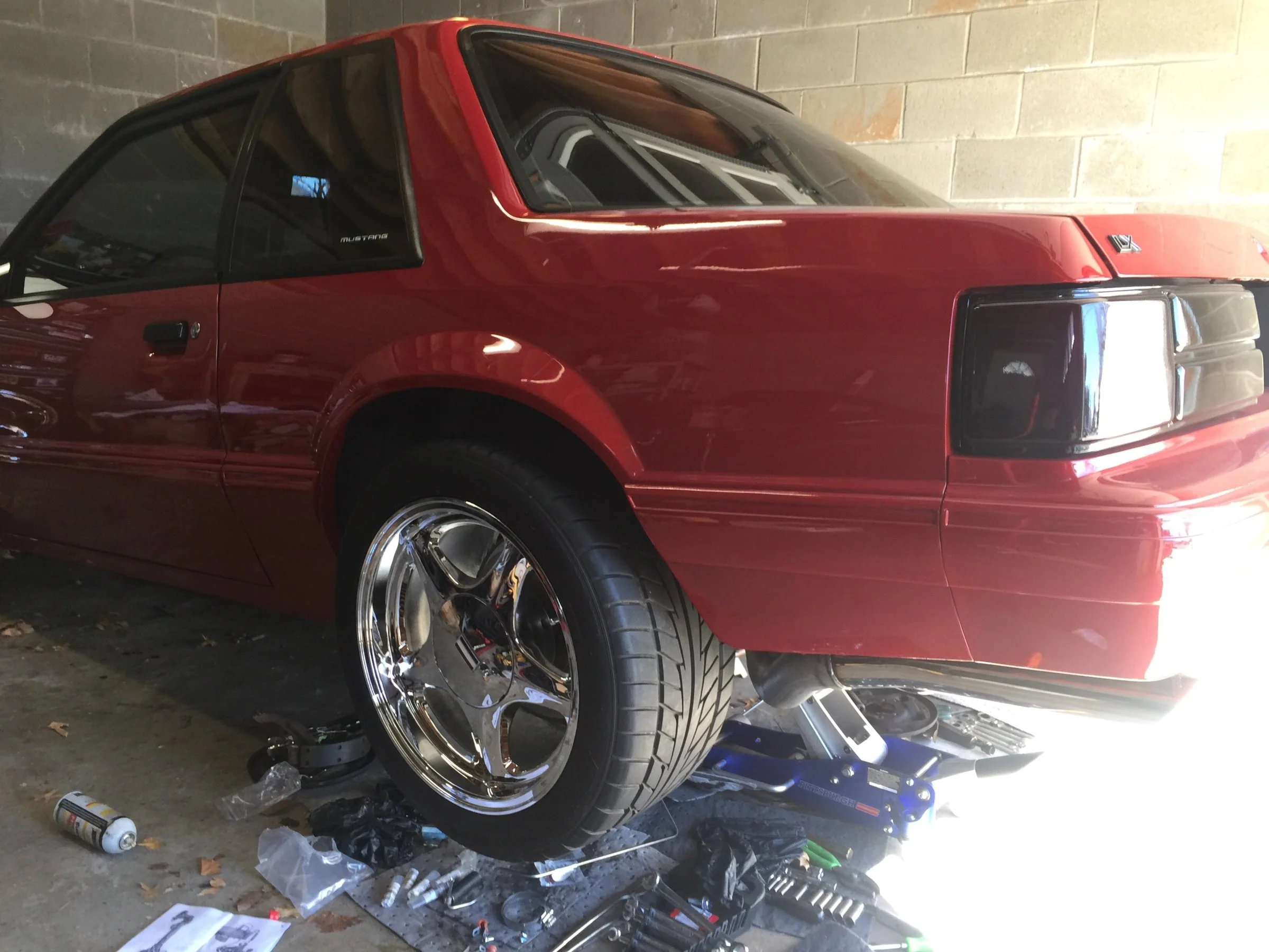

17x8 17x10 275/40 .
No quad shocks , quarters and fenders are rolled
Soon to have the pony wheels you mentioned in 17x8 17x10

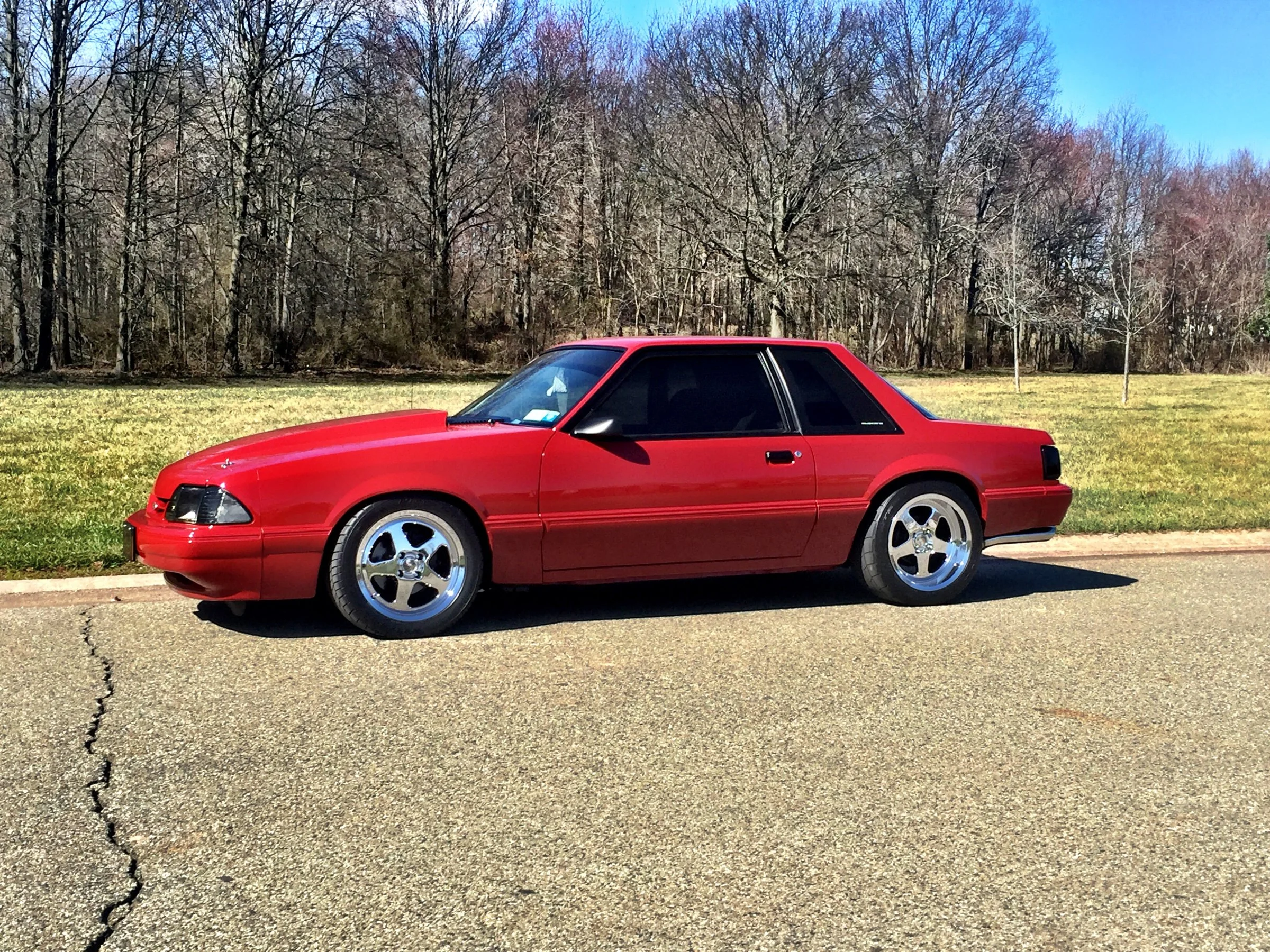

The nittos do run a little small . The Pony wheels will be getting Mickey et street s/s
