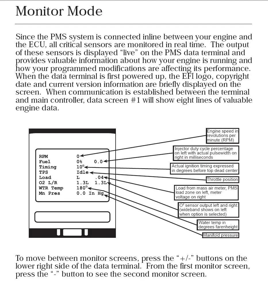

Do you know how to tune using the PMS? Do you have a wideband? Its so easy to adjust things while you drive that you could probably easily solve your hesitation issue or whatever is happening. Have you played with the timing in those cells?

Since you have a PMS, just look at the screen when the issue occurs and see what the o2's are actually doing. Are they switching like normal or sitting at 0? If they're sitting at 0, its the typical longtube header issue and the result is a lean condition. Try adding fuel in that range in low/med load.

No you are referring to the standalone part of things....Mike is referring to the screen that gives the readings out constantly...like timing, o2's, etc etc etc. Do you have the manual for the PMS? If not go to their site and open it up...then you'll understand more.
And that goes with what it old you before...its in the tune. Not the function of o2's with long tubes. A wideband would make it pretty simple also....if it is a fuel issue. It could be timing!
page 10 from the manual....
