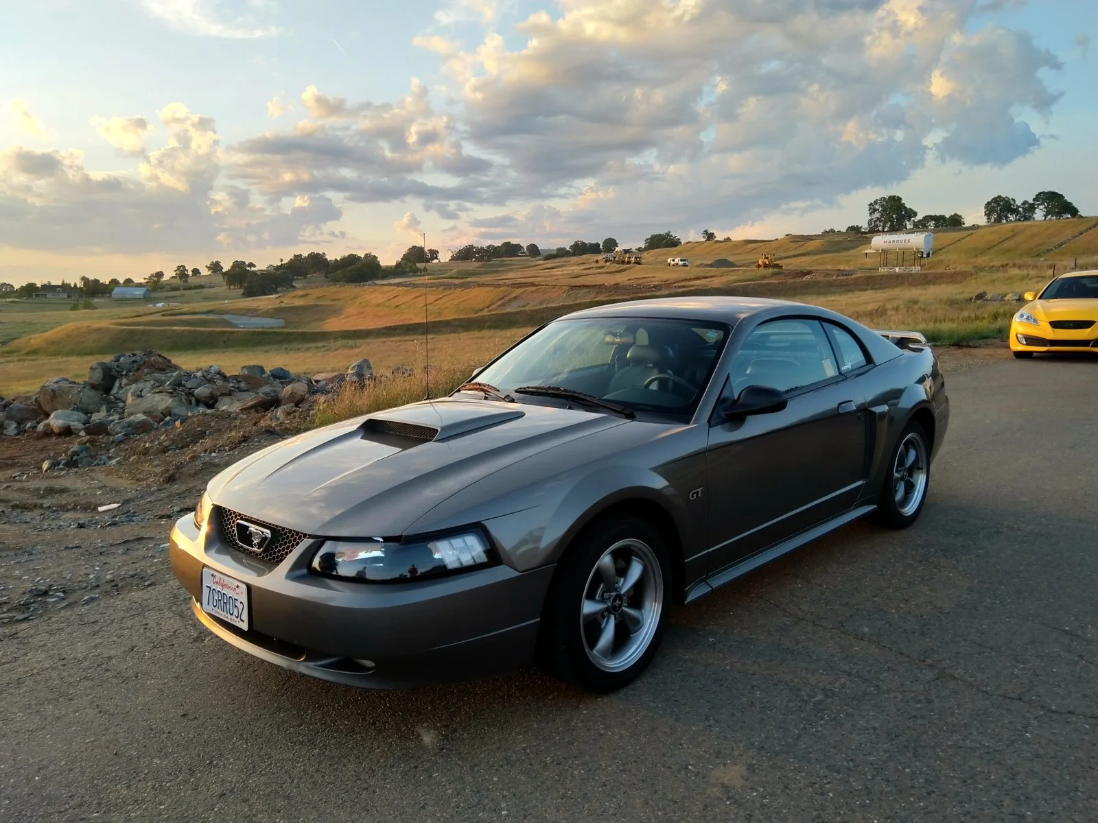

Hi everyone, I have a 2002 mustang gt with a manual trans, fairly stock except some new suspension, cai, and mufflers I've put on it.
Anyway, I've got a friend willing to sell me a 97 Cobra engine that's been bored to 289 and has a rebuilt bottom end that I plan to swap into my mustang. I'm just curious on things to watch out for, like whether or not I'll need to build my transmission or need a new hood, things like that. I figure the harness and ecu from the 2v won't work with it, and since the older sn95's used an analogue gauge cluster (I think, or at least a different one than the 99-04's) I might have to change something there.
