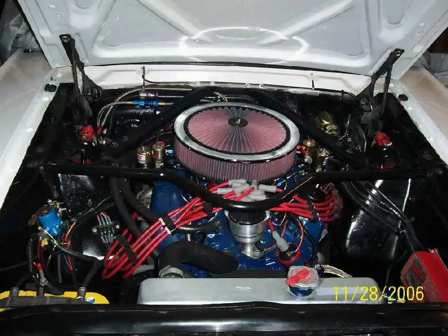

Well here is a new 14" edelbrock on a mostly stock 289. Not an 11" though.

You're going to have hell trying to fit a 4" tall filter in there with any size. A drop base filter will be the only way to do it, even then, don't bet it'll fit. a 2-3" is about the max that'll work. K&N's that height are plenty as far as flow is concerned.
