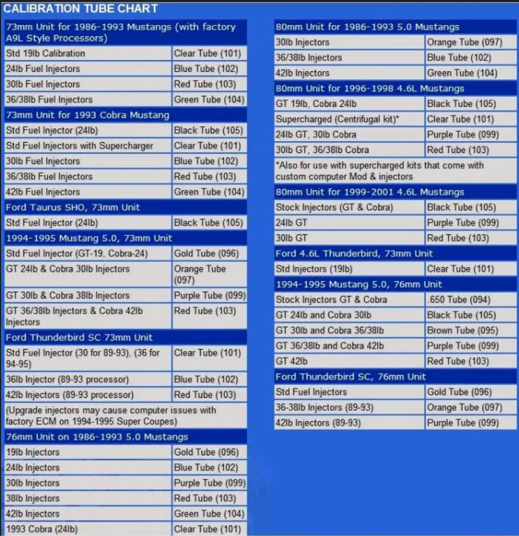

I haven't vetted this, but it seems like it'll help you identify which C&L sampling tube you have.
Color code - Inlet Diameter - Outlet Diameter
Green ------- .6500" -------.4850"
Black --------.4880" -------.4880"
Red ----------.6570" -------.5125"
Purple --------.6500" -------.5400"
Blue ----------.6500" -------.5550"
Clear ---------.5650" -------.5650"
Orange -------.6500" -------.5700"
For example:

Does the MAF have the sampling tube that corresponds to the injectors on your car? If you're not sure, I believe you can tell by looking at the sampling tube and comparing the info with C&L's website. If the injectors are FMS injectors, their color will tell you what kind they are.

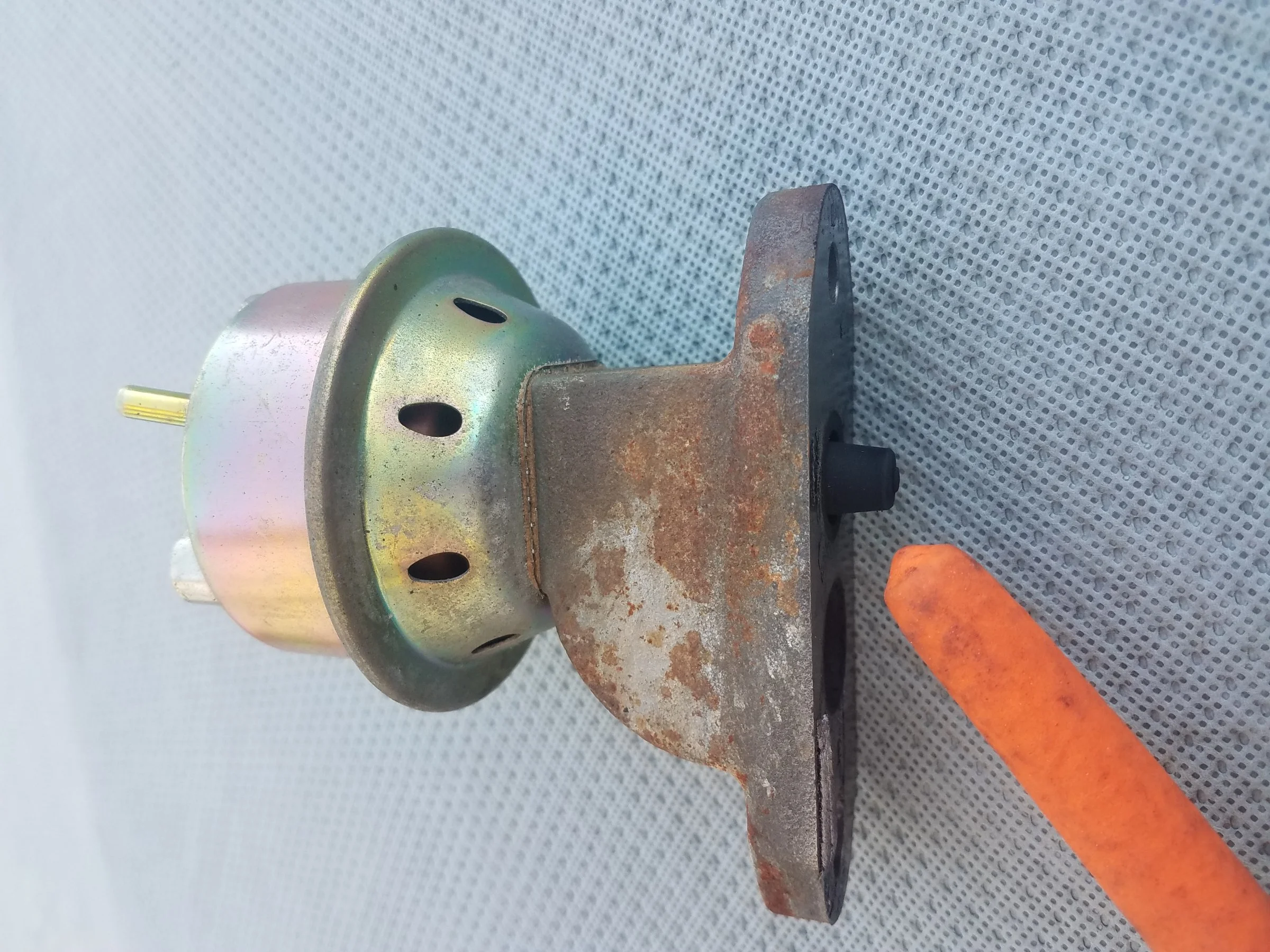

I also was checking the egr diaphram.i noticed if I push down on plunger and block the vacuum inlet the diaphran does not hold.. does that mean it's no good? I'll attach a pic

Go to a parts store and check out a new one; most of the time they don't mind if you inspect a part. If it checks out to your satisfaction, buy it.
