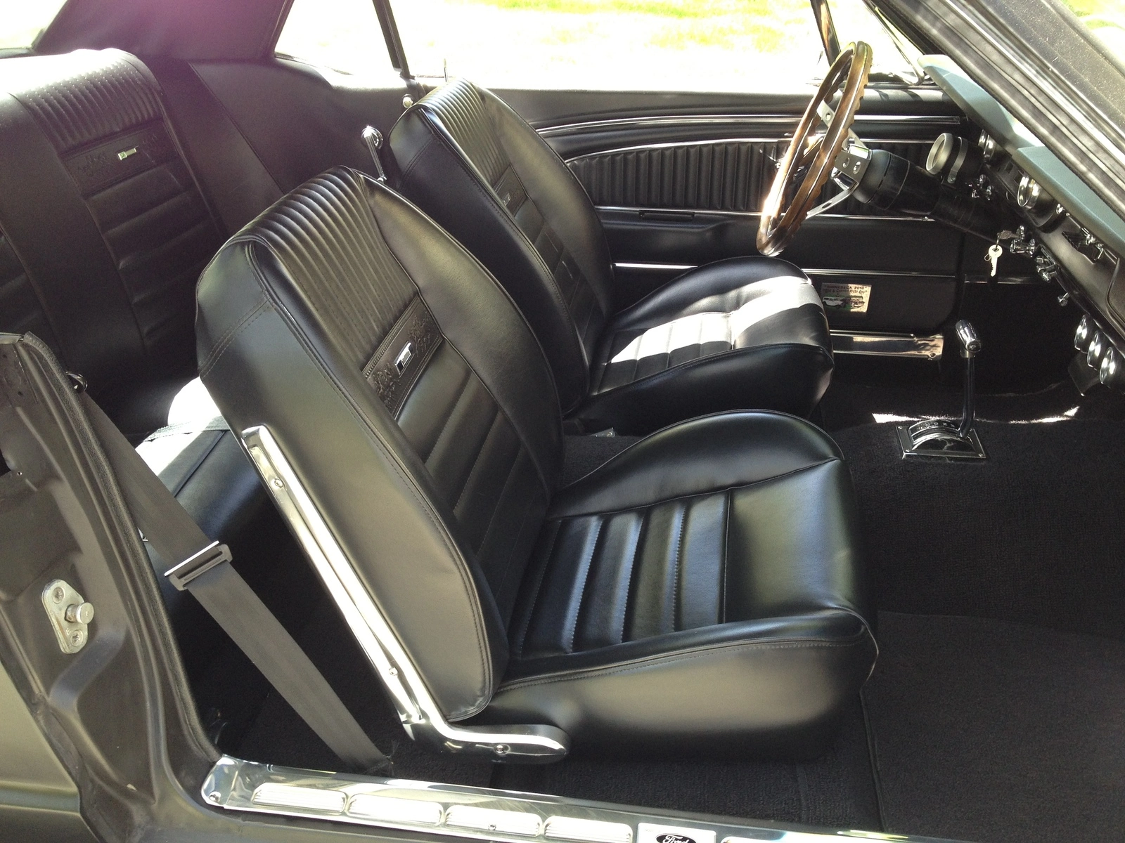

Good morning, So I finished my interior over the weekend. I have about 2 1/2 hours of seat time in them, and I love them. Enough said. :)
Im 5'"10 and in the drivers seat my hair hits the headliner and I cant look out the car sideways without staring at the top of the window stainless....
The passenger seat feels entirely different (It feels & sits like it did before I changed anything) because I hogged the listing wire to the rod in the foam only, on the drivers seat I hogged the embedded rod down the the springs/frame and then hogged the listing wires in the seat down to that rod. I did this to replicate how it was originally done by hogging through the foam and onto the seat frame, and also because the rod in my foam was going to pull out near the back of the bottom seat base.
The drivers seat looks 100% better as it has rich detail in the bolstering, but the passenger side (the one that has the cover only attached to that embedded rod) looks flat and shows no front bolster (Area under the thighs on the stock 65 seats).
Obviously my original foam was worn ,however I did not notice any damage to it. I know it could have been crushed for decades but it looked good and felt fine. In retrospect I think I changed it because I thought it was the thing to do. I am just saying that may not be the correct thought process. The foam density between the new and old was really, really pronounced and I feel it may be a bit stiff when installed in the methods used in the original seat.
