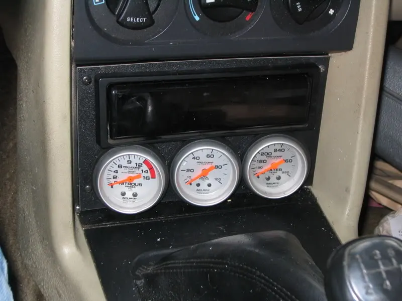

A couple years ago someone posted a pic and link to a radio bezel (aftermarket) and it had provisions for some autometer guages all in the same piece, and mounted in front of the shifter.
Anyone have any idea what I'm talking about, if so thanks:)
I'm planning on doing something like this...

Looks awesome, got any more details on that pic? What guages?
Also, do you not think there will be problems viewing the actual guages when the shifter is in a cruising gear, like 5th or at idle (overheating) in 1st gear?
I'll get some tonight. I would suggest not putting the WT gauge on the far right. The shifter handle gets in the way a little bit when its in fifth. The middle or left position would be a better choice but I am too lazy to pull the probe and capillary tube out to swap them.
Also you will have to do some "modifications" to the bezel with the angle rings. The bezel is designed for the gauges to be mounted straight in and with the angle rings you have to put some bevels on the edges of the gauge mounting holes. Not hard and the directions on the angle rings describe it and how to cut the mounting brackets correctly.

Its the only picture i have of that set up, but it looks like it is the basic pod from
http://www.cp-e.com/2010.html
the gauges are autometer ultralites with green bolbs modified into them. the shifter will block the far rite gauge when in fifth or maybe third but i would stick the least important gauge in that slot. i already have an a pillar pod for boost and water. oil psi, volts, and fuel psi are going to go in the middle pod in my set up.
