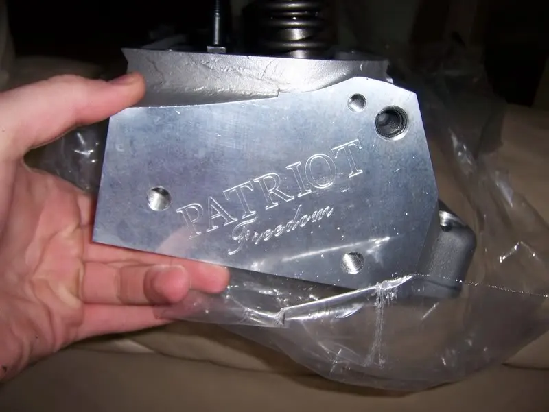

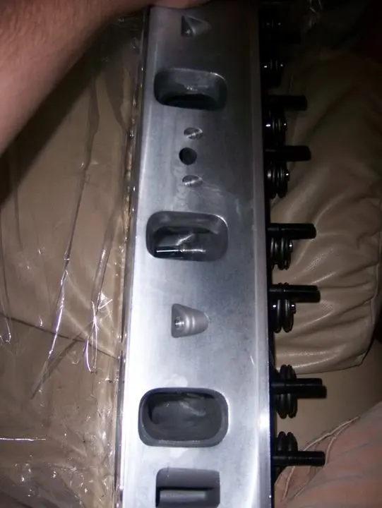

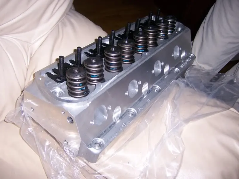

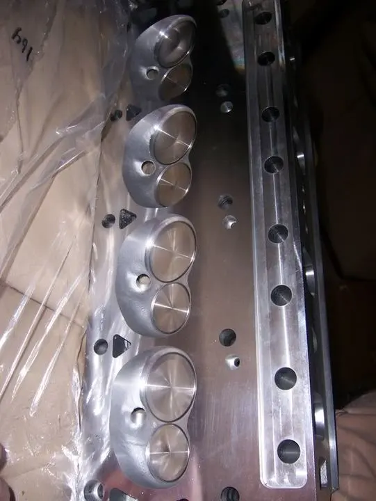

Patriot Performance SBF 185cc heads + lunati 51014 cam(not pictured)
Paid for them Wednesday and got them via UPS today. Aren't they purty:D
MAN I am pumped. Christmas day and the two days following are my off days so I'll be looking to finish her up then she's off to the dyno. Looking for 275+

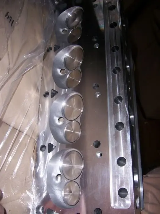

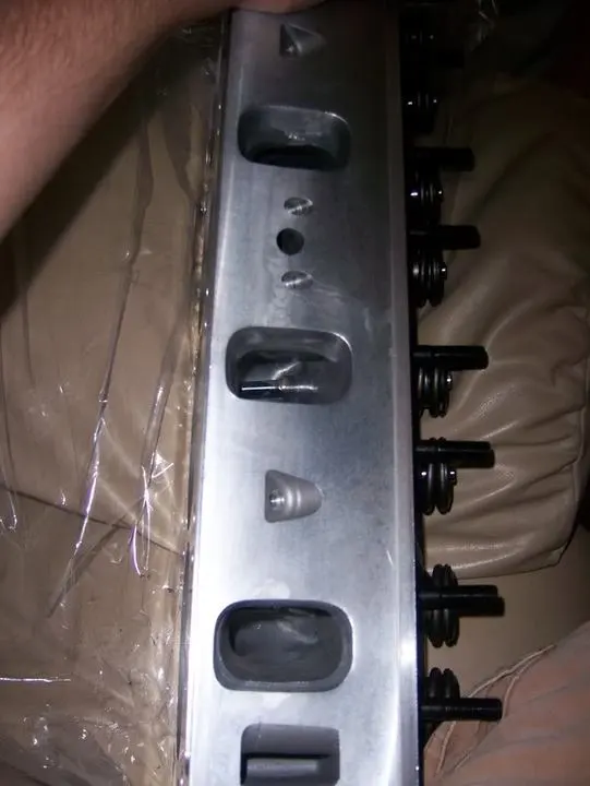

Looks good. I just read a write up on them in a mag and they said there were a lot of shavings and stuff in the ports. Might wanna take a peek before throwing them on, you wouldn't want that **** going through your motor. Do you have the motor out and apart or something?? Are you notching the pistons? They definitely seem like a great head for the money, can't wait to see how they perform.
Yeah stock pistons, you think I'll have to notch them with a cam with only .500 lift and 1.6 rr?
Engines still in and running, just it smokes and idles kinda rough, no blue smoke though! I've looked them over very well I don't think I see any shavings in any of the ports at all. Do you have a link to the article just for some reading material?

you shouldnt have to notch them but it will get close, put some clay on the pistons and go from there, im doing my engine right now, just taking a break for a second but it should run well gtp's/stock cam for now becasue of springs/t-moss

Lift has nothing to do with PTV clearance. When your valves are fully open the pistion is normally at or close to BDC. Duration and overlap are what has a bigger effect on whether or not your valves will hit. I would clay them, but I think you'll run into issues. With a TFS cam and pro comp heads my valves just barely cleared.

I think you will definitely run into a clearance issue with 2.02" valves and stock pistons. Usually the only 2.02 heads that clear with untouched stock pistons are Twisted Wedges. Even if you clay them and they do clear, you need a certain amount of clearance, so they might not clear by enough. Do you plan on pulling the motor and rebuilding the lower end? If so, you will be able to have the pistons fly-cut. I'm not sure if you could notch them in the car. That would probably be a very sketchy operation.

I did a search and found that you can cut them in place using a piston notching tool. It basically goes into the head in place of the valve so it hits right where the valve would and it makes notches. Google piston notching tool and see what it comes up with.

I have also heard from a number of people to take the heads apart to make sure the casting is clean.
