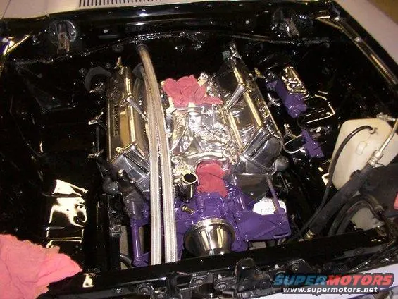

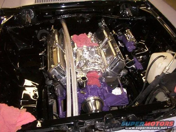

I have no trouble disconnecting my hoses from inside the engine compartment. Why is yours different
Mine went straight into the firewall and had to be disconnected at the heater core. I probably wouldn't have changed the heater core if I could have changed the hoses without taking it out.
