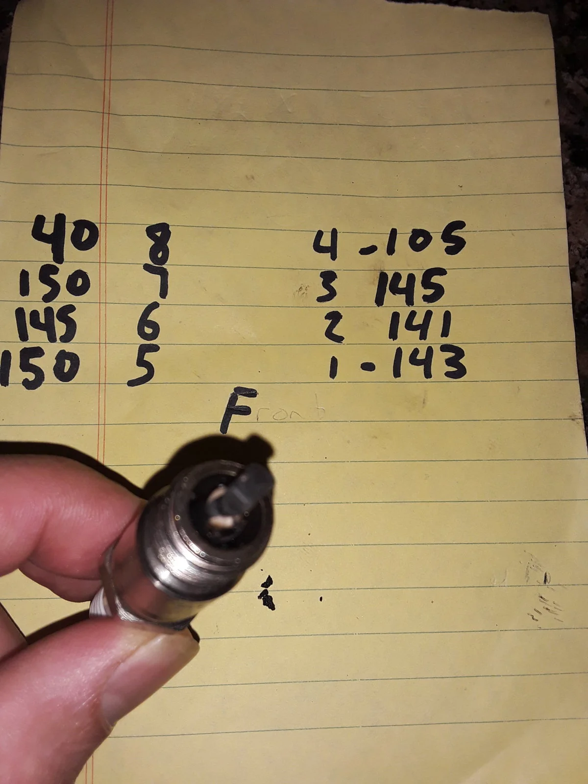

The cylinder by firewall, driver side and passenger side, had lower compression than the rest. Ie: 30&90 Vs. 140-150 for rest. I read somewhere if adjacent cylinders had low comp. It was a head gasket. I did notice some blue smoke under hard acceleration, nothing crazy, but visible for sure. None today tho. ?. Its still running quite strong, so i really doubt im near a whole cylinder down (the 30 psi cyl.) Head gasket, not a biggie, but im not tearing whole thing out and rebuilding yet if its running strong enough for me. I think i wasnt sealed on the comp. Checker somewhere. And the plug looked fine. I put in new MSD iridium plugs anyway.
Just lookn for ideas and making a 1st post. What yall think?

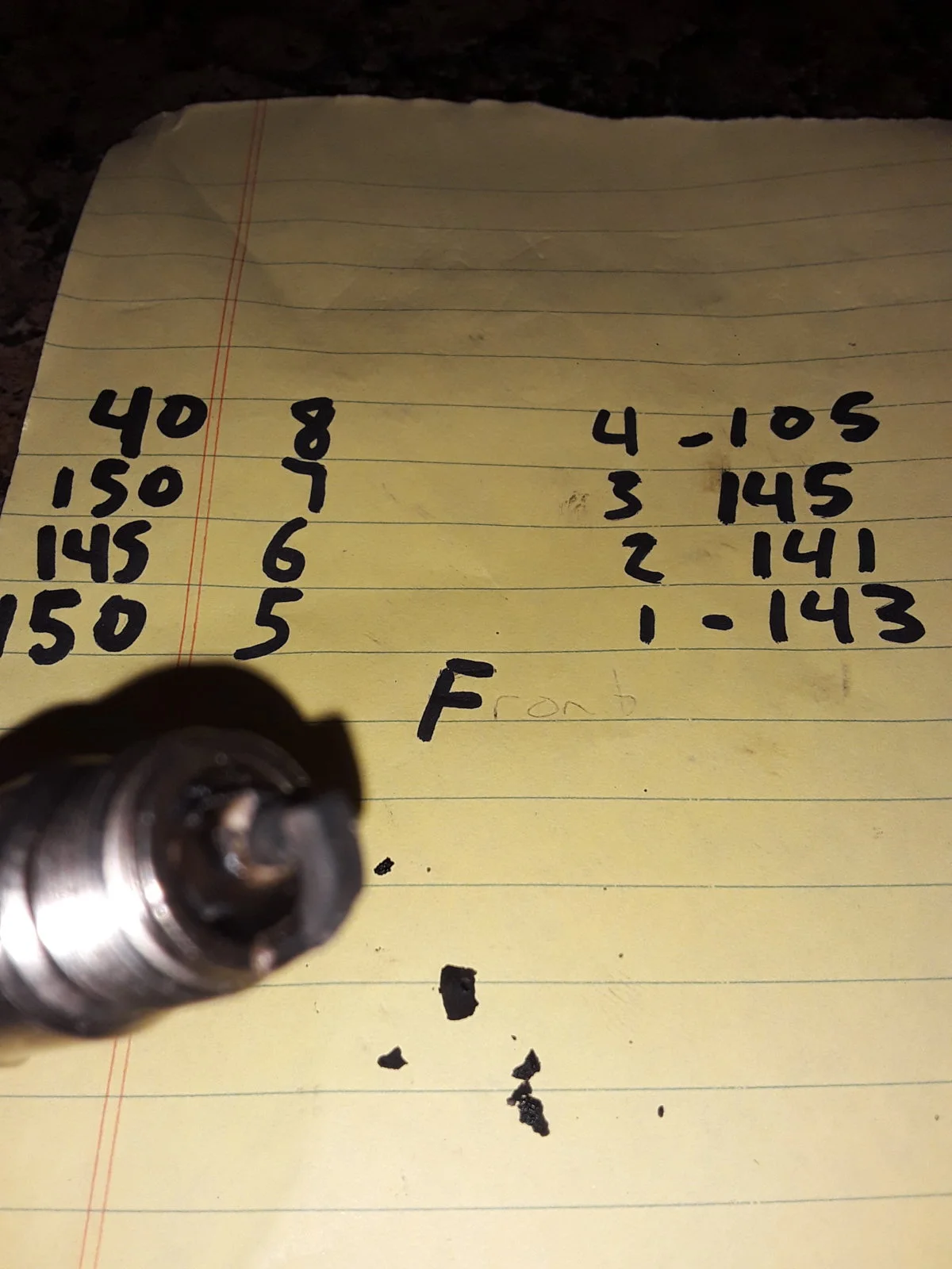

Here us plug off cylinder with 90 psi. Had a ton of carbon? built up around the ceramic i broke up the carbon off the ceramic to verify what it was.

And replace those iridium plugs with hotter spark copper ones.. seriously huge waste of money. The newer materials are to extend plug life not create better spark. There is a reason that performance engines (read racecar) use copper plugs. They are cheap and just plain work. The advent of platinum plugs was so the wasted spark systems of old did not eat the copper plugs up and now manufacturers want 100k before a tune up is needed, hence the iridium plugs.
  • PlusOne
Reactions: Mustang5L5
glasgow- cool, good to know. It's not misfiring. It runs strong for stockish 302 so im not worried about it yet. Im lazy and for some reason that was the hardest plug hole to get my hand right to get threaded in. Once i get a lot of smoke or power loss i'll know i have a real problem.
a91- Only $25 extra. Good info tho. It says more spark, better cold start. The electrode is like maybe .03-.04. The autolites i pulled out was like ..080 gap. lol. (rough eyeball measurments). It actually felt stronger and more peppy. Could be placebo like.
2 things i didnt like on the MSD plug tho. 1. the end of the electrode has a way smaller diameter that is .05 long say, and i can see that getting burned out and opening the gap up. 2. the plug is like near 1/2'' shorter, up top, and using the plug wires i got (msd, came in back seat of car) puts your wires a :taco: hair off the header plate that bolts to the heads.
+1 on the plugs. Copper plugs are the way to go. Iridium is hard and resistive. Great for lasting 100k miles on a modern ignition, but copper works best on these ole fox cars and their 80s ignitions
And 0.080” gap on your old plugs was way to big. Probably a very weak spot and down on power. Set your gap to 0.052”-0.056”
