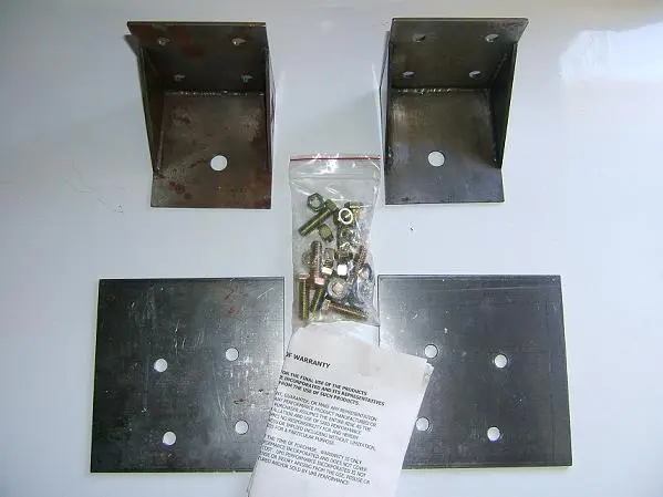

Yo guys I had problems with my torque boxes on my fox mustang. I bought a couple of kits to fix the problem and still have one for sale.
It includes everything pictured, and installation instructions.
Let me know if anyone needs these...
