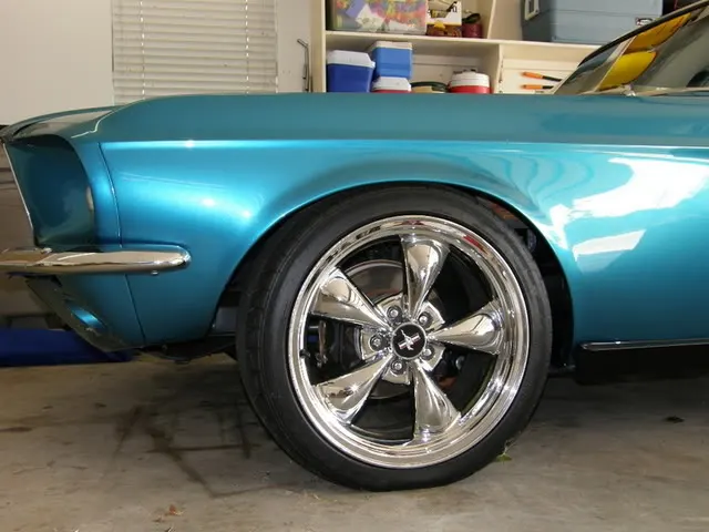

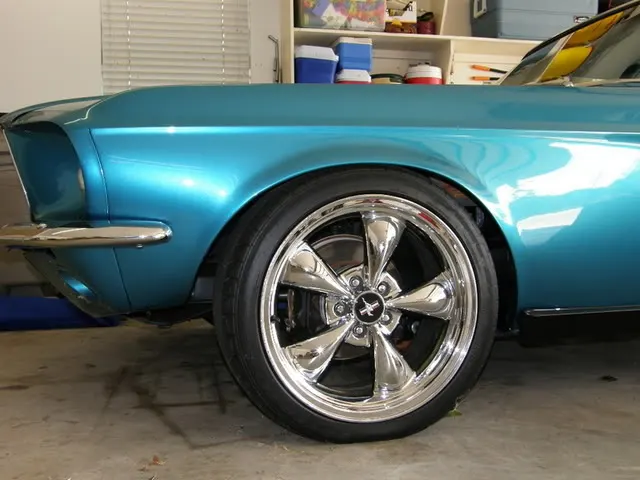

On my 68 I have 1" lowering 620# coils (that somehow lowered it a lot more than 1"- they might have given my 6cyl springs by mistake), and 5 leafs in back with 1" drop blocks. If you want to lower it 2" then this might be the ride height you're looking for. I had to roll my front fenders and will need to roll the rears when I get wider tires. I've got 18x9 wheels though. I'm eventually going to shave 1/4" the drop blocks to make more room for the wider tires and to give it a slight rake.
And yes, I'm proud to be a pic whore :p
