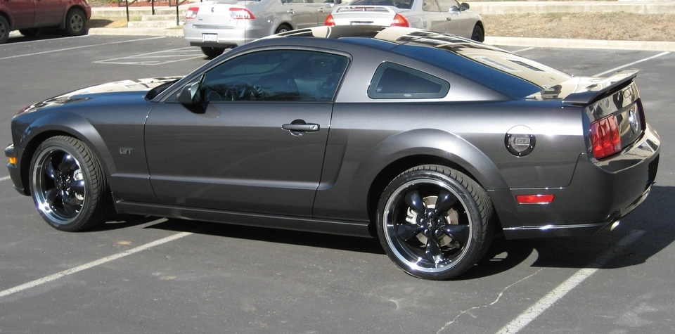

Hey Folks,
I've been around here for some time, lurking and learning and finally decided it was time for a post.
I've gotten all of the recommended upgrades out of the way, save for lowering the Stang. With the addition of 20" wheels, it became apparent that springs would be a necessary future upgrade, however, I'm not sure which avenue to persue.
Sportlines were my initial thought, but after some research I think the install will be too involved, too expensive (all at once), and impractical for a daily driver. I'm now leaning toward the Eibach Pro Kit or the FRPP K springs. Following are my concerns:
1) 1.5" Seems to be the ideal drop. It's low, but not too low to impact daily driving. With this type of drop, is it a simple spring replacement or does it require the adjustable panhard bar, the adjustable tower plates, new shocks, etc? What is absolutely needed (not just "nice") for this mod?
2) Eibachs or FRPP-K? I'd like to keep the warranty, so I'm leaning toward the Ks, dealer installed. There was, however, a post here recently where a member did not get the full advertised drop. Is this a common problem and should it be a concern?
3) If caster/camber plates are installed, will this affect the installation later on of a strut tower brace?
Let me know. I'm hoping to be rid of the rear fender gap sometime soon. I appreciate the help! Something else to consider in your response is the addition of a CDC "classic" chin spoiler. Potentially dangerous with a lowered car? Below is a pic of how she sits now.
Thanks!

Thanks guys for all the replies. I've finally got an idea of the route I'm going to go. Not sure what springs I'll go with yet, but I will probably invest in the CC bolts and a panhard bar to start. Steel has a very nice write-up and has gone the direction I'm trying to go. While I don't race my car, I do like a taught suspension that allows the corners to be carved! I'll piece it togther one part at a time. Not only is it easier on the pocketbook to stretch it over time, it's also intriguing to feel the difference each component makes rather than an all-at-once difference. I'm weird like that, I know...
I have had problems rubbing the bumper on curbs and parking blocks as it sat stock from the factory. I think I've got myself trained not to pull forward over curbs anymore and believe I am ready to lower with no ill effects.
And in response to stangdude2000, yes, my car is Alloy. I'm assuming it's just the camera and abundance of light that made it look more grey than black. At night it looks black, but during the day it appears much lighter. The color has changed (to my eyes) with the addition of the black rims as opposed to the charcoal bullitts I had on it prior and I see the car everyday!
