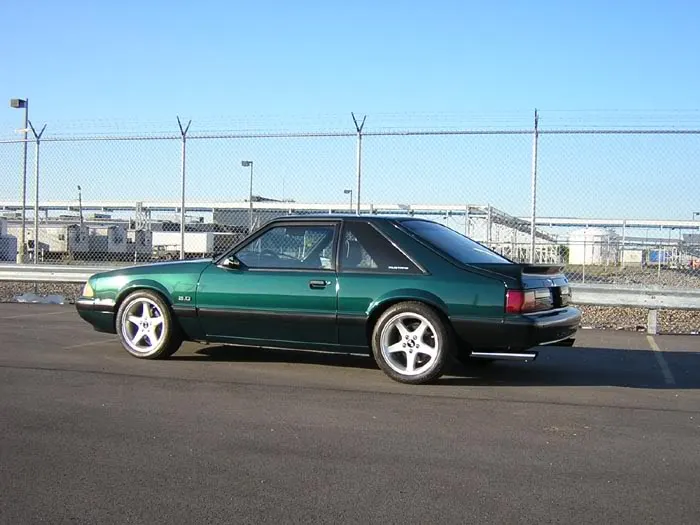

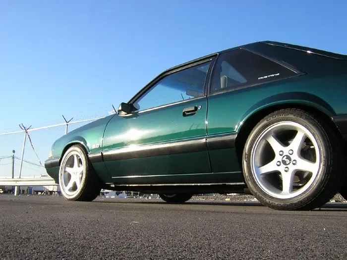

If you want cheap, I am running springs from Mustangs Unlimited. ($150 if I remember right) They are apparently made by Eibach. The drop is nice and the handling is decent for a Fox body. The ride was crazy harsh though. If you haven't replaced shocks in a while then its probably a good idea to do so. I just popped in some Tokico HPs and the ride is much improved.
