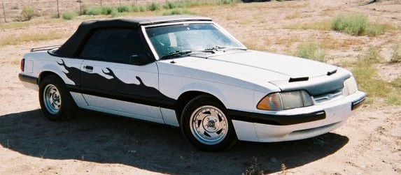

I have Maxspeed springs. I love them. I think they are a ricer company, but I got them for cheap on ebay. I had to cut somewhere between 3/4 and 1 1/4 coils off the front, I dont remember exactly. Here is a pic.

I tried to take some pictures yesterday but it was too dark when I got home so they didnt come out. This is the only picture I have taken since I installed the springs. Its a bad pic but you can see how the car sits. I think the picture makes the back look a little bit higher than it really is though. Probably cause the driveway is uneven or something.

My rear used to rub on the fenders really bad. I was running 245-60r-14's at the time. I switched to some 225-60r-14's and they still rubbed. I ended up hammering the the fender "lip" (look at it and you will see what I'm talking about) flat against the fender. The rubbing issue is basically solved. If I have a couple people in the backseat and hit a bump pretty good then it still hits. I dont think my rear wheel wells are different since mine is a vert.
-Josh
P.S.-When the photo was taken I had 5/8" spacers in the rear, so it actually sits lower than in the pic. Any lower in the front and I would hit on EVERY speed bump and steep drive, not just big ones like I do now.
