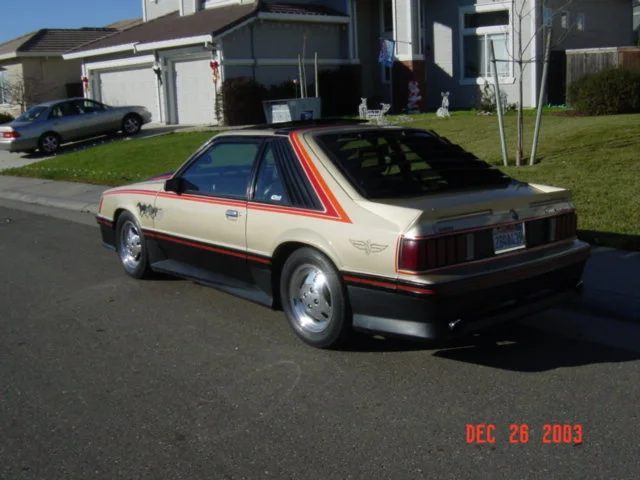

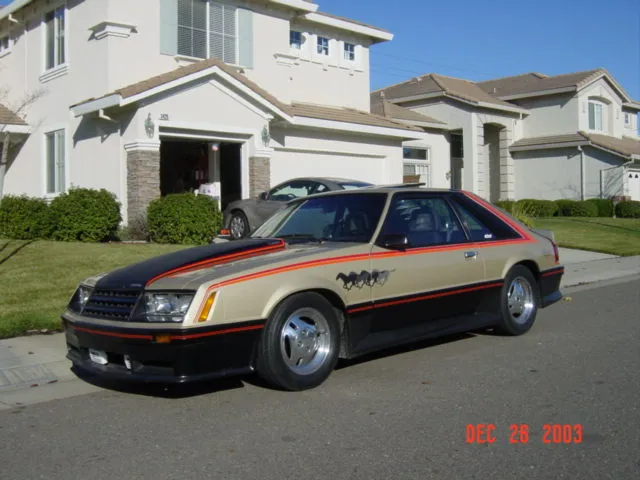

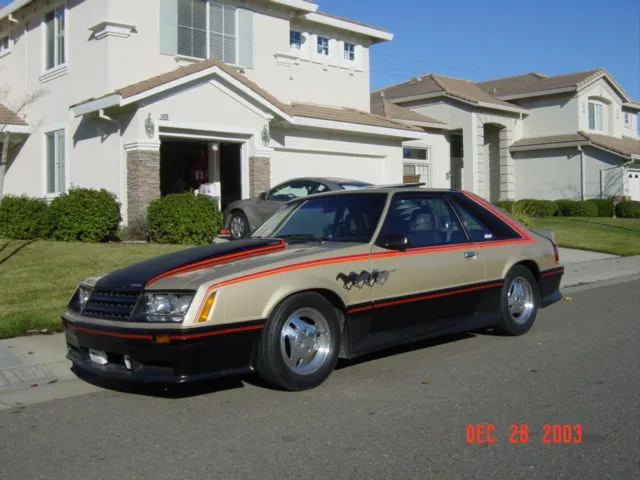

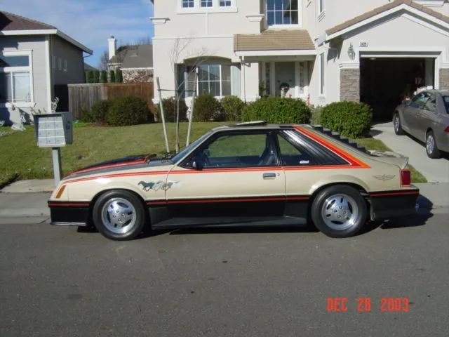

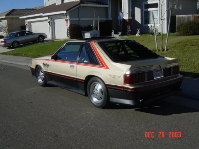

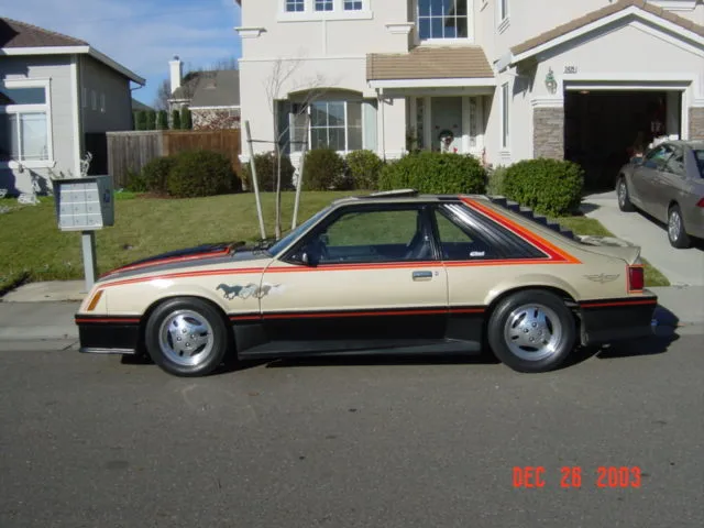

radartec said:
I lowered my car with the Eibach ProKit springs.
Even so, I STILL have to watch myself around
speed bumps. With Sportlines, I could only drive
the car around speed bumps.
Are you sayin the SportLines are lower than the ProKits? I was really
confused about which one was better for the street.
I was wonderin how my car would look lowered with 15" 10 holes. Your
3 spokes are actually metric, but they're real close to 15", rite? Mine mite not
look too bad lowered, then. I'm hopin I can get 225's them without too
much problem.
The '79 Pace Car is one of the best lookin Mustangs ever made(imho), but
you've added some subtle G/FX (which Ford should have done anyway) &
made it even better(imho, again). I would loooooooove to have one.
Hmmmmmm... maybe I could paint the the tire silver rite around my 10 holes
& make them look like 17 inchers from a distance.:D
