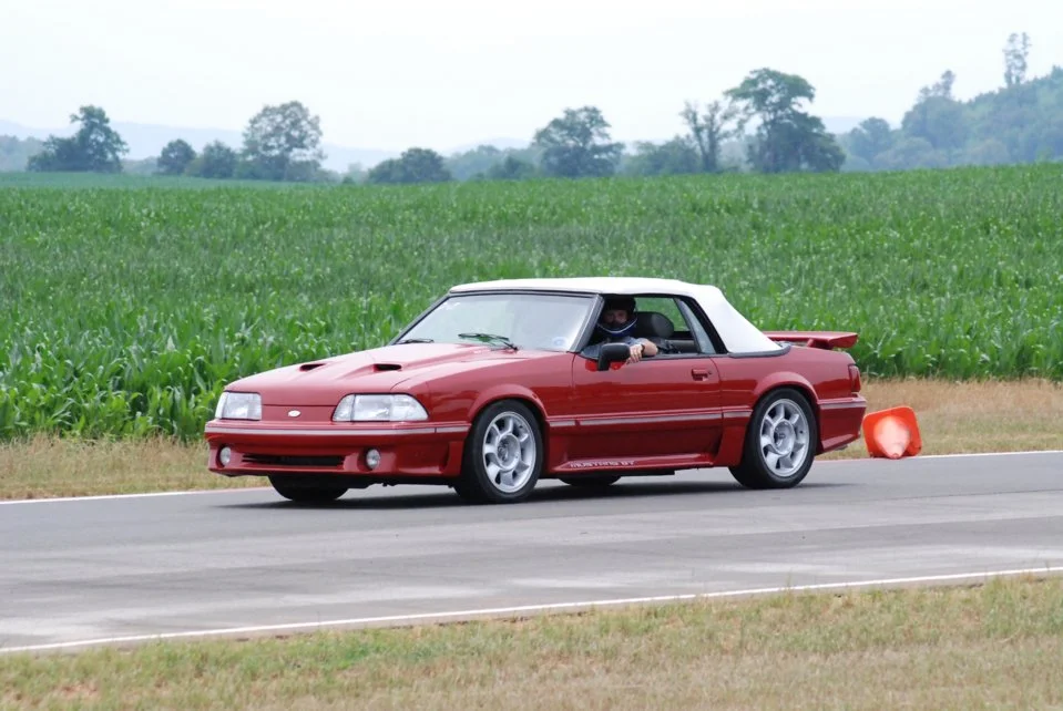

B springs have a nice stance but the ride is a little rough! For the money they are a great value and you'll really like them. I later got a good deal on some used Saleen Racecraft springs so I swapped.
But, for your info here's an old pic of mine when it was riding on the B's. Disregard the fool behind the wheel.:p
