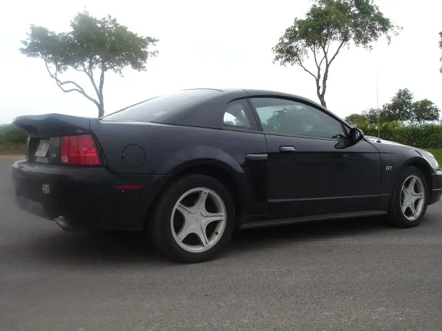

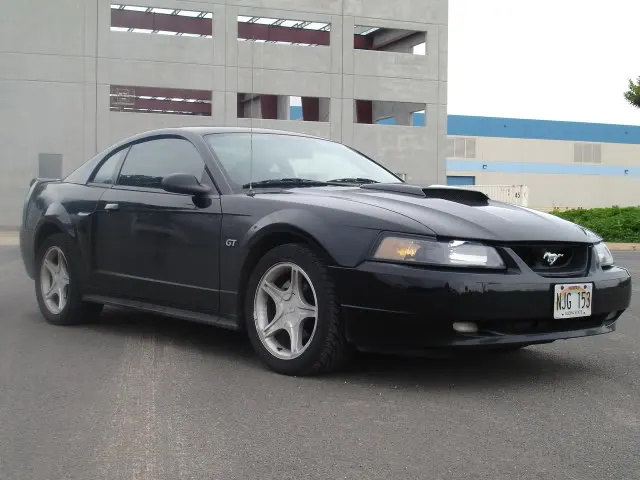

I'd like a lower stance, but I scrape enough as it is.
