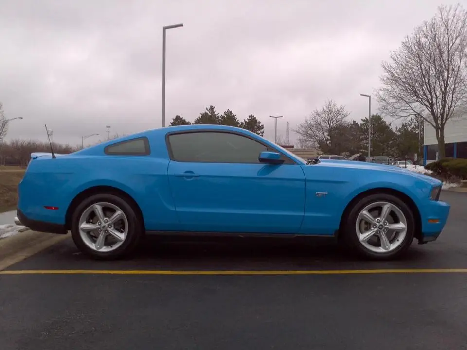

Hi all,
Noob here (1st post). I bought 2010 GT this spring and am starting to do little things here and there on it. It had Magnaflows on it and a saleen grille will be here this week. I am looking at lowering the car. I am looking for opinions regarding the following two kits and also what a decent price would be to get them installed (not too handy mechanically). Thanks in advance.

Nice car! Lev me some Grabber Blue!
