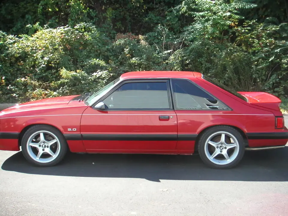

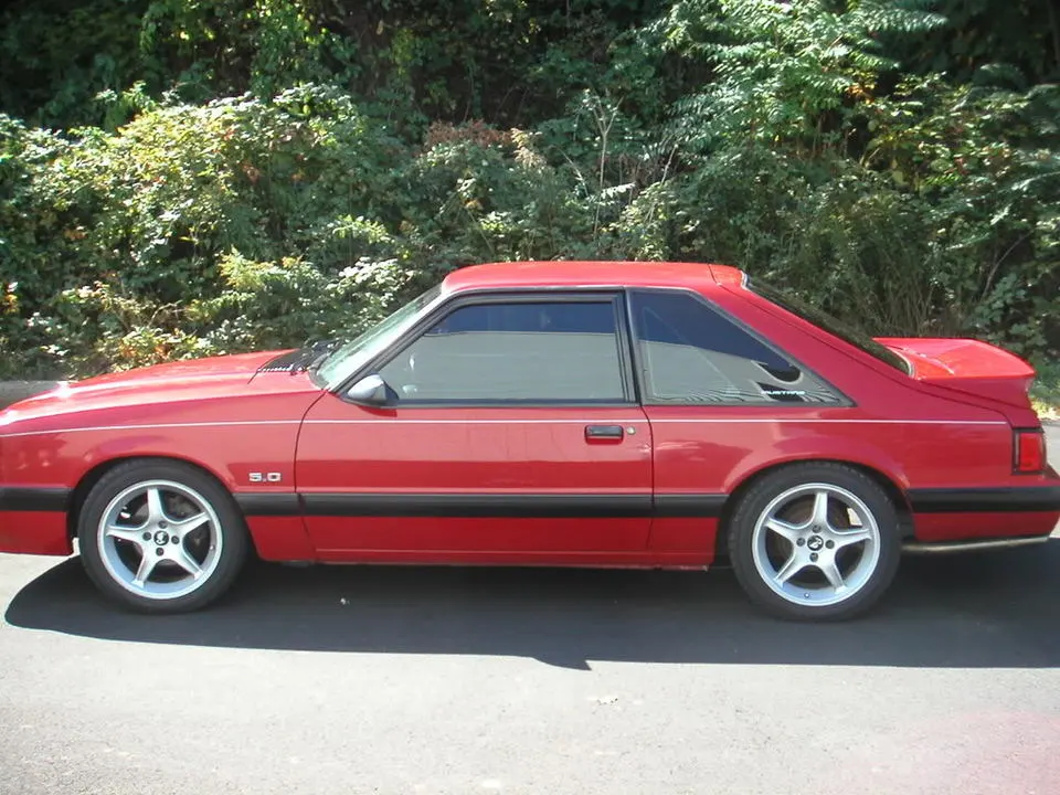

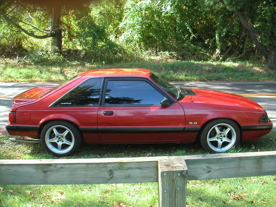

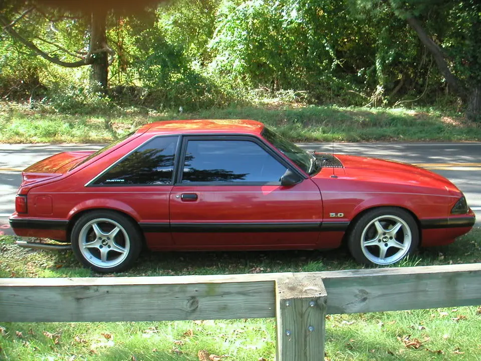

I've got the sportlines w/ no cc plates or bumper steer kit .
norrin302/Als Stang - Page 1 - Photobucket - Video and Image Hosting
personally, they look great but i wasn't happy with the rubbing and ride quality. i have koni shocks/struts so rebound and absorbtion (if that's really a word) were great.
front rubbed horribly with 17x9s up front. i've had them for 7 yrs and drove the car maybe once a month at best.
I just put on the eibach pros and they're better.
hope this helps.
Al
