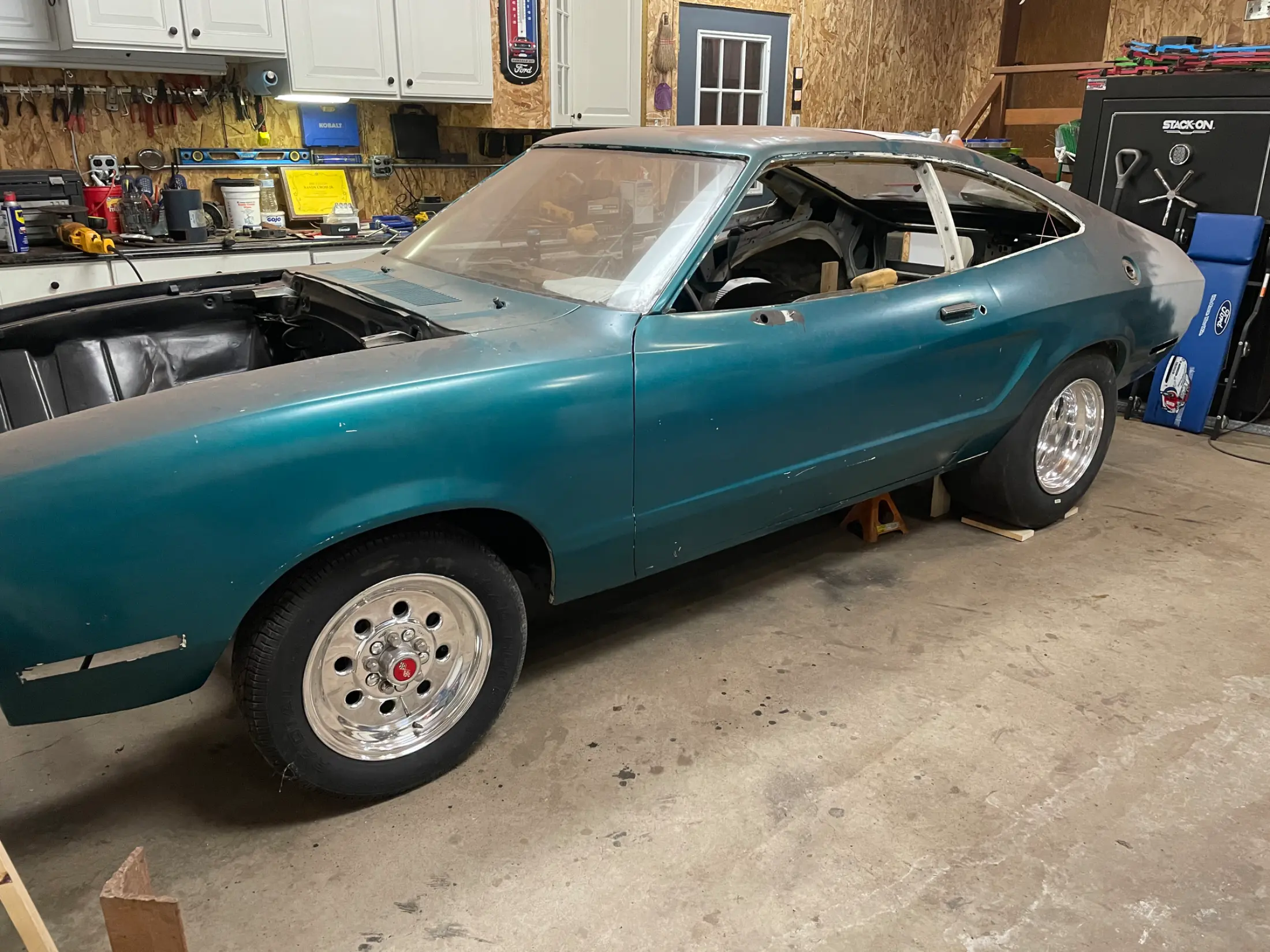

The front end has coilovers with 5 lug rotors, 5x4.5" ford pattern. The wheels are 15x5 us101 indy and skinny tires...can't remember the size off the top of my head, but look awesome like a 70's gasser or drag car. The rear (haven't gotten there yet) i'll either have to send the axles out to have them re drilled, or thinking about getting cut to fit 5 lug.

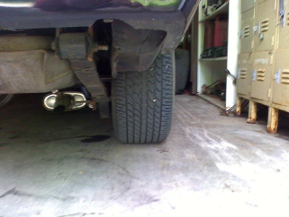

I run 15x8 with 265/50-15 in the rear and it's tight.

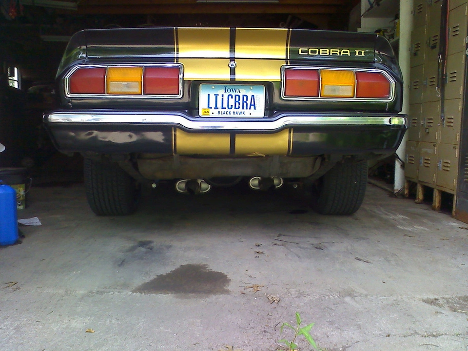

Yep, page 9 of the thread I referenced earlier:
LILCBRA said:

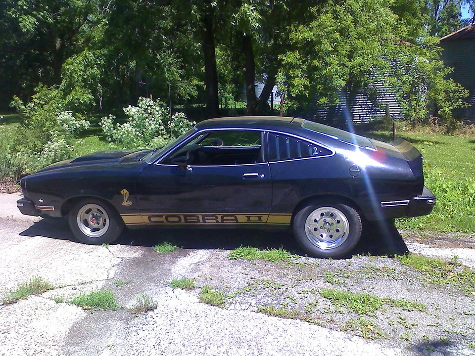

Alright-I FINALLY broke down and bought the new wheels and tires, well rear tires as of right now. I don't have the fronts yet, no one has the size in stock (165/80-15's on 15x4's), so they will have to wait until next weekend. But, I have the rears- 15x8 with 265/50-15's. I have to say I love it!! Anyways, since there are only a few pics with this size, I thought I would post the few I took of mine earlier today. Sorry for the relatively crappy quality-I took them with my phone. If anyone is interested, I can take a few more with my actual camera.
Or, how it currently sits - with the same old tires. It's about time for some new shoes on the old horse - I've been eyeballing a set of Nittos for the rear this time.

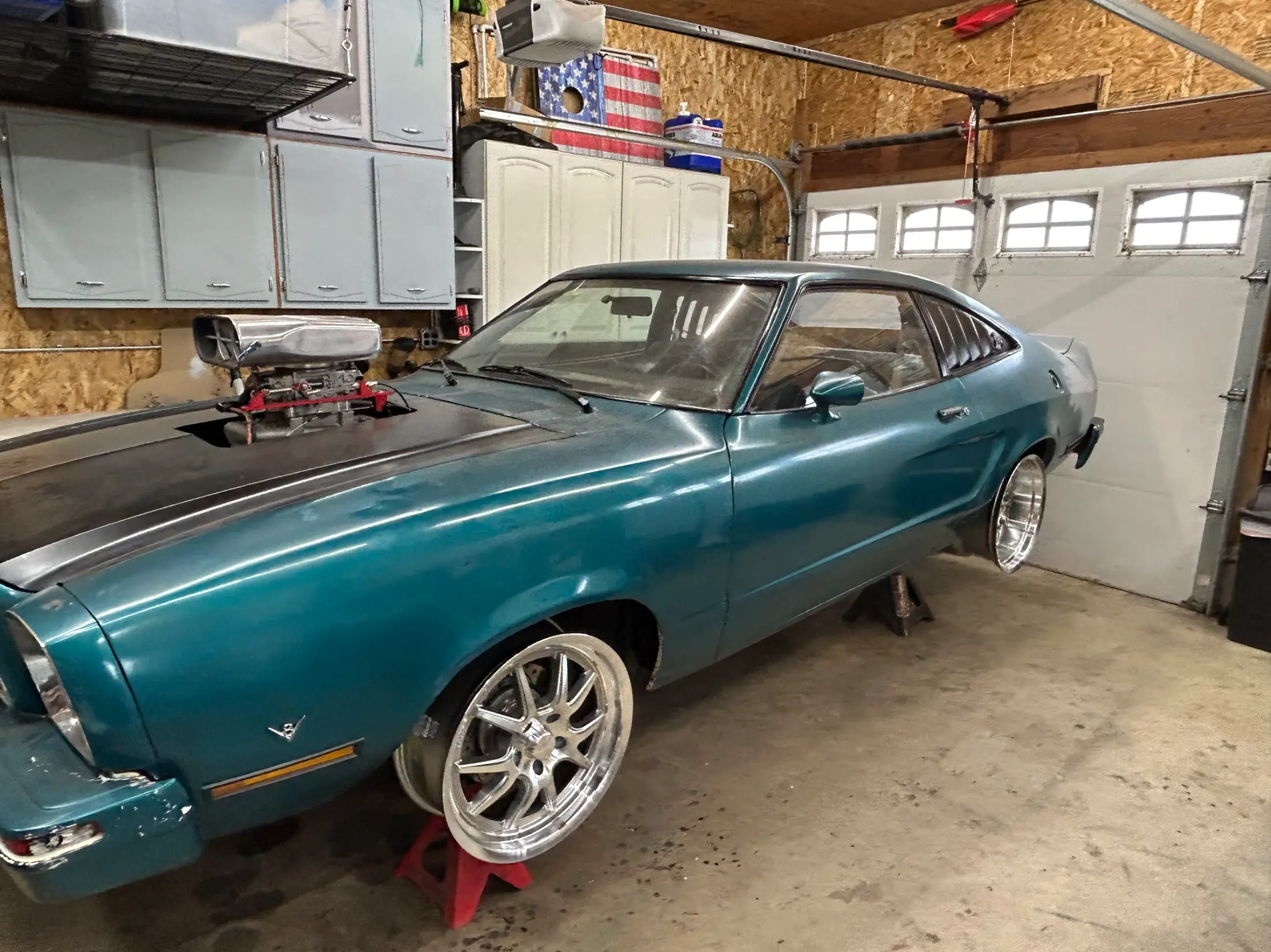

I would highly recommend going the 8.8 route versus the nine inch. The 8.8 is plenty strong for a street car. I put an 8.8 in my sons 62 F100 with a turbo LS swap. It holds the power just fine.
The 8.8 is also much easier to cut down yourself because of the flat straight pipe style housing it uses. I cut my own in my garage and used angle iron as jigs to hold it straight when welding back together. I’ve done this three times on 8.8 rears with zero issues so far. Also, you can get two left side axles out of the junk yard and that saves a ton of money on custom shortened axles.
15X12 look amazing on these cars.
Here’s mine with weld 15x12 wheels on it.

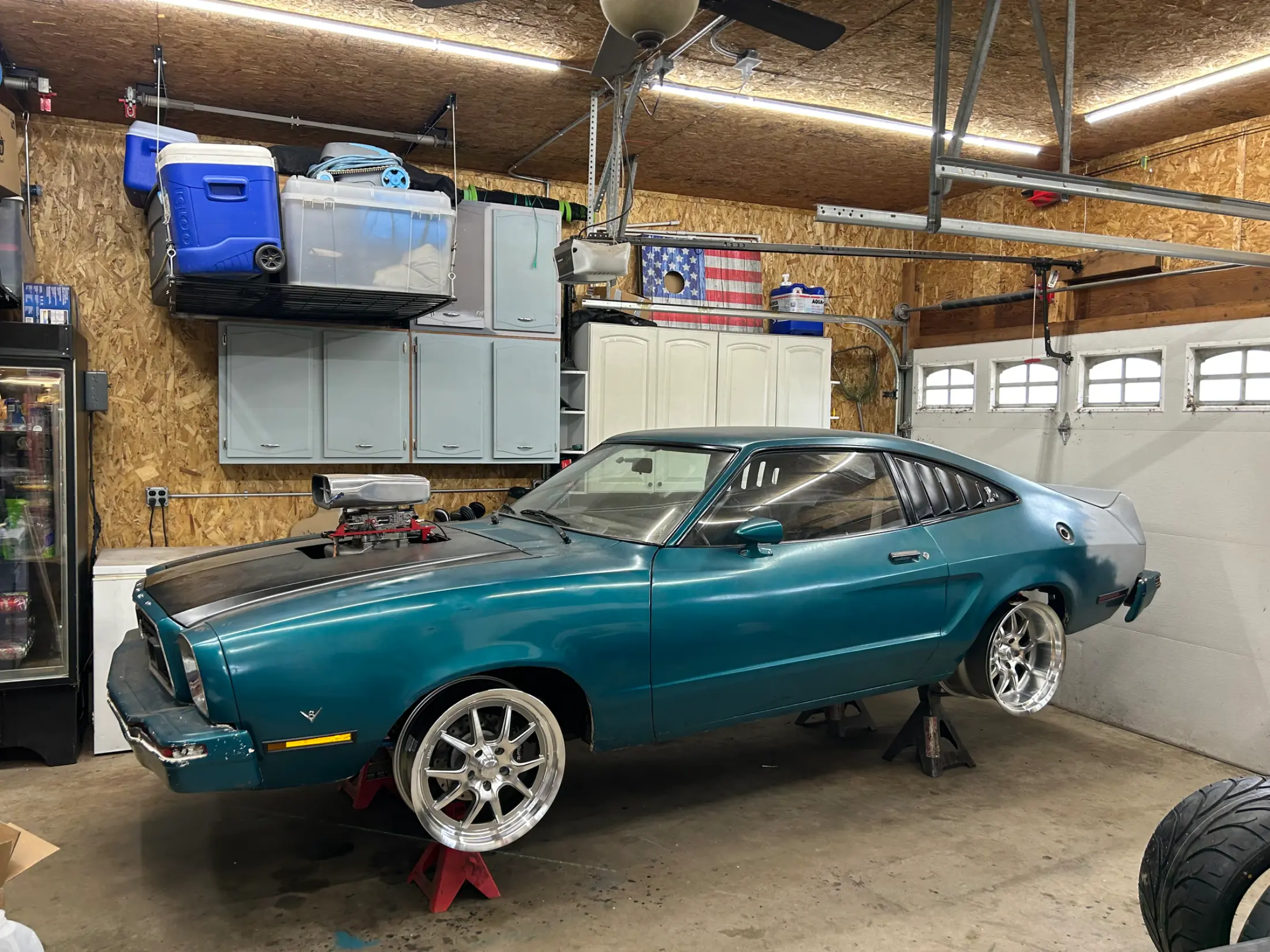

If you want a less drag race car look. Here’s where mine sits currently with 18x12 rears and 18x7 fronts. Just waiting on the tires to arrive.
