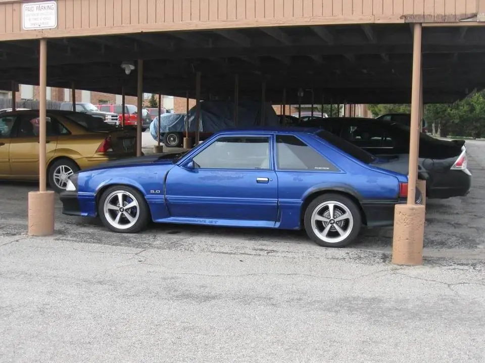

Mach 1 wheels on my car
Thanks for the complements guys. I once I get settled into my new house, I'll start tearing the car down for body work. May wait till the end of summer though, would like to get a 10 sec slip out of it before I tear it all down for paint.
For the front Im putting 96 GT brakes on it, I picked up the spindles, calipers, rotors, lines with new pads for $150. I would of rather had 94/95 stuff but I got the 96 stuff dirt cheap. Right now the wheels have 245/45/17s on them, They seem to tall for the front since I have it really low on coil overs. I want to put 245/40/17s on the front then 275/40/17s on that back.

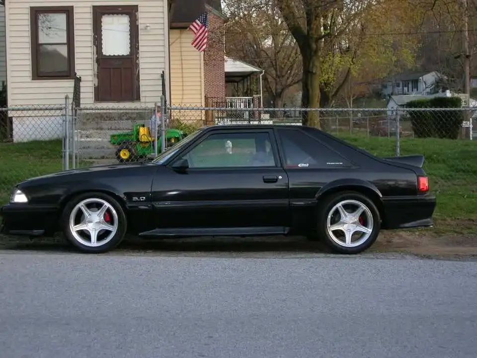

The Mach's look good on the foxes. I was going to put a set on my 93 but never made it past the freebie New Edge GT wheels.........

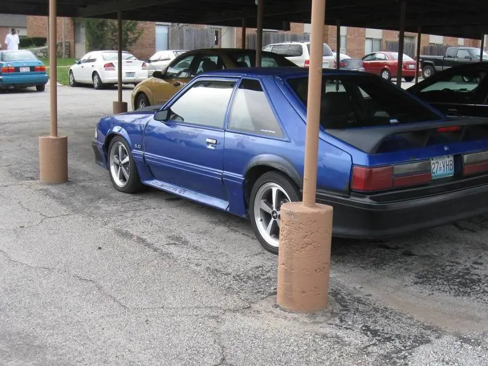

Quick-That guy should be shot and in the future when you sell a car you have to prescreen with us here on SN ;) That way we can stop another fox from being treated like that... :nonono:
Yea that car was HIGHLY mistreated after Bill (quick91LX) owned it. There were some good things and some bad things done to that car after bill but the bads out did the goods. APC Racing seats - bad, He thought he was putting in a lightweight flywheel in it when he put in a 28oz flywheel. Weeellll lets just say the engine had a pretty bad engine vibration. It does have a centerforce clutch, and a 3550. The idiot like knawed a hole in the rear body panel for the battery cut off switch.

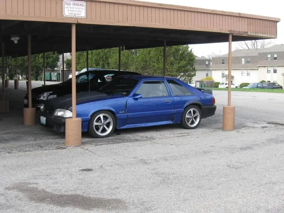

After runing around for a week with mach 1 wheels on the back and Pony's on the front. I finished up the front 5 lug on my car wednesday. Still going to raise the front up just alittle probly another 1/2" just have to turn the coil overs up alittle..

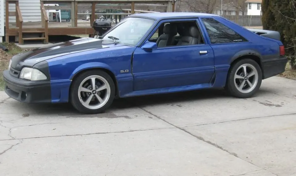

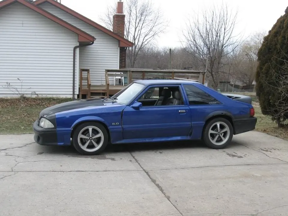

Pretty old post, I was still living at my apartment then.. my car still looks the same, its had 99 cobras, 04 bullits, 18" chrome bullitts and pro-stars on it since then, but has Mach 1 wheels back on it now. Couple newer pictures (about 6 months ago)
I have droped the rear about 1.5" and raise the front alittle since the pictures...
