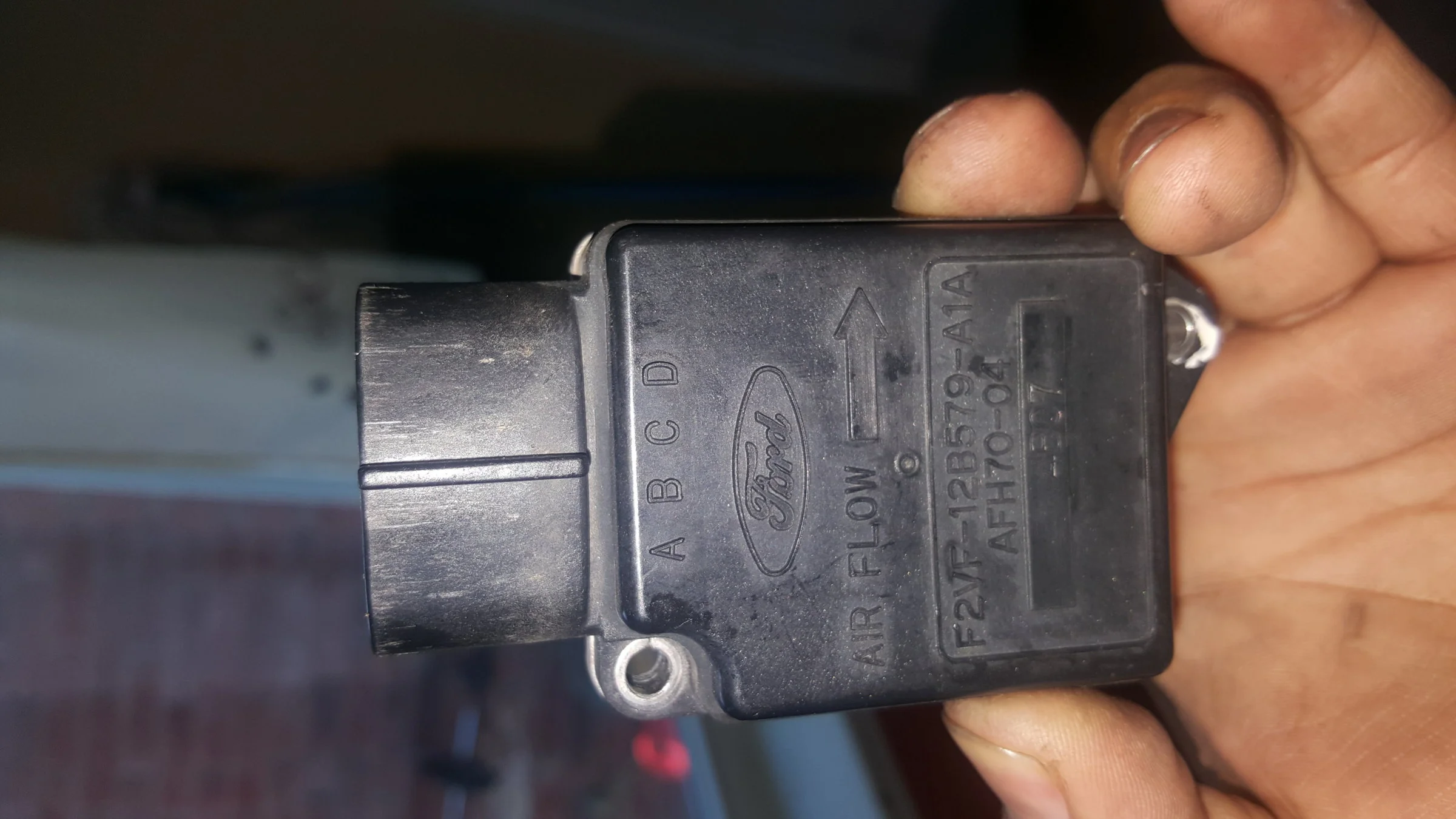

You may be able to buy a maf sensor from the parts store, I have read a couple threads in other places that had the wrong sensor in a 95 maf. Make sure it has the 2 and not the 5, I don't know if the maf you got was a replacement unit or what. Maybe you should compare that maf with another like from a crown vic or town car 92-94 4.6

I tried this also with the v6 maf and when I switched it I noticed at the track I was having a hard time getting the same mph that i usually topped at. I was 1-2 mph slower if I remeber right and I thought to change the maf back to the original one and then it went back to my normal mph... Could of been a coincidence but I just kept the original one on. I'll just get a bigger aftermarket one if I get bigger injectors one day.

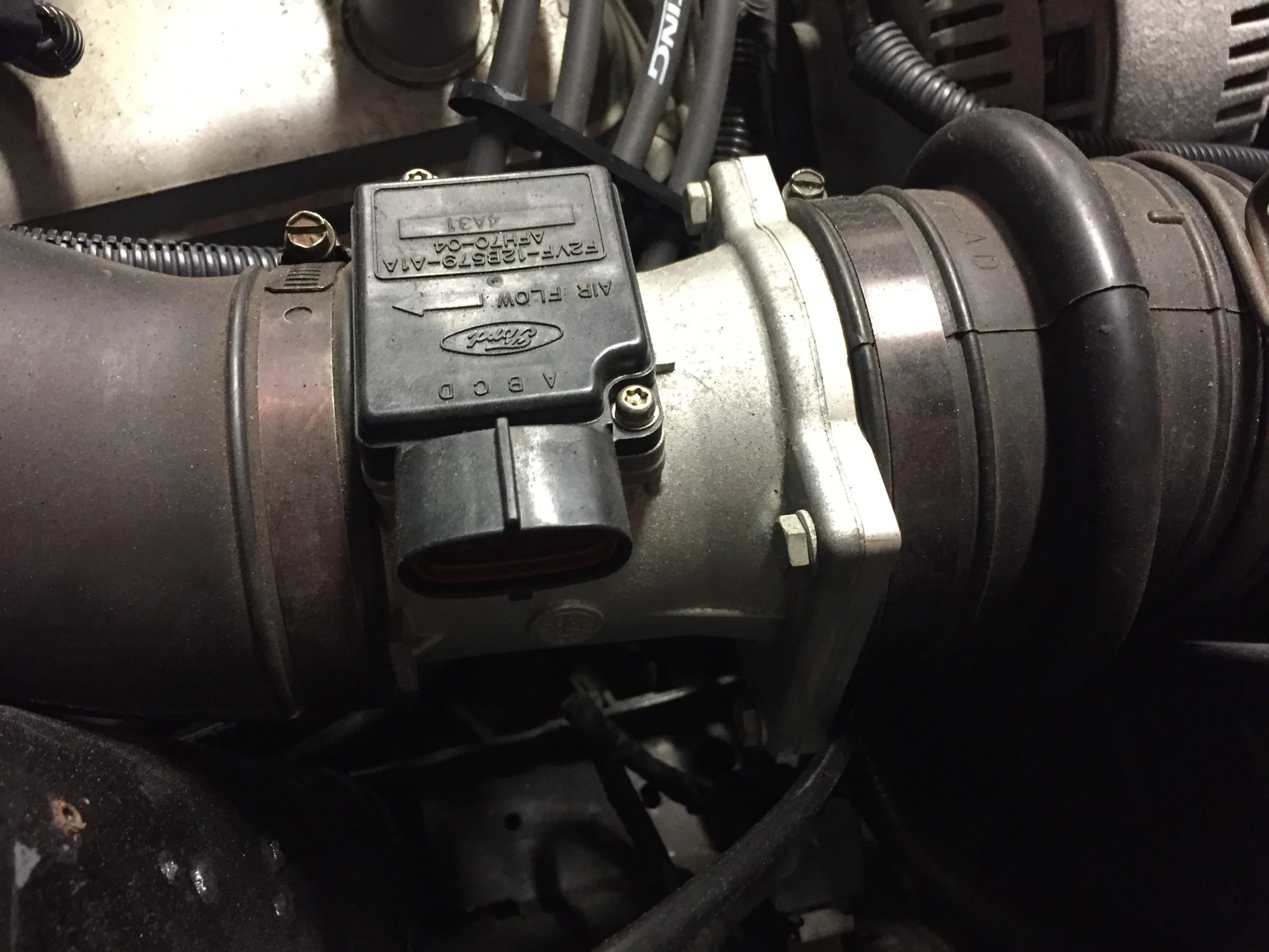

So I finally found the right part # in going to put it on the housing that I already have from the 94 mustang and I hope everything works fine ..
Fingers cross..

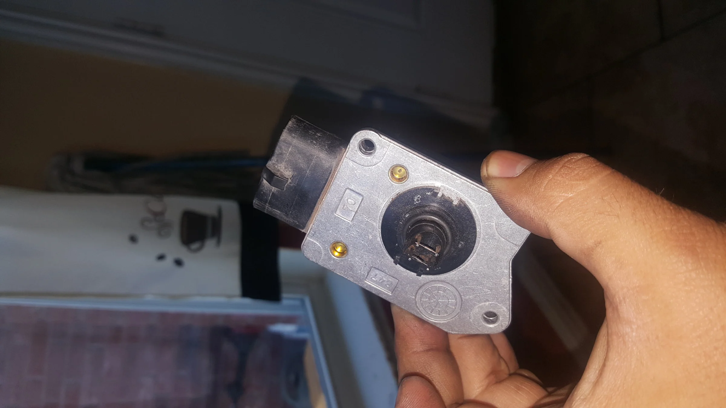

uh you don't swap sensor from different housings. The sensors are calibrated for the housing. It may or may not impact the A/F ratio.
Not understanding why you don't just install the entire MAF housing and sensor as a unit.

He has the right sensor for the housing he has.
The sensor shown, and the housing shown will work together.
