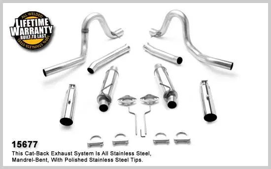

Thanks for the doc, thats the one they had in the box. I put the longer tube on the passenger side as pictured. Also, i found it way easier to assemble the thing from tail pipe to x-pipe, opposite of what the instructions say. Once its connected to the x-pipe with bolts even loose its impossible to rotate. I left off the xpipe bolts and i can pull hard to get off the flow pipe to rotate and try again.

Its all the same under there... I would say its the hanger angle I remember this kit we did last year, they had a bad batch and you may have gotten it. Dont bend the hanger at the muffler, change the angle of the top part, push it downward I believe and that will change the angle of the muffler. I think I remember is was like somewhere around an inch we moved it down.
Look a the picture you may be able to see what it needs to bend down..
Funny, my hangers don't look like that. I took some pics. You can see in my first pic.
