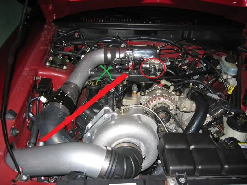

Are you guys telling him to hook the iac hose to the powerpipe? That would cause unmetered air to enter the engine since the maf is after the powerpipe.
