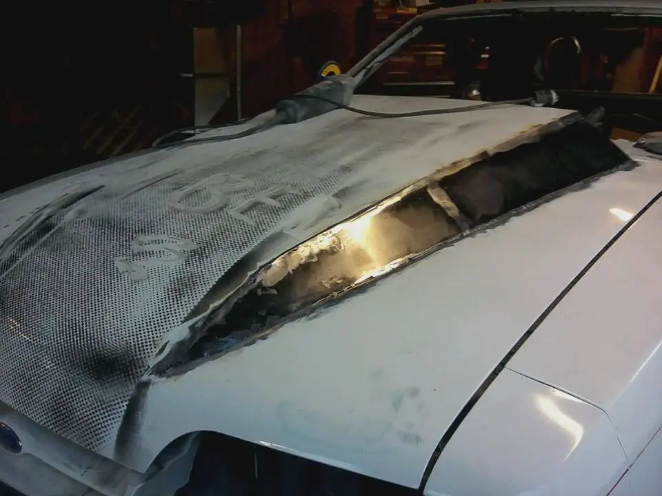

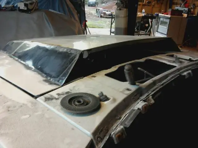

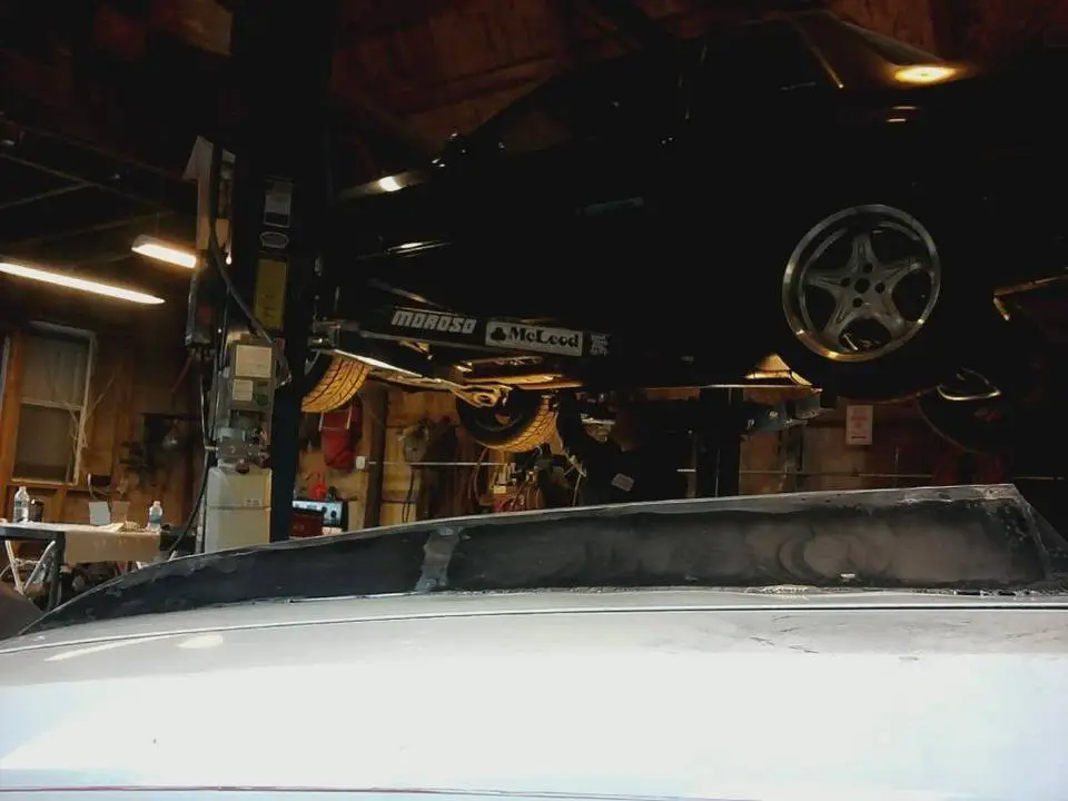

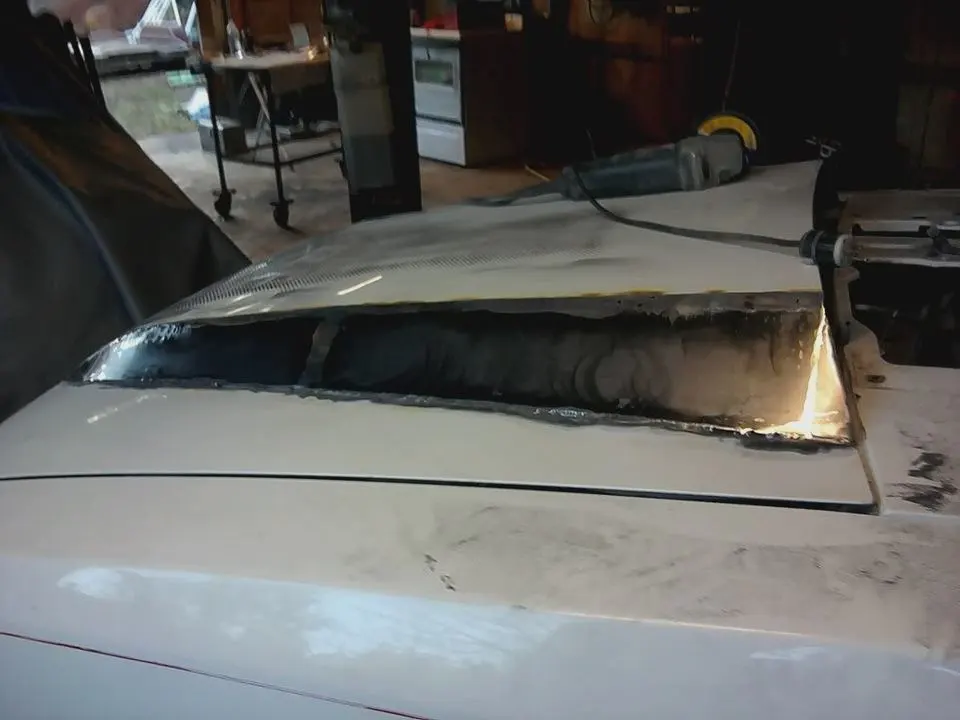

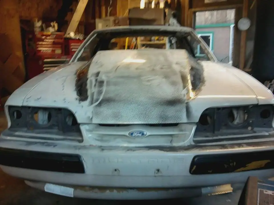

Tired of the crappy fit,finish and the fact the one i have isnt big enough!Plus the fact i like to do all my own stuff,and i figured i'd saving myself atleast $500!So i took a stock steel foxbody hood and i am making my own cowl hood.It's a 4" cowl and is all steel.This way i can use the stock latching system and will clear my engine!I made templetes and then cut out my owm pieces out of sheet metal to raise the cowl.It isnt all that heavy and this is the fab point of it.I need to bondo where nessary and smooth it all out,then prime and paint it!LMK what ya think so far?peace

that looks great i was thinking about this the other day looking at a bunch of the new hoods on the newer ford cars .i thought of how is easy it would be to cut out a section of say a new mustang hood and weld it to our hoods.
I say nah, unless you incorporate them like the mach 1 two scoop style or were you thinking more like the scoops on the 96-98 Cobras style hoods. Nice work!:nice:
john:p[/QUOTE]
I say nah too. I looks great and you'd be amazed at how functional a cowl scoop is. they REALLY work well. Sweet work dude. Post more pics after you're done!

Thanks guys.Worked on it some today.Not sure as to what i'll do for support,as it seems to be pretty rigid.But when or if i need to stiffen it up i will post pics!Will go back on thursday to work on it more.peace
