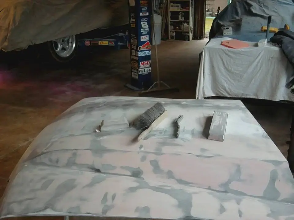

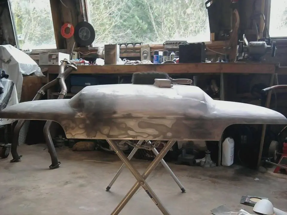

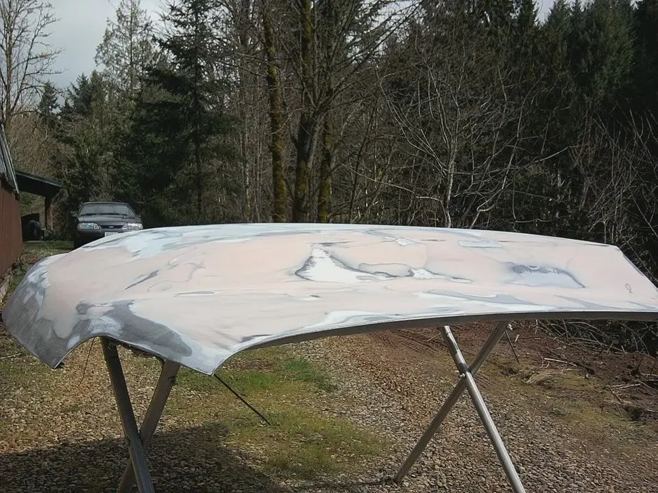

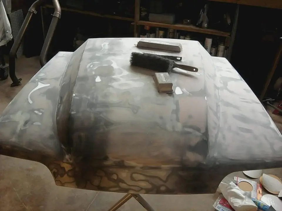

Well i went back up on monday and spent a few more hours with ben as well as today by myself.We added and sanded more bondo ben showed me this black spray stuff to find low spots,that has helped alot.Here is how it sits as of today peace:

Hey John, My buddy smoothed his engine bay and I primered and painted it. I sprayed a high build primer callled slick sand... its good stuff.....fills in good and sands nice and smooth.
I will keep this stuff in mind and have to try it out!

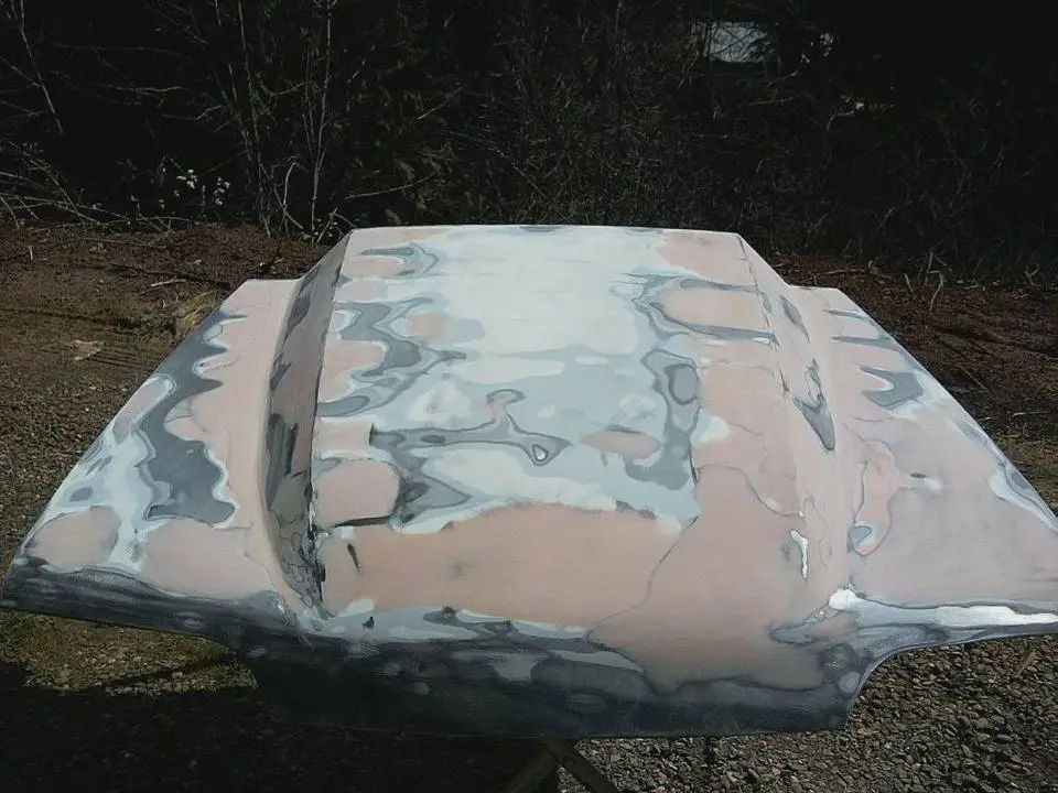

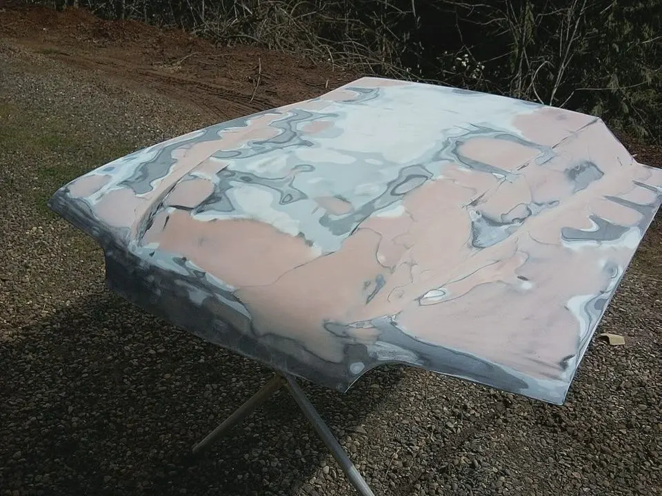

Went today and did what i thought would be the final before primer.Well i flipped the hood over and cut out some more of the underside,Then it got to hot in one spot and ****ed up the bondo so i need to touch up a spot now :Smiley 31: I will work on it tomorrow for almost all day and hopefully call it good and either prime or prime it on sunday.I also gonna do some supports and figure out the back of the cowl.Heres today pics before i messed up the bondo i had on it when i cut the underside more.Was an awsome day to work out side plus the bondo dried alot quicker.

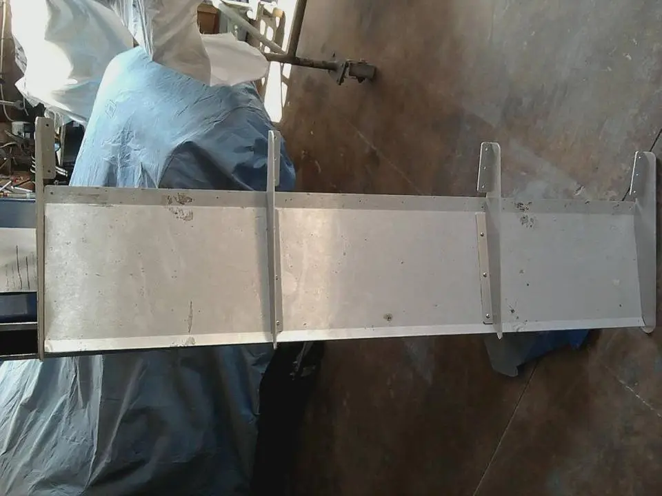

what do you guys thing of this wing instead of the saleen wing?peace
john:p
Those wings look good on cars that require it. It's a function over form kind of idea and without a chute under it and a drivetrain that requires one, I don't think it's gonna look all that great. Just my .02

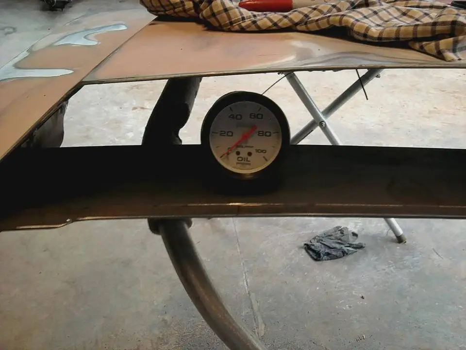

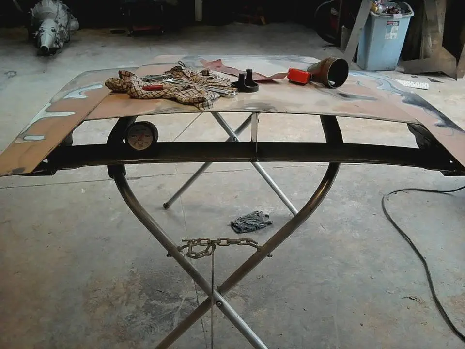

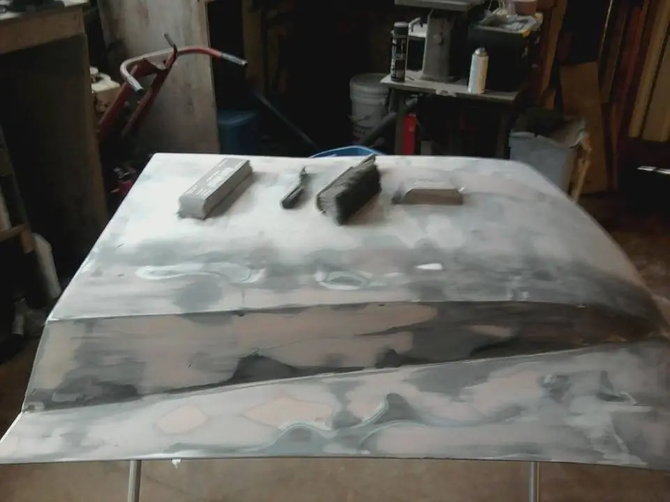

Well did more today,welded in support and made my own gauge holder.Test fitted it on the parts car,removed the pedals for my next up comming project.peace
