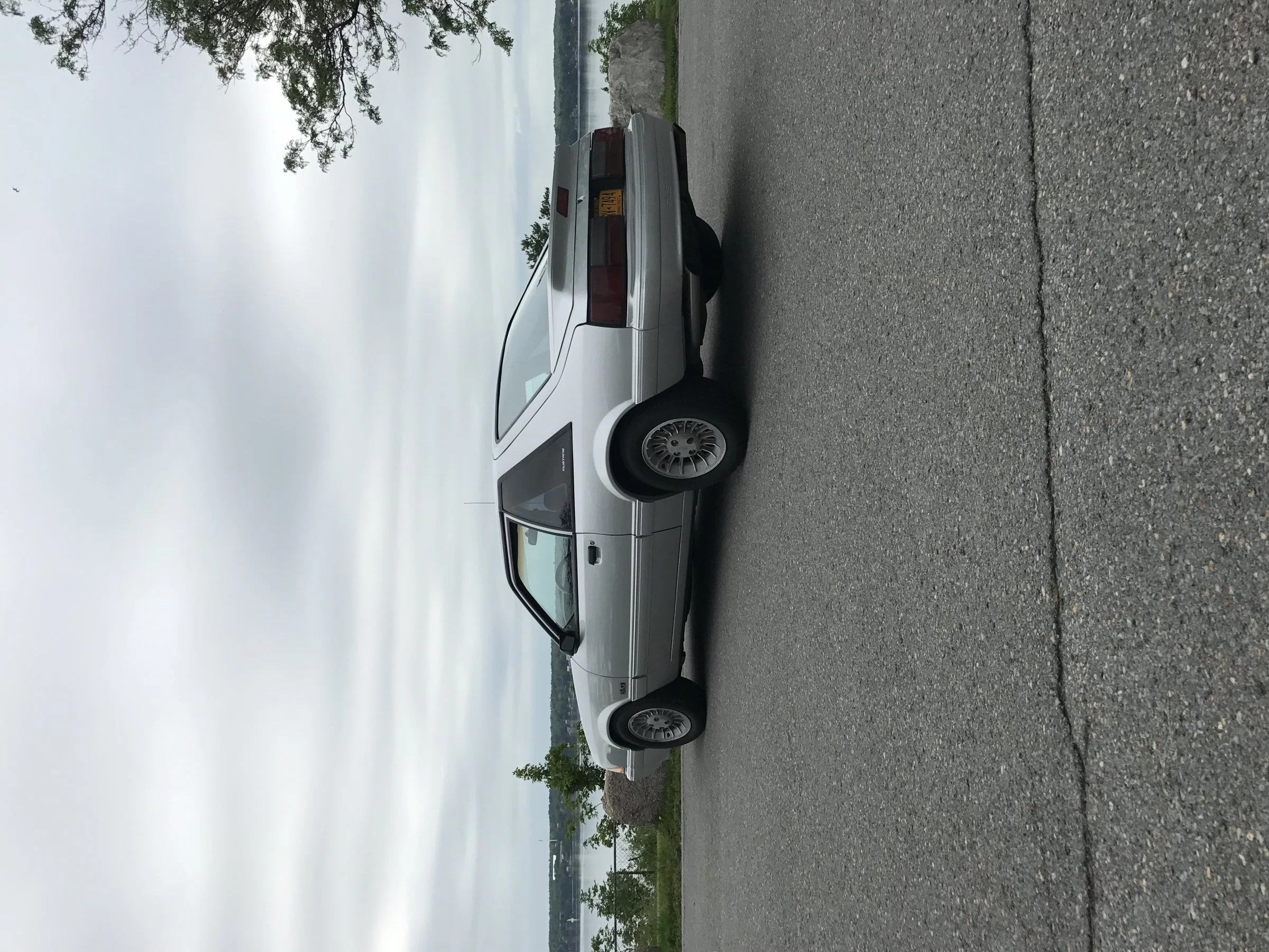

Hello,
I am new to the I just picked up my 88 LX 5.0 about two weeks ago. My Sted dad has an 88 GT. While researching first mods I would like to do he advised me before making any major enhancements it is best to convert to mass air.
My question is as follows. Is this the best course of action? I would like to slowly build the car into a fun daily for when it's nice out and a weekend here and there at the strip.
Any advice is appreciated
P.s. if there is already a thread on this please bump I did a search without turning any good results up
