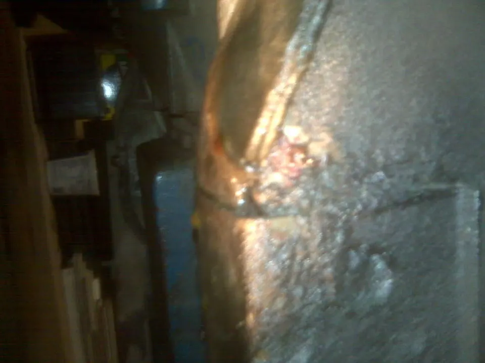

I'll try this week to clean it up really well and put the car up to see how it is underneath. It's definitely leaking somewhere cause if you look carefully at the bottom you can see the fender apron's paint coming off, and steering column is usually wet in places.

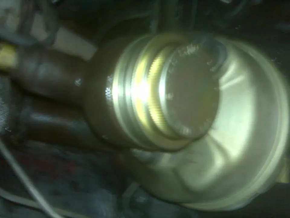

Hey guys, a little update; I took it to a few mechanics and most agreed that it was just the cap. So i went to NPD bought a scott drake repro cap, it's metal. I put it on and no luck it's actually worse it spews out, my dad drove the car for a week and i came home hte other day and turned the car on to circulate the fluids and noticed that the brake pedal goes to the floor! I immediately check the resevior and its almost bone dry. I quickly fill it up, go for a test drive and its leaking enough to drip to the floor, it runs down to the frame rail and drops down slowly. I changed the cap to the original plastic one and went for another test drive and practically none came out. Idk what to do... any suggestions?

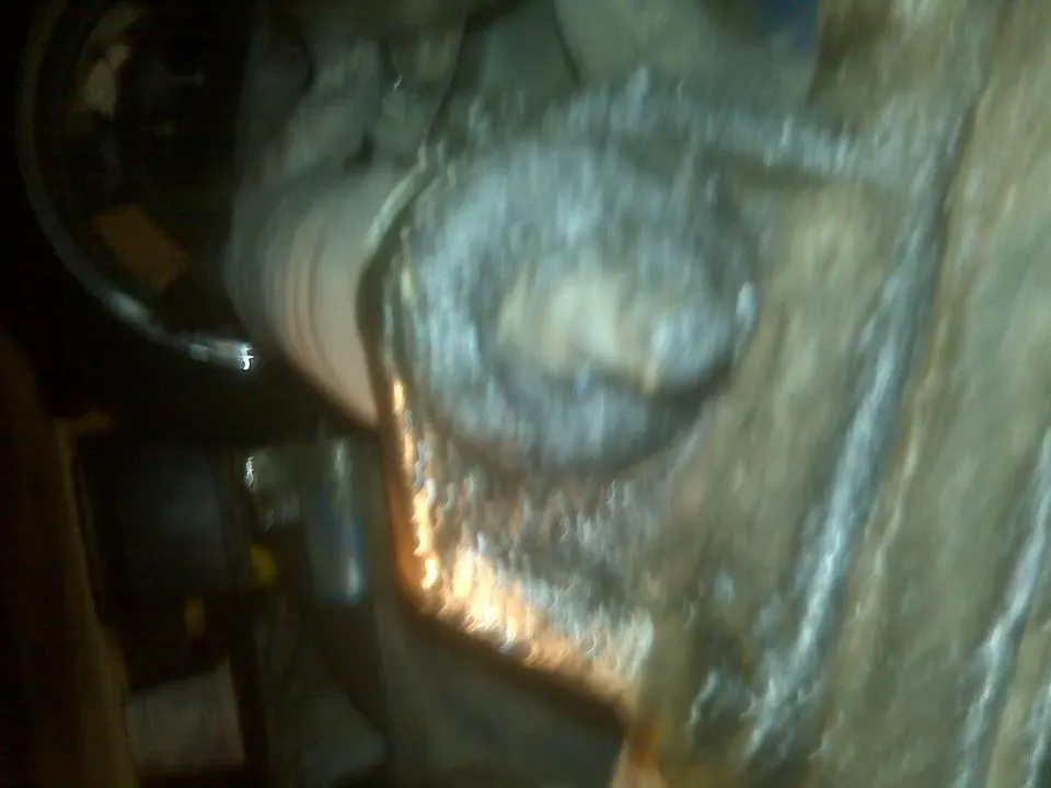

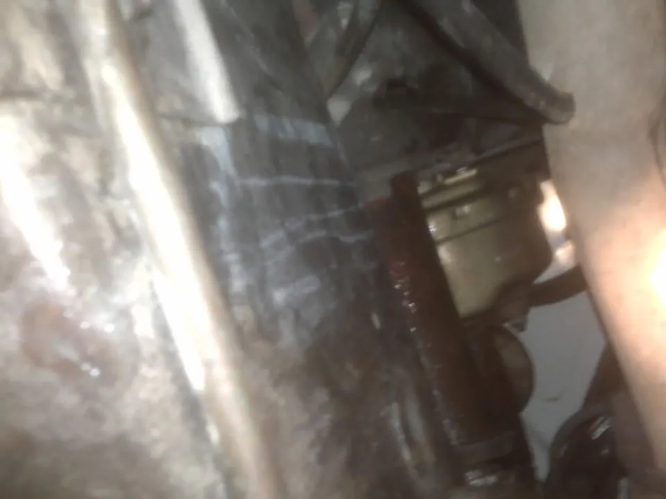

Edit: I crawled underneath and i checked the cable behind the wheel, and it seems fine, but i followed the trail of fluid and my god the whole thing is wet, the steering shaft, the side of the engine bay wall that comes down, the side of the power steering ram, the frame rail ont he bototm, and the entire underside of the master cylinder and brake booster.

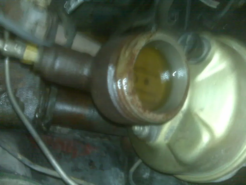

My reasoning for thinking the cap is the culprit, it looks as if its coming from underneath, when you unscrew it the threads are soaked. :shrug:

With the new cap
Without a cap on
This is where its dripping to the floor
Following the trail
Looking up to the power and master cylinder.

As for an update, my grandpa was over the other day and i told him teh problem, we popped the hood looked at the two caps and noticed the new one's gasket is flimsy as heck, we then looked at the bowl itself and he noticed that top had some rust on it, we sanded down the rust spots down a bit, cleaned it back up, closed it up, went for a test drive and gosh darn it no leak so far, i'll keep an eye on it and let you guys know how it holds together in a few weeks
