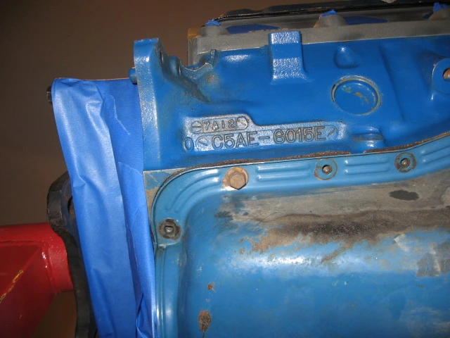

Here is an example of the engine casting #
See the little date code above the casting #? There are many web sites with conversions. It reads Jan. 12, 1967.
