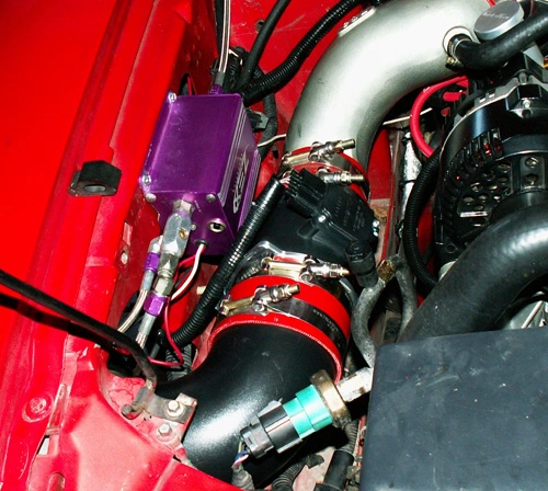

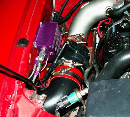

Some of us have converted over to the 90mm LMAF and have been building our own Cold Air kits. I tried a 45* elbow on my setup with the C&L pipe but it wouldn't work without cutting the fender.
I think I may have found a fairly cheap 4" elbow in a very unlikely source.
http://www.hartvilletool.com/product/11524
It doesn't seem to have the big flange a lot of plumbing type elbows have. Plus it appears pretty durable. I ordered one today. I'll let you know how it works out when I get it. I'm curious about how thick the plastic is. It's made for airflow movement (with sawdust), so it should work. :shrug:

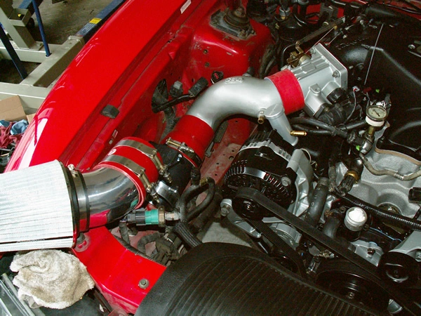

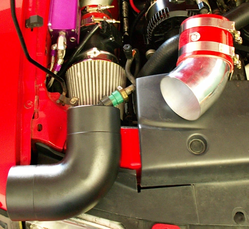

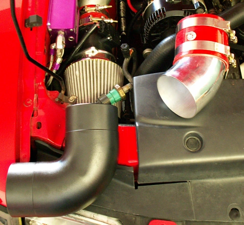

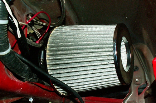

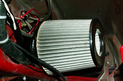

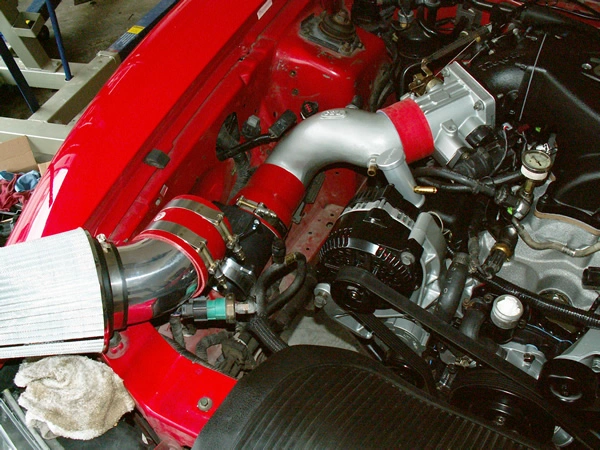

Finally got around to uploading the images. I cut about an inch off the collar of the elbow on each end. It helped make it a bit more compact. I also DID have to enlarge the opening in the inner fender a bit to make it work.
The elbow is great quality for $10. There was tiny bit to smooth out on the inside if you are picky about things. But hey, it beats $65 for some of the other ones I found.
