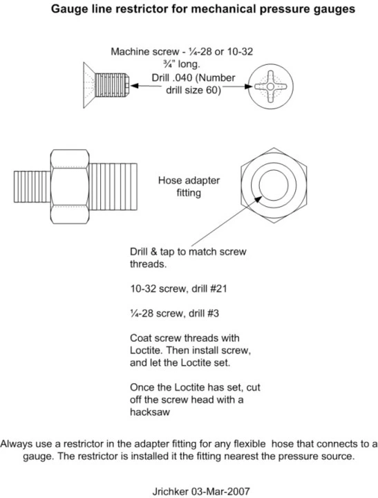

im going to do the same but was told where the oil gauge comes from to make a piece that goes in to stop all the oil from coming out if the line breaks.

I like that restrictor idea. I currently removed my OP gauge because i was running nylon for 2-3 years and didn't want to push my luck.

I might use the restrictor setup with copper line. Depends on how easily i can run the copper line without kinks. Stainless line just seems too big to get through the same hole i am using for my mech water temp, some wiring and a boost gauge vac line
