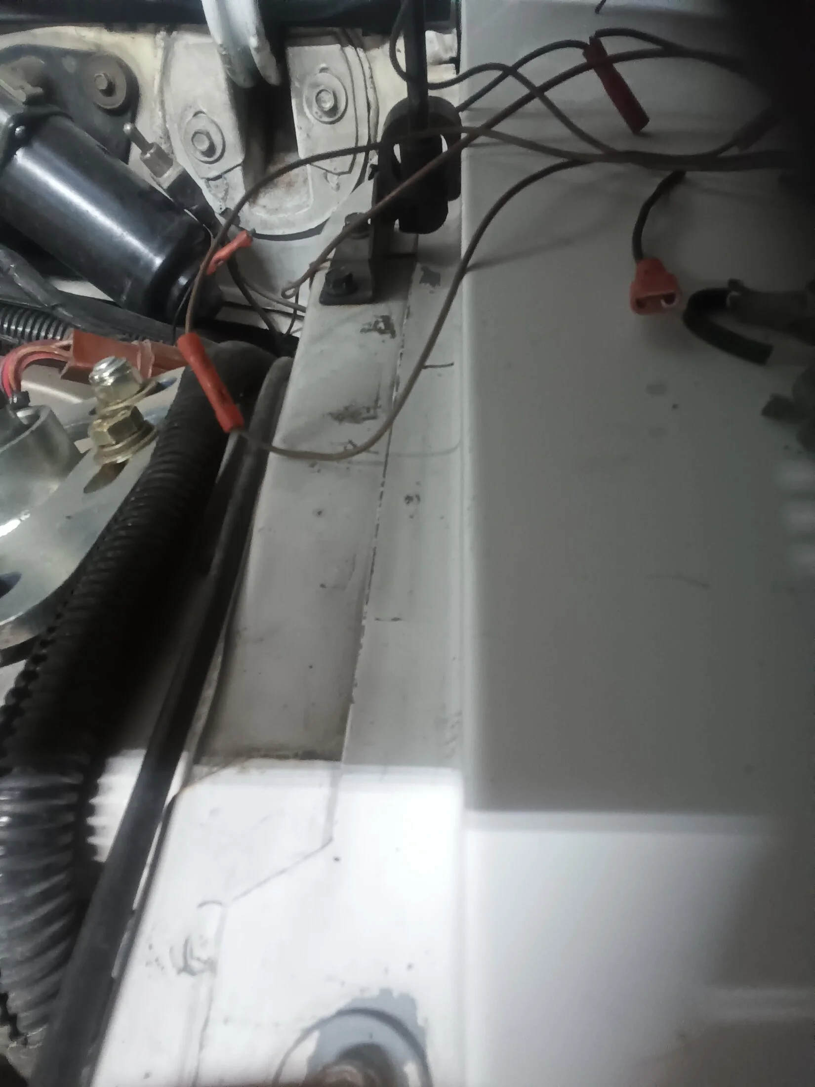

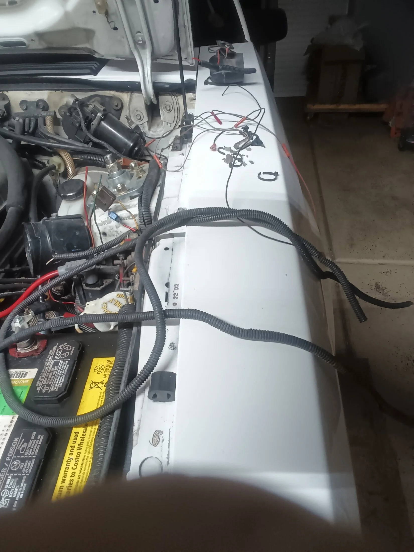

I got my stang with two alarms under the hood, I guess whomever installed the second one didn't think of removing the first one, and I just left all that spaghetti there since I bought her.
So lately I got intermittent gremlins, stall,no start. I'm getting this cleaned up so I can eliminate that .
Hope a ( new to me) coil connector helps stop my issue. Removing the non op alarm,
And there is a kill switch I never use so that's outta there too.

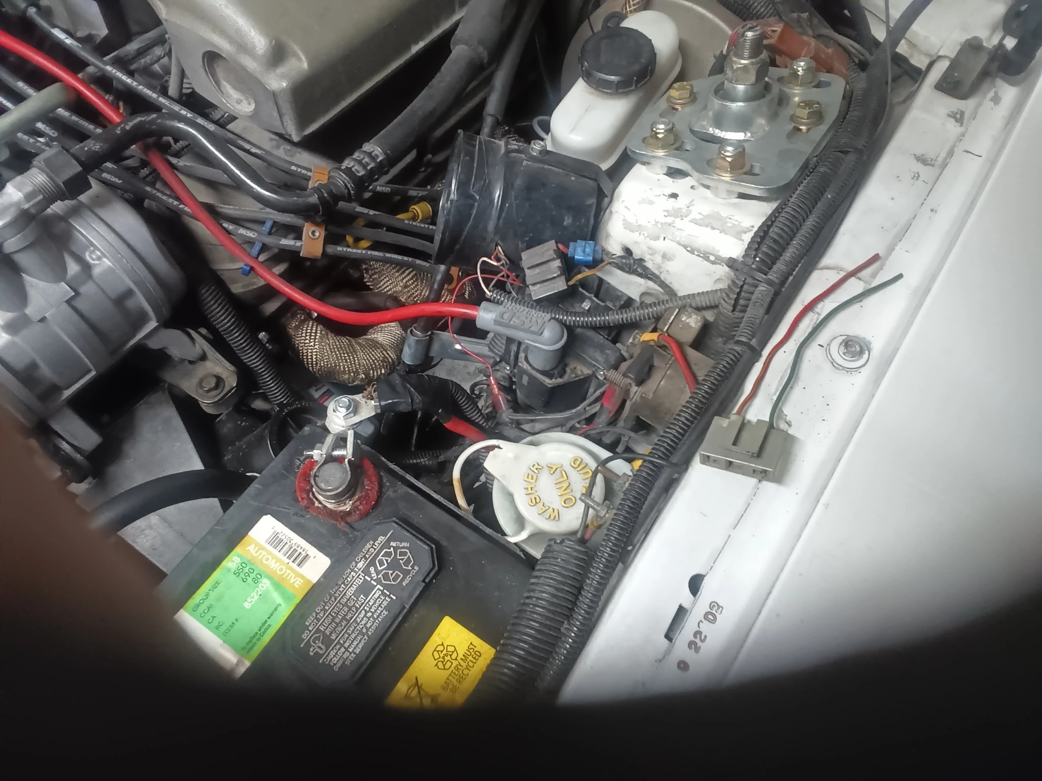

Got a coil plug from the junkyard yesterday, cars were so freaking hot I couldn't pull any modules .
New to me coil plug is in. Car starts and idles good, drives with no stalling ,Thank God.
The alarm blinks the lights but the chirp doesn't chirp no more. Its got power and ground so ill live with it as long as it stays running .

Cut the zip ties off and it only stalled twice, once in the parking garage and then just outside the garage.
The rest of the way home was good. New Motor craft switch should be here by Friday.
