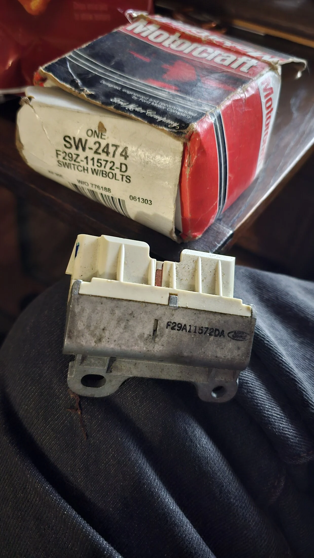

Any who I just found the receipt from 2014 for the ignition switch, AutoZone still gave me a hard time warranting it out but I got one,now to marrow ill install it and see. And I found the receipt for the tfi module from 2010, when O'Reilly's use to be Checkers. Ill get a spare tfi.
Karthief laughed at me the other day when I said I had found a New-In-Box ignition switch in some old junk and it was better than finding money in an old coat. :shrug:
These things have voodoo. If you have a spare, then yours won't eff up (unless the spare is Chinese then ur fkt).
The AutoZone one is duralast and probably Chinese,the motor craft coming from rockauto is made in Mexico.
Nothing American about strange these American parts.anymore
Fugging new switch is in, started right up,idled for five mins. then cut off.
