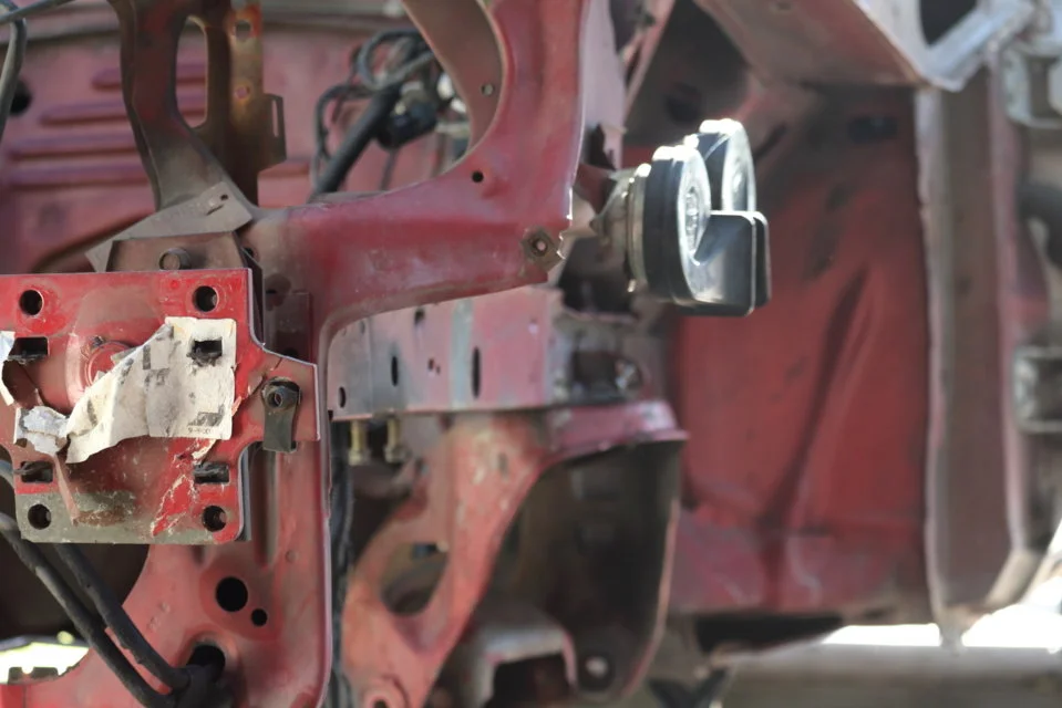

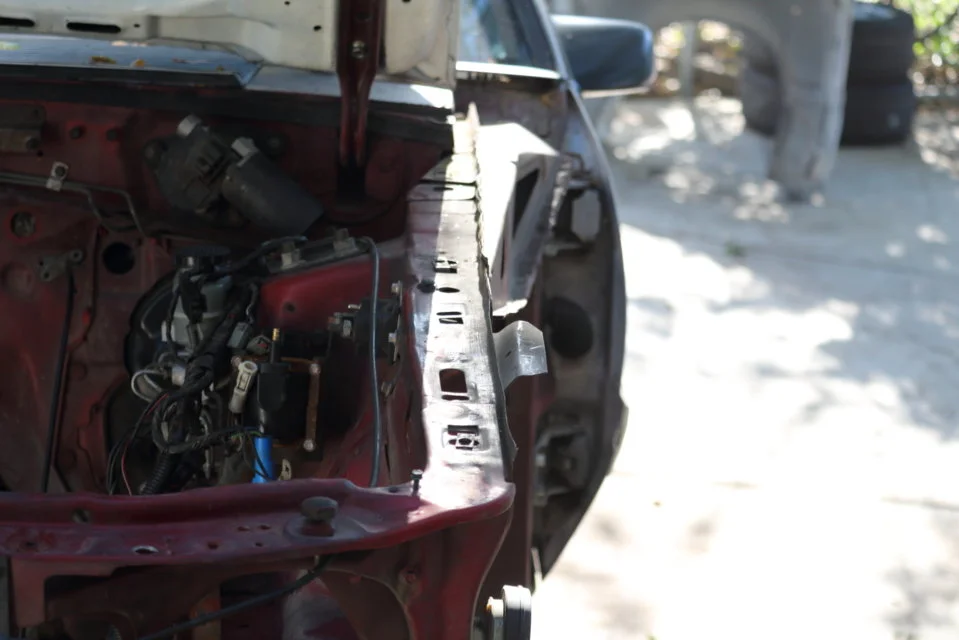

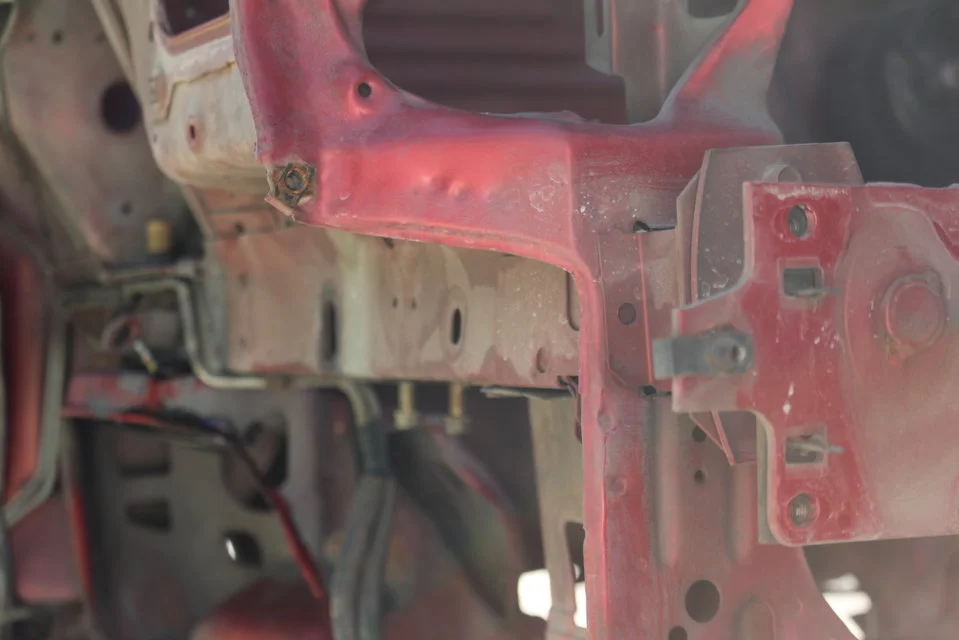

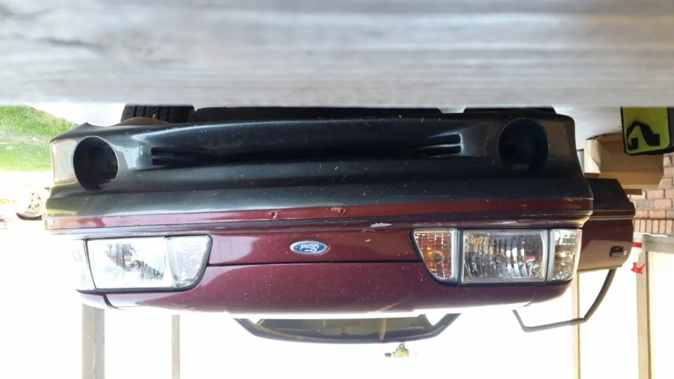

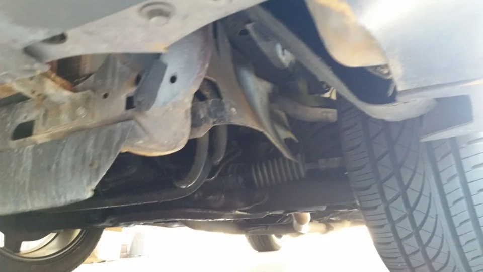

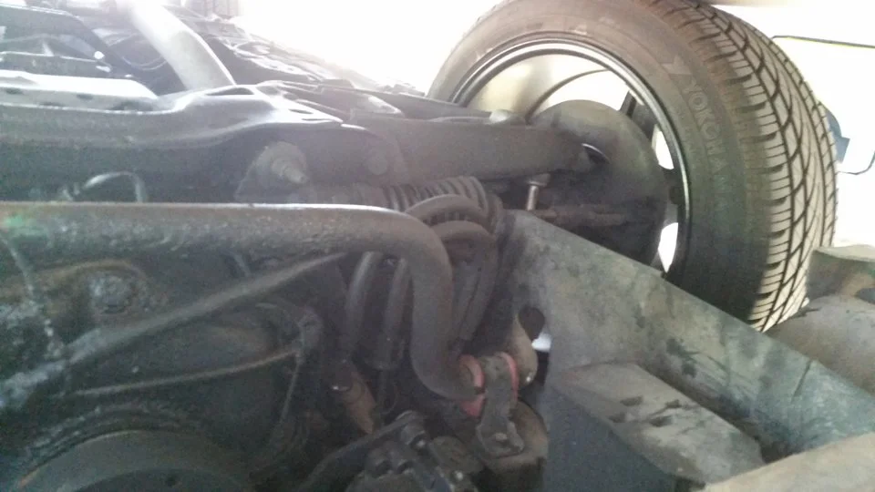

I took some pics. Hopefully this helps out. Thanks again for the help.

If the car was hit hard enough to bend the K-member I personally wouldn't spend any money on the car. There will be signs all throughout the sheet metal that the car was hit fairly hard. Once metal is bent its near impossible to get it back to its original shape. When I get home I'll take some pics of stuff to look at one the frame but I think your issue is probably something else.
I am thinking you have worn shock mounts and caster plates but even with that scenario 3-4" is huge. At this point I would take it to a collision/ alignment shop and have them put it on a rack and diagnose it. That is a severe level of inconsistency and if it was hit hard enough to cause that kind of damage there wouldn't. be two panels on the car that line up.

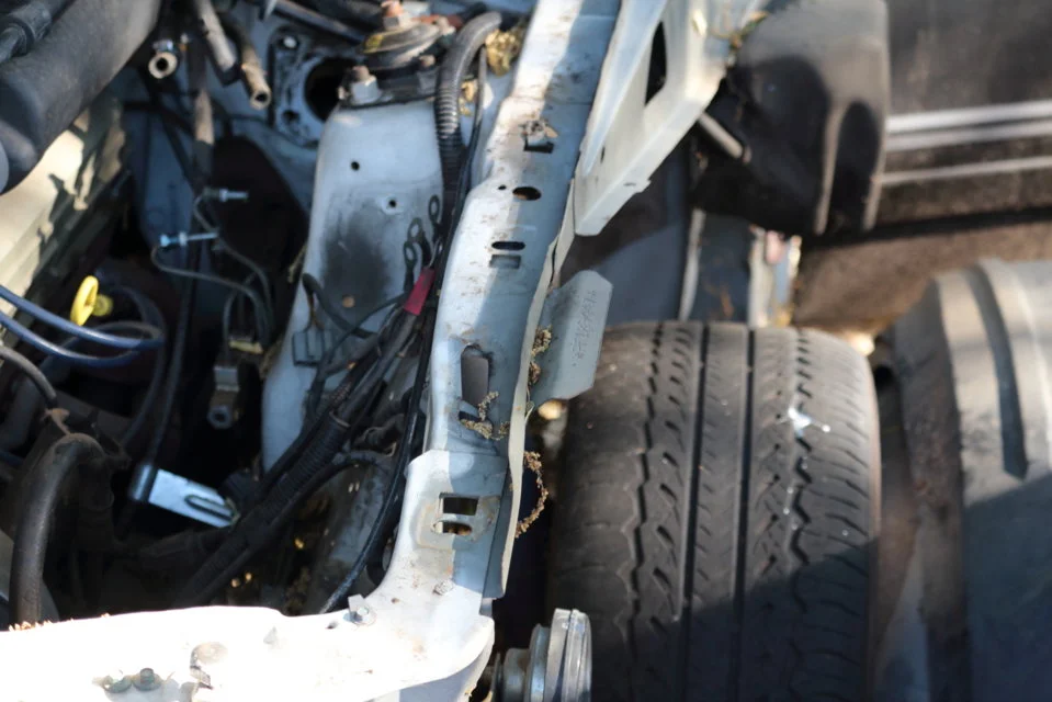

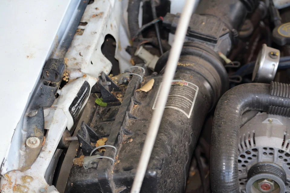

Here are some pics if you want to check it out.

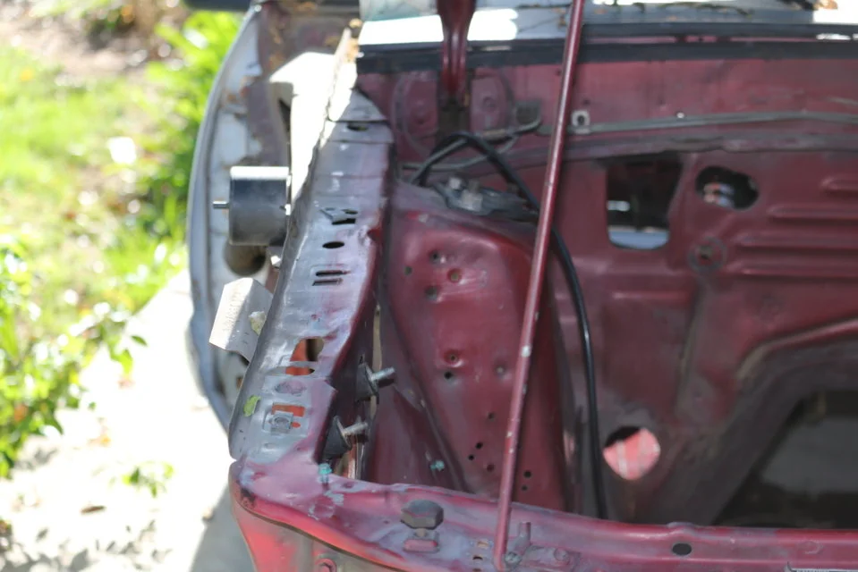

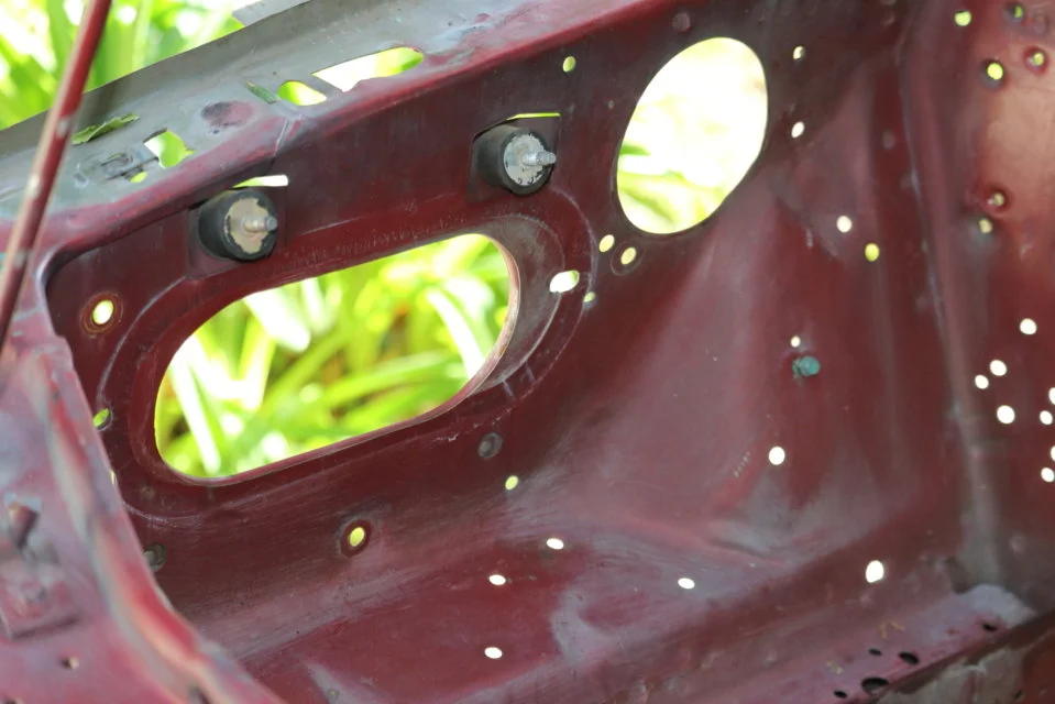

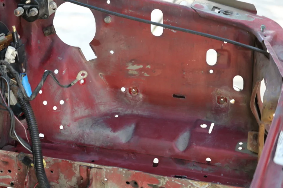

The biggest giveaway of a front end impact is the cutouts for the airbox and the ones next to the battery tray on the opposite side. The cutouts should be perfectly flat. If it took a good hit to the front they get twisted.
The red car is pretty good. White car stuffed a ditch at 30 mph. Look around the airbox on the white car.
