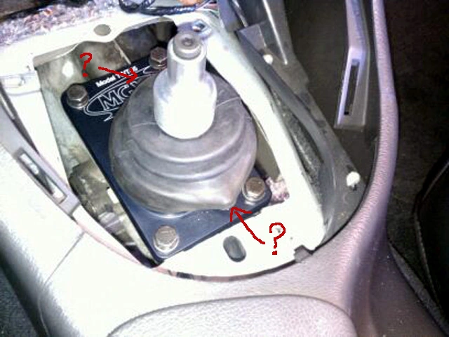

Does the inner rubber boot go over the Shift Stops like shown in this pic?
- If so, won't this disrupt the seal and damage the rubber eventually?
- If not, then how should the rubber be after the stops are installed?
Thanks.
Thats the grommet that seals the factory boot to the MGW shaft I thinks more for noise suppression than anythig else . I don't think would hurt to leave it out if you need to drive it . I would call MGW and see if they would send me one though.
You don't really need that grommet. I didn't use mine.
They must have changed the design of those boots. I got mine about 4 years ago and it has a hole on each side for the stop bolt to go through.
Also, if you have a t3650, alot of people do not use the stops. It is said the 3650 has its own internal stops. I like to err on the side of caution so I used mine also, lol!
