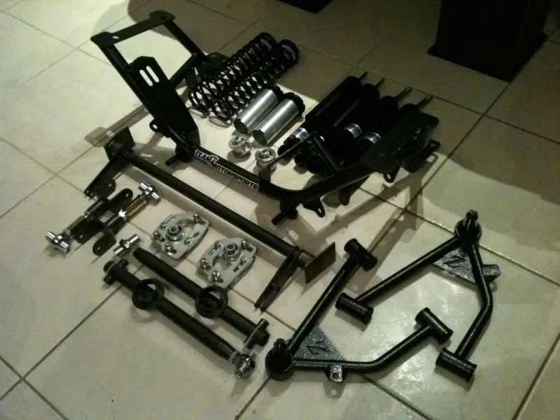

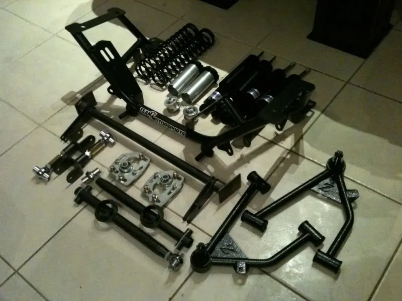

Send an email to Dave Z @ TeamZ Suspension. They make an incredible product at affordable prices. I was going MM too but this is going on the 92 instead. Dave has answered all our questions, was on the phone an hour about suspension geometry. Customer service is above and beyond.
