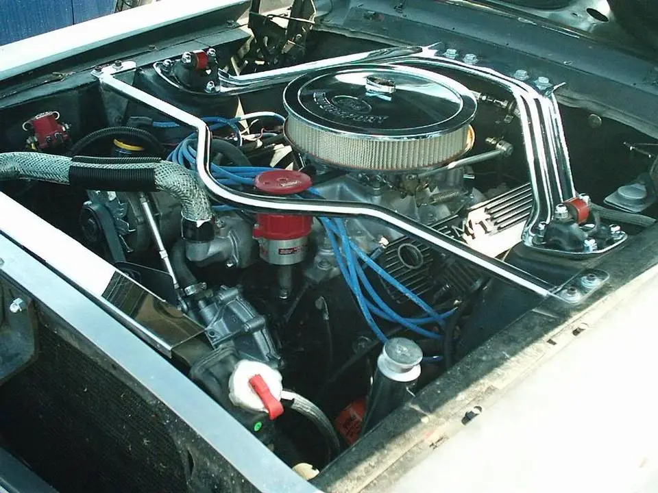

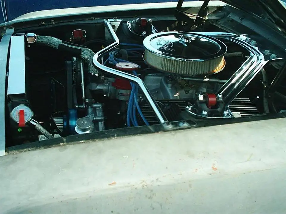

  • Jan 9, 2010
I'm using a 3 row Fox body Mustang radiator in my 68 Coupe and it works great. I didn't modify my support in any way, just made some brackets for it. My battery is in the trunk, and I believe that is necessary for that radiator to be there. I don't have a shroud, and even here in 100 degree TX summers I've never seen it over 190.
It is the perfect size though, as the actual core size is exactly the same width as the opening in the support, so ALL air that goes through the support hits the radiator. If you have a trunk mounted battery you should definitely look into this.
Plus I can always stop at any parts store and pick one up if I have to.
Here's a couple of engine bay pics so you can see how it fits.
