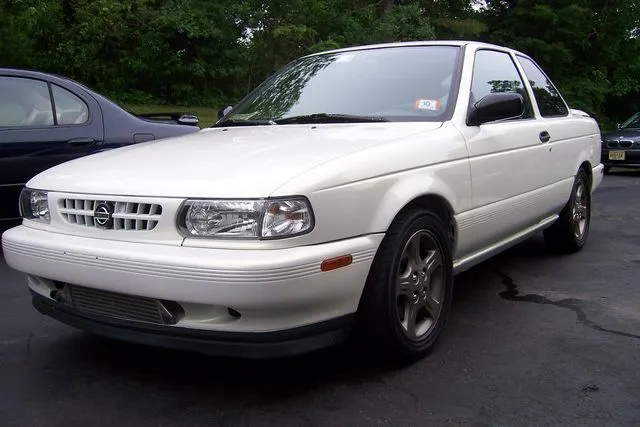

Nice looking SE-R! A definate sleeper :nice: .

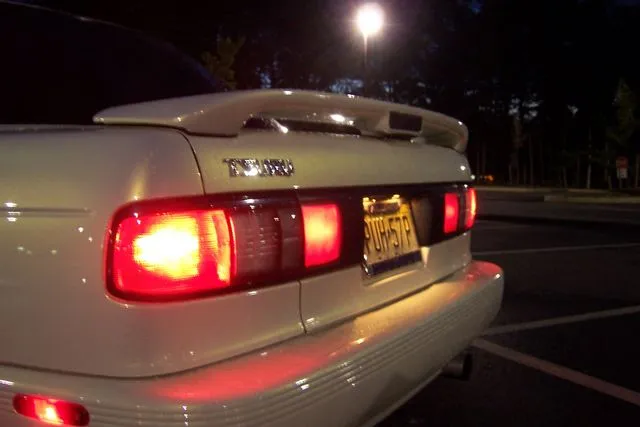

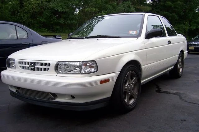

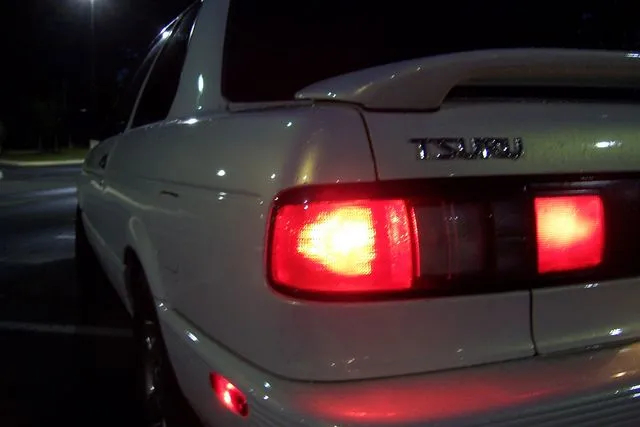

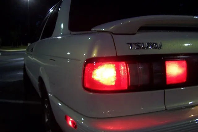

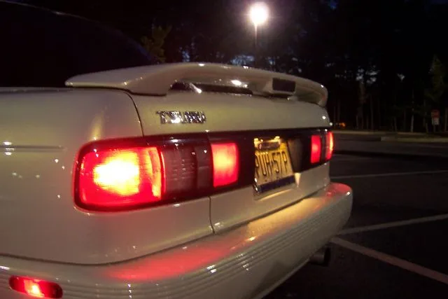

Thank you kindly. Its fun messing around with the big boys and seeing them scratch their heads when they can't beat the snot out of an old economy car. Some people take it in stride, others are dicks and give me the finger. :shrug:
And here are a few more shots....
Unfortunately, no money shot under the hood. It's too dirty to take a picture of it in there since I drive it 25,000+ miles a year :shock:
