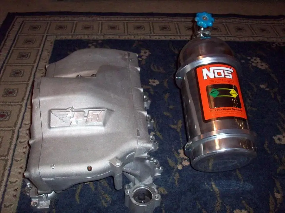

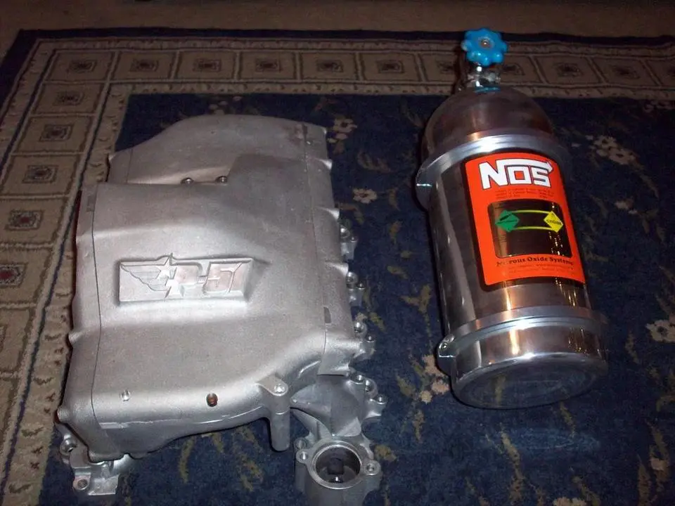

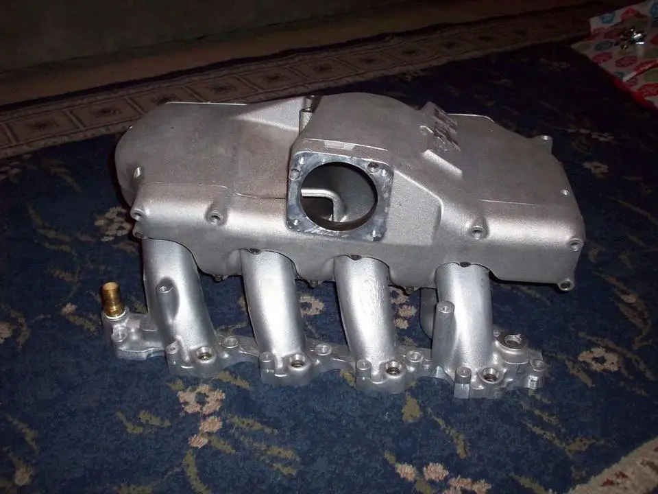

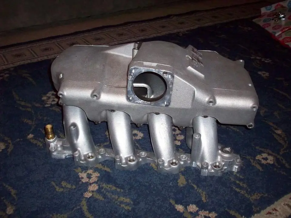

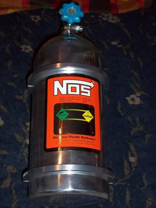

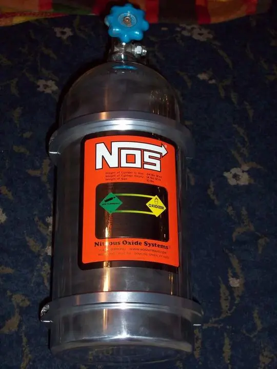

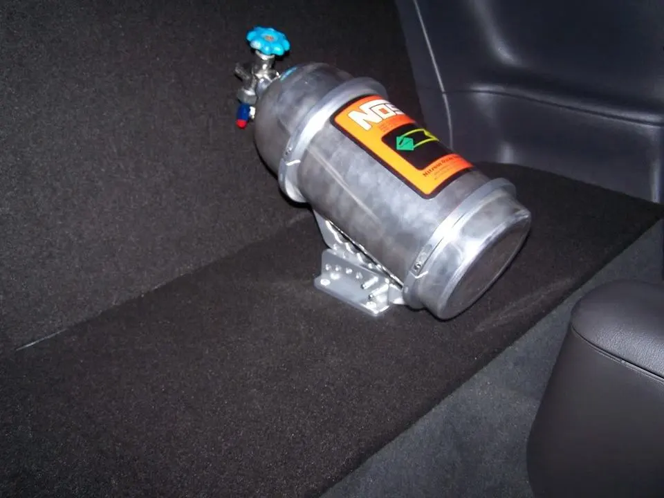

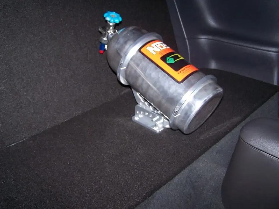

:eek: N20 as well! Man your not holding back are you :lol: .

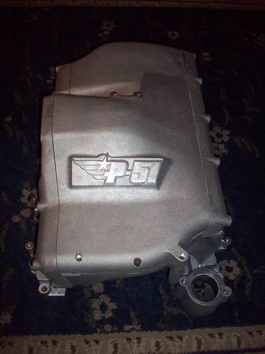

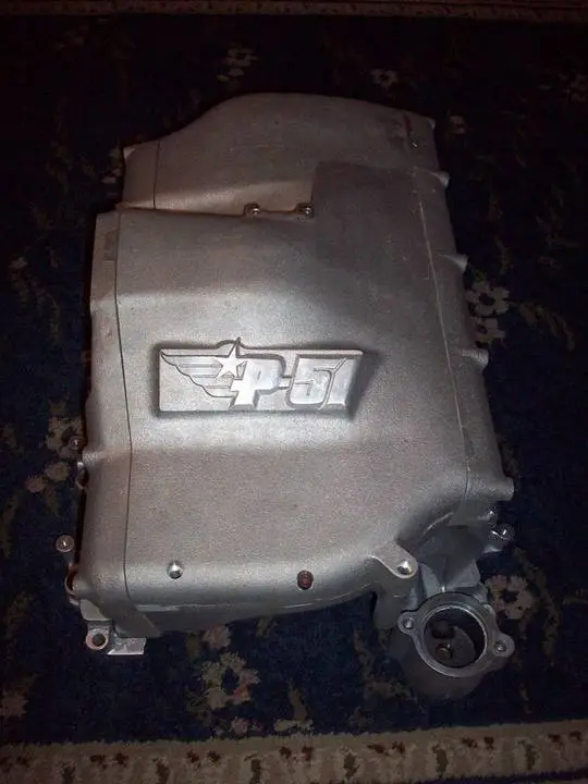

P-51 looks sick as well :drool: . But they are a bit too big for my tastes.
Have you weighed it yet? Im curious how heavy they are.
i'm still debating on what the nitrous will be doing. i have an intercooler spray bar but i'm currently thinking about trying to hide a nozzle somewhere in the piping and doing a 100 wet shot as an alternative. it all really depends on how far the fuel system will hold out. i'm still trying to figure out how i can switch between the intercooler sprayer and a wet shot. i know i will have to get some type of y splitter and somehow block off one side so the nozzle and intercooler arent sprayed at the same time
the intake weighs in at 42lbs
:eek: Man holy smokes! That bad boy is heavy....but its about the only intake that actually does anything, so I guess there has to be a trade off somewhere. :shrug:
Switching between IC sprayer and 100 shot will be tricky. You will need to be able to disarm the N20 100 shot switch so it doesnt spray in fuel. The easiest thing to do is buy another bottle and run 2 seperate lines with 2 seperate arming switches. the IC spray should be based off of boost pressure when the system is armed and the 100 shot should be WOT based when armed.
Unless you can rig up a Y valve with 2 N20 remote bottle openers (more expencive than another bottle) I dont see it being made into an easy to use system.
Good luck and keep us updated! I like seeing new parts....even if they arent mine :(
the 100 shot is just an idea right now. the car will most likely make more power than what i can use anyways.
i just want to make sure i break 600rwhp!!!! i really dont think it will be an issue with everything that is going into the new engine. i know i REALLY miss driving my car. i have only driven it twice since July!:(
